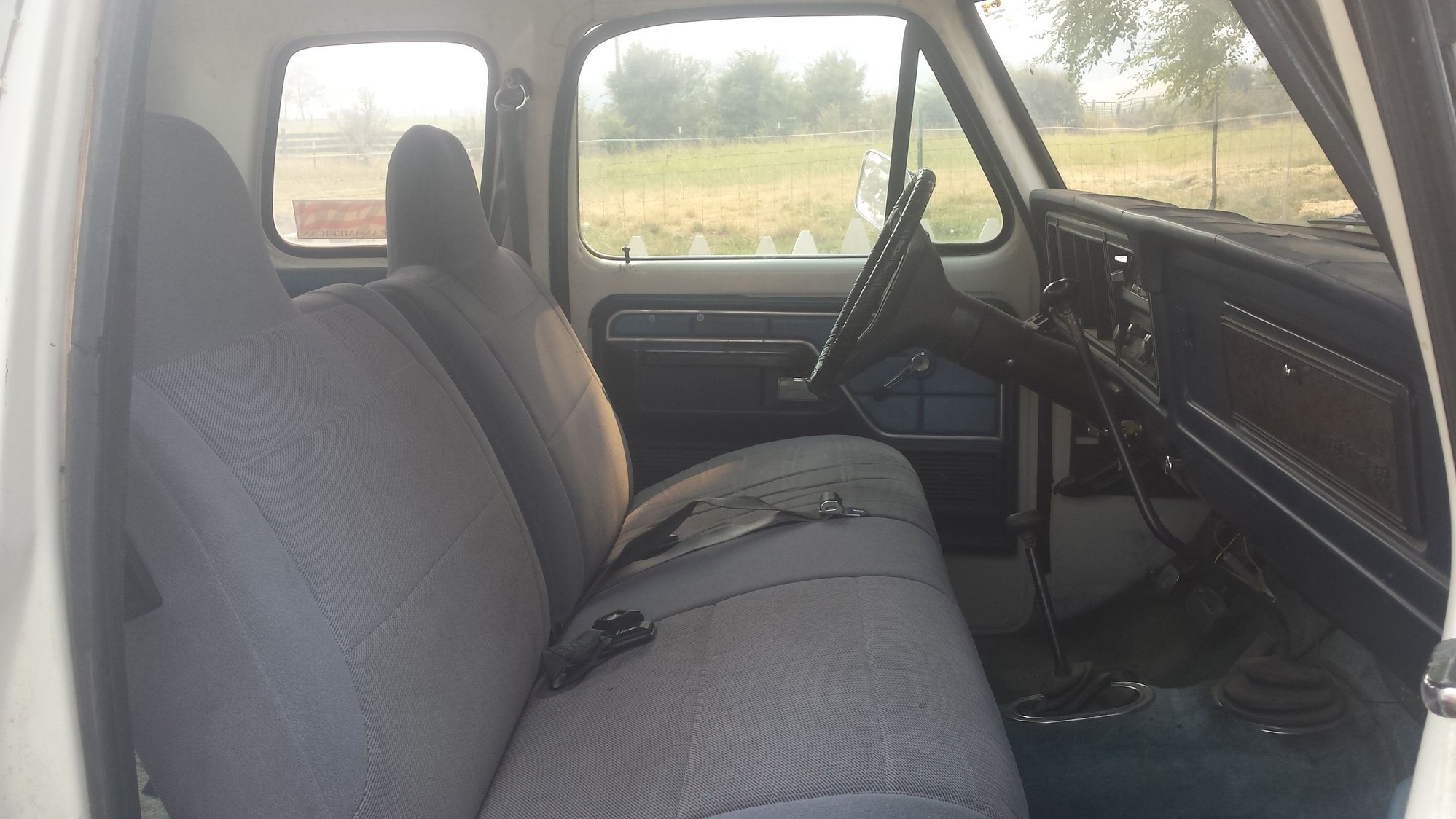

I just got a SC myself and learning. I read somewhere that a seat up to 94 will interchange if I remember correctly. Looks like a nice project coming up. Welcome to FTE>

I put in a split bench from a 96 in there. Bolts right up to your existing rails. Way more comfortable as well

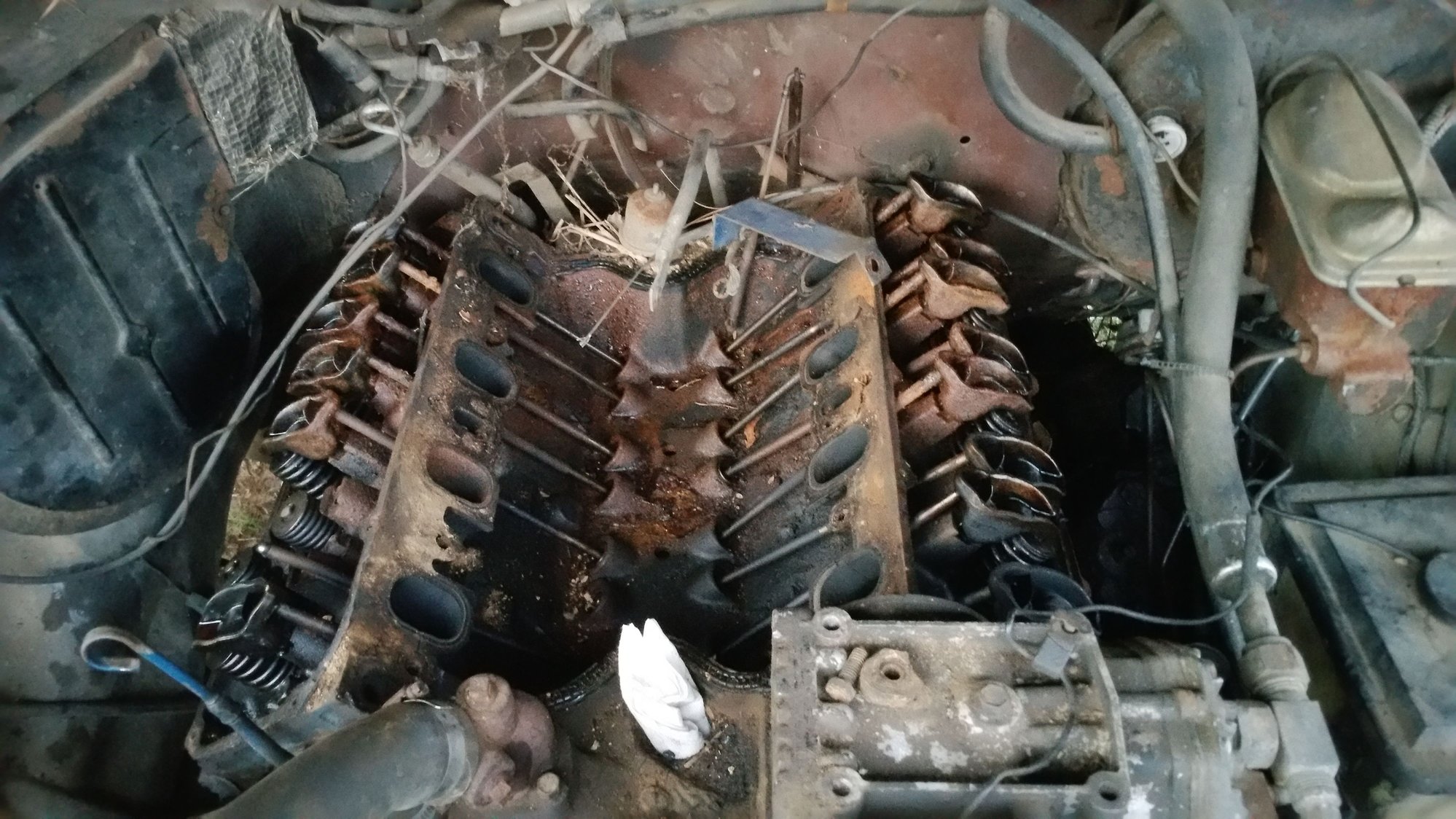

I've had some time to spend with the truck. I rebuilt the carb, and replaced the fuel pump. The truck fired right up but had a terrible lifter tap, or so I thought. I got a short video of it:
I pulled the valve cover on the passenger side and found the rocker arms closer to the breather rusty. I found the push rod on the number one exhaust valve bent. The valve was stuck up, I'm trying to get it loose.

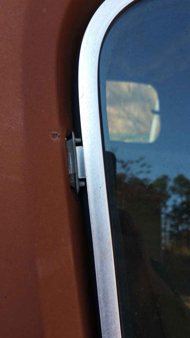

The body has a few spots I'm concerned with including the floor pans. Both supercab windows are sagging in the hinges

My 351m kept bending pushrods like that. Turned out the valves were so gummed-up with varnish they were getting stuck.
Check the stems and seals the best you can. Might be time to rebuild the heads
4) D5FZ-73302A12-A .. Plastic Retainer-Quarter Window Hinge / Obsolete
1975/79 F100/350 Super Cab / 1975/80 Pinto/Bobcat Station Wagon.
CARPENTER NOS OBSOLETE PARTS in Concord NC has 1,239 = 800-476-9653

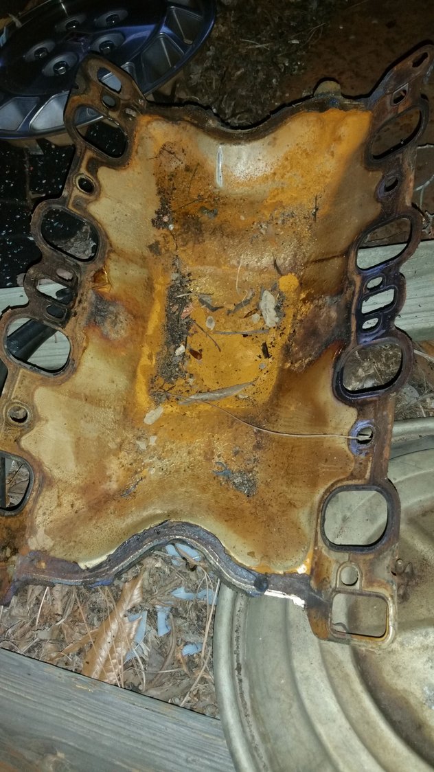

I got some time to get back to the truck after the holidays and a cruise earlier this month. I tried to spray the valve down with pb blaster and tap it loose almost daily for 2 weeks to no avail. I decided I'm going to pull the heads and clean all the valves up. This gives me the perfect opportunity to check the pistons and cylinder walls over. I'm planning on replaceing the lifters, push rods, and valve seals. I'm unfamiliar with these engines, is it normal for the intake gasket to be rusted or did it have a leak?
EDIT: I didn't notice until I posted it here, but it looks like the middle water jackets were leaking on both sides.

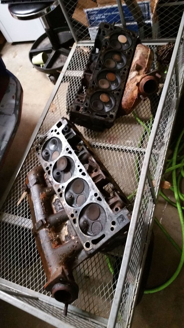

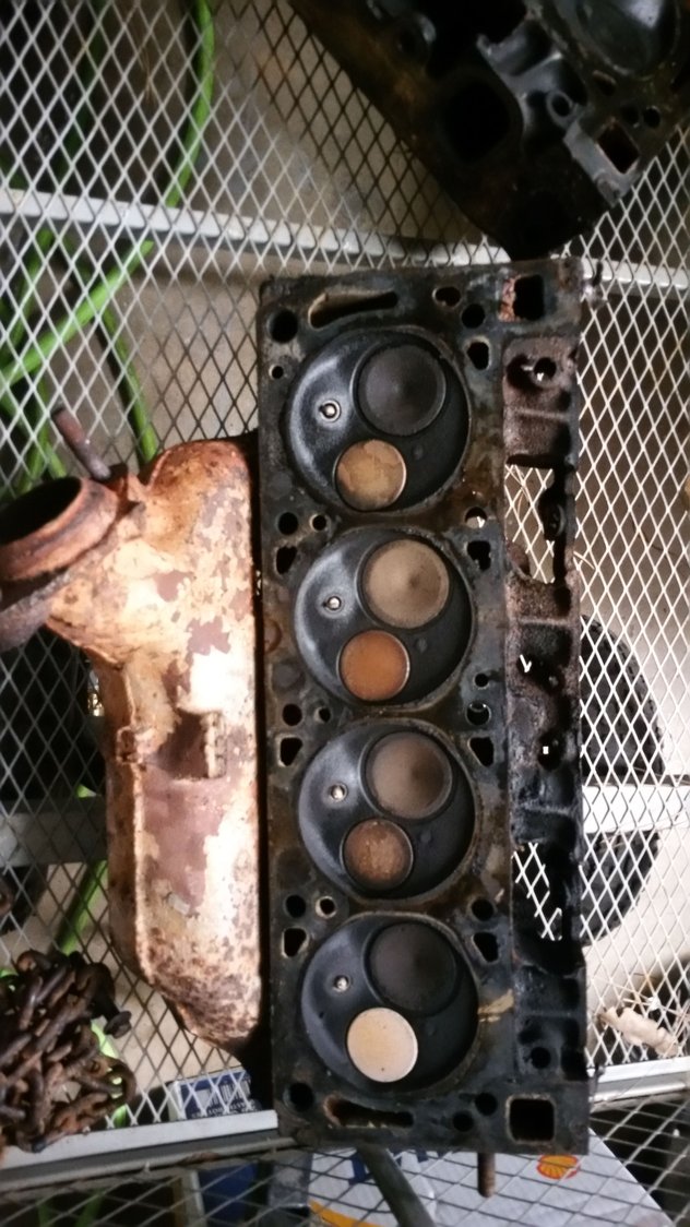

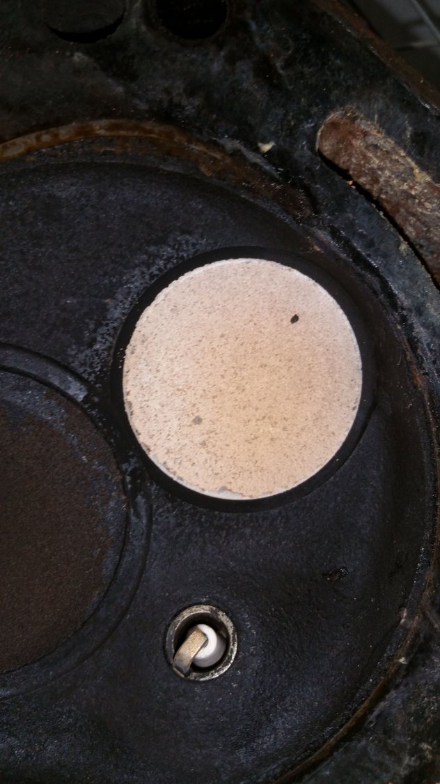

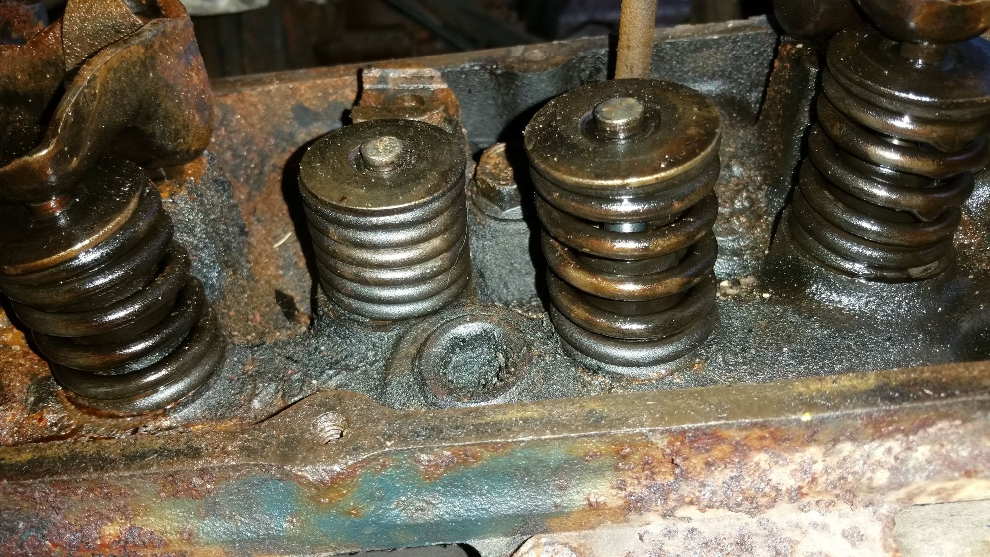

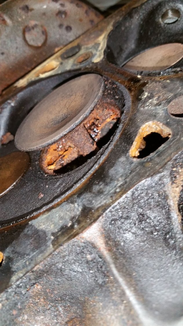

I managed to man handle the heads off the engine. The cylinder walls all have cross hatch on them. I'm pretty concerned about the valves looking burnt. The stuck open valve doesn't look so great looking down the runner.
drivers side:
passenger side:
stuck valve:
close up of the most concerning valve:

Looks like the valve seat is wasted. Any decent machine shop should be able to make short work of rebuilding your cylinder heads. Make certain to have them magnafluxed to text for cracks.

I was able to use my heads. I can't remeber how much it cost me but they got shaved, 3 new valves, 1 guide, 16 valve stems, 16 push rods, 16 lifters, new head gaskets, new valley pan gasket, and new valve cover gaskets.

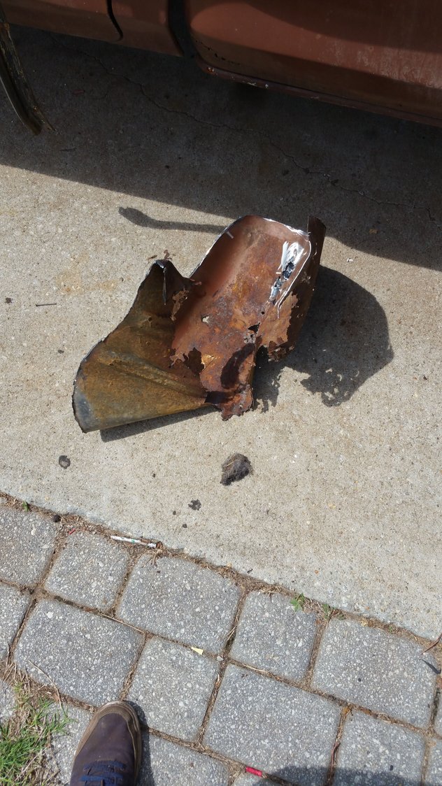

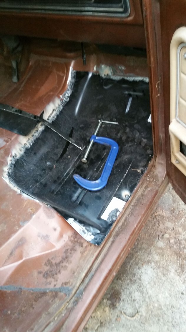

I wanted to start the floor pans a few weeks ago but got busy. I started Sunday morning but the water heater went out so I didn't get as far as I hoped. I have another busy weekend ahead but, I'm going to try and at least finish the passenger side this weekend.
Spent a lot of time trimming the floor to make the new pan fit well. Ignore my ugly welds, thankfully I have a good number of grinding discs.

"Igore my ugly welds, thankfully I have a good number of grinding discs."
Hey. Those are YOUR welds........... and they'll be under the carpet. So you can't go wrong
Great place to practice/get started.
