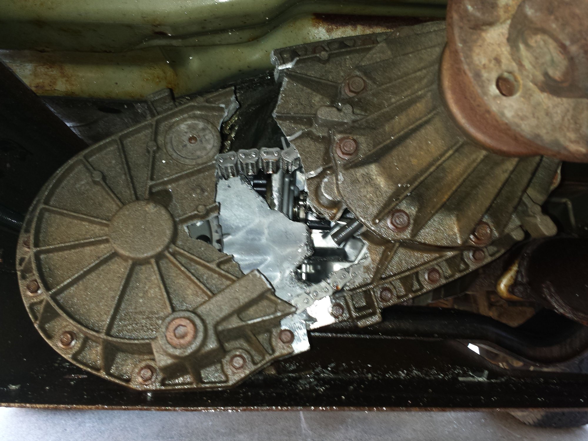

Old Jan 2, 2017 | 11:12 AM
F33lmywrath's Avatar
F33lmywrath
Joined: Mar 2016
Posts: 71
Transfer case issue?
Old Jan 3, 2017 | 01:43 AM
tug3's Avatar
tug3
Joined: Oct 2016
Posts: 27
From: Southern Finland
She'll be orrite, just change the fluid and have a
But yes, that looks familiar. My previous xfer case that I fixed had similar issue. (A NP271 under a Jeep.) The Jeep had had a close encouter with a Toyota. It got hit to the left front wheel. The hit was hard enough that it bent the front axel back and the front drive shaft pushed the xfer case in half...
This time my Ford's NP273 looked just fine, but when I opened it up it was "a bit" messy inside. Oil pump was toast and that destroyed pretty much all the bearings... ...also some of the plastic inside had melted.
Old Jan 3, 2017 | 01:55 AM
87crewdually's Avatar
87crewdually
Joined: Dec 2006
Posts: 6,496
Likes: 94
From: So. Jersey
Transfer case issue
That's what happens when it's left in 4x4 on black top. That's what this customer did on his Excursion. The phone call I got was "I think I have a leak." He was right.
If you don't think you did, check the motor. It may of failed in 4x4.
