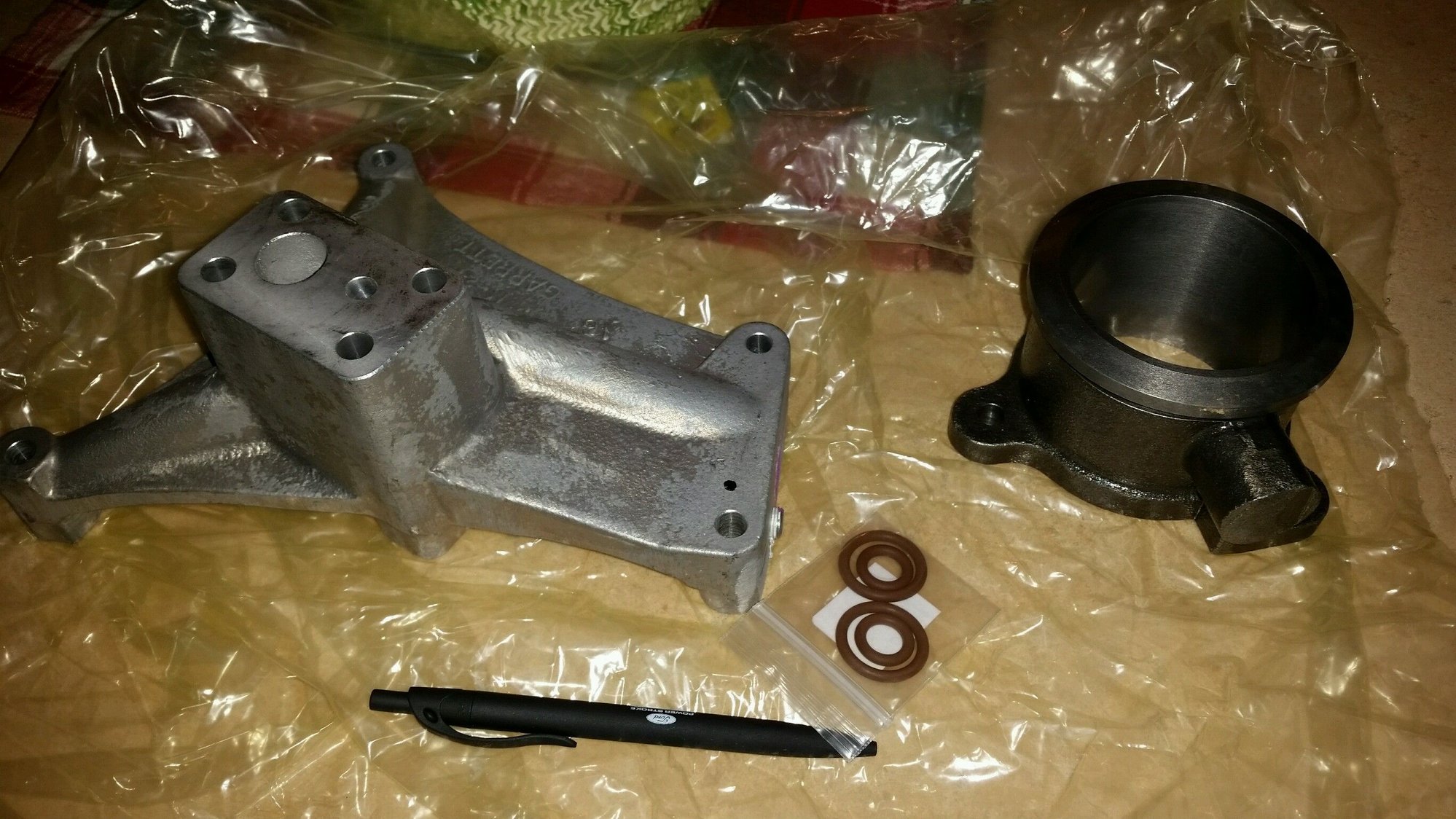

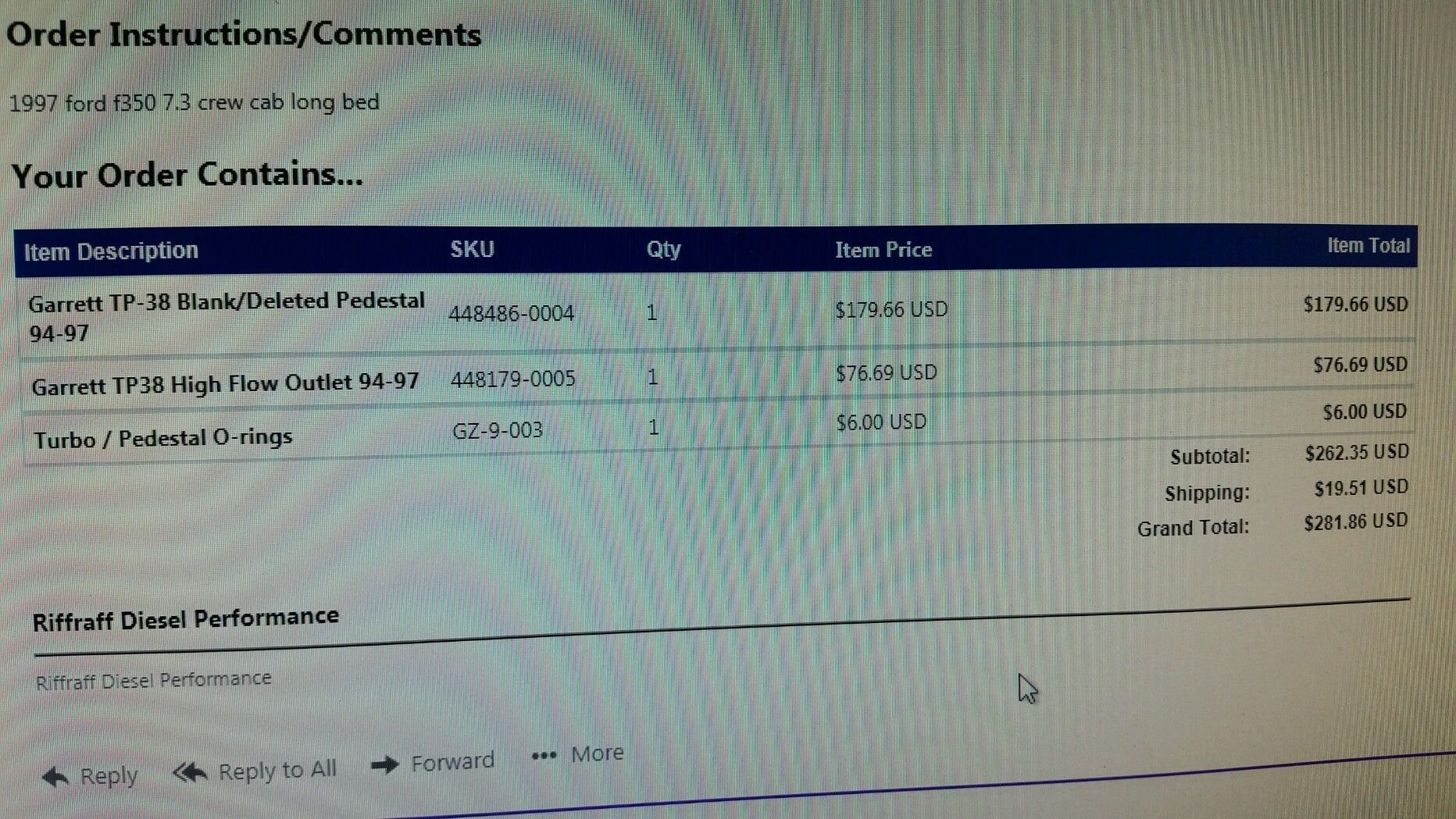

My EBPV blank pedestal, high flow, orings just arrived yesterday

The rod has a steady flow of oil leaking out so I decided to do the delete and never have to worry about it again. Its been a bit of a project to tear apart tho!
