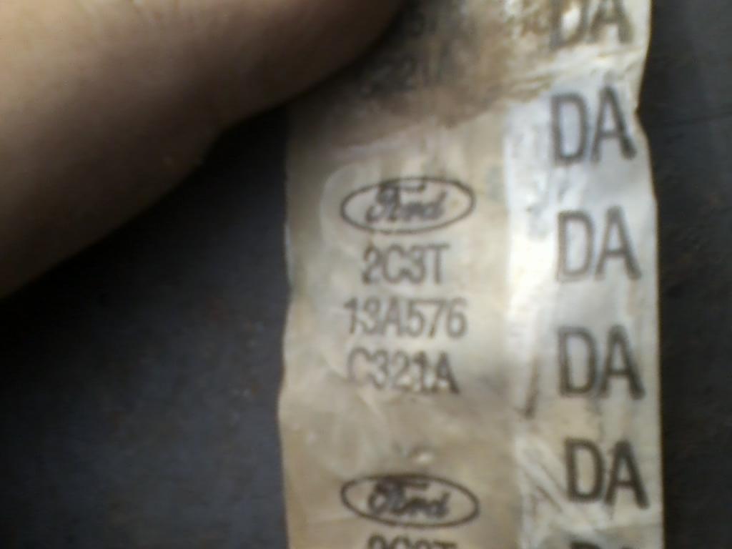

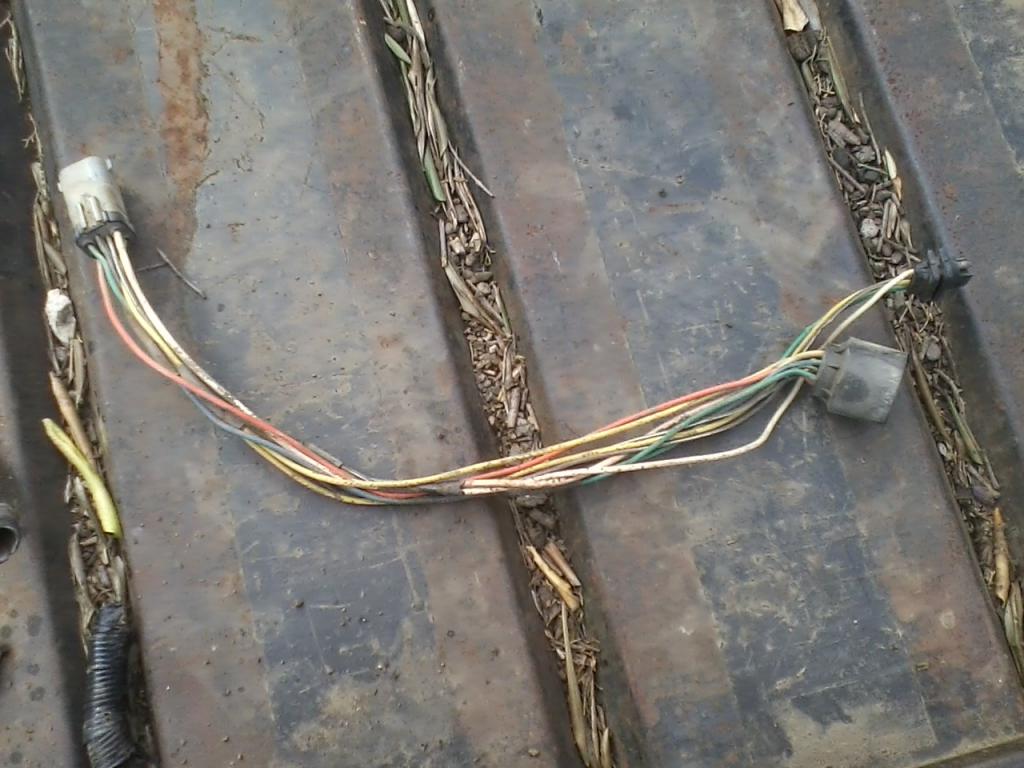

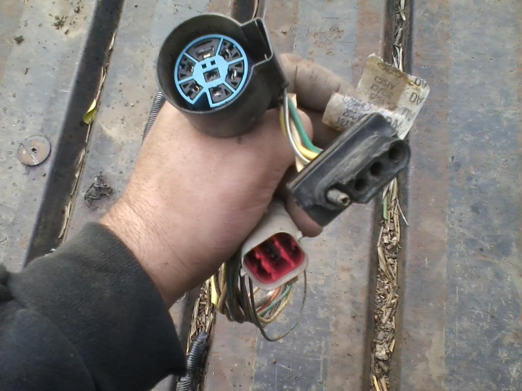

so long as the rectangle plug like on the linked harness is still there under the truck and not messed up, order that harness from etrailer plugger in and git on down the road.
heres what the stock harness looks like on a 2003

That will work but like Justin showed the factory will pigtail a flat 4 in the harness. If you don't need a flat 4 no problem or you can add you own to the plug you listed.
My '02 has the same set up Justin pictured.

Once you get some wiring that ends in the round plug like what OldBlackCat posted, I'd order this from Amazon (or pick one up local if you can't wait):
Hopkins 40975 plug
I bought the hitch from an '08 that had that style plug but I backed in to something and busted the plastic covers off, and I like them being somewhat protected from the weather. The big advantage is that you have BOTH a 4-pin and a 7-pin right there. Zero adapters needed unless you have something that is 6-pin...
