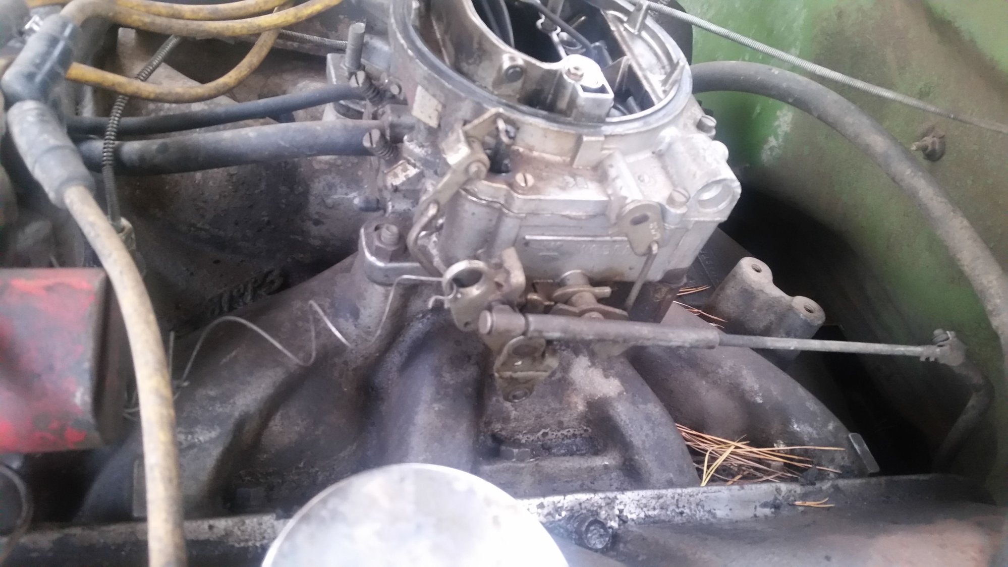

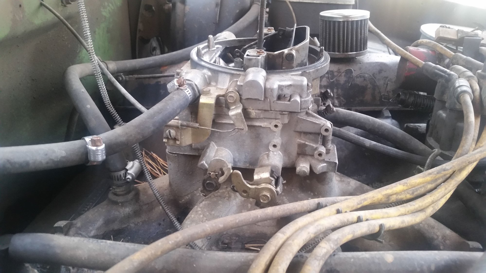

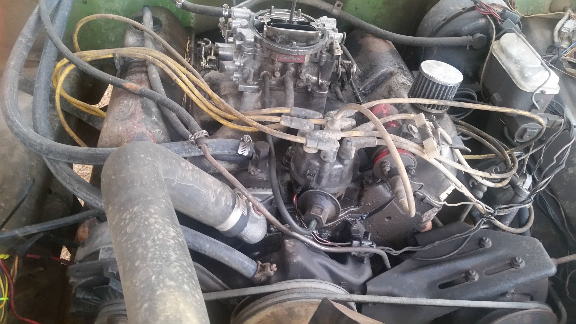

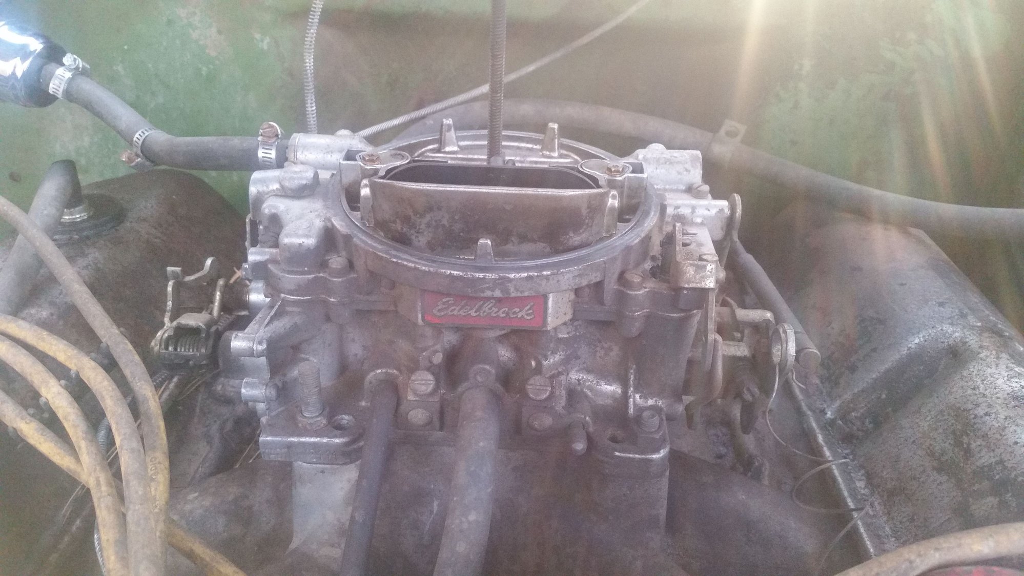

Like I said, I'm gas stupid. Here's some pictures to go off of... Maybe y'all can tell from them.

If it was a holley I would be of more use, but I've never run an edelbrock before, so in general, make sure all vac lines are good. If you have an auto I believe there is a vacuum solenoid that goes to the trans that is known for going bad. Check the base timing. Make sure all your plugs are in good shape as well as wires cap and rotor.
Just eliminate all the basics before tearing into anything basically.
Edit: noticed you said it sat for a little while, so it just might be time to rebuild the carb, but before doing that, you should definitely make sure the timing is correct and try to get the carb dialed in with a vacuum gauge.

I started looking at some of the vac lines and they're starting to dry rot. I bet that's the problem, or at least one of the problems. I'll start there and work my way down the list. Thanks for the responses!

Your throttle return "spring" scares the crap out of me to the point I would not drive that thing even one block. I would not trust that thing to return the throttle and you may find yourself stuck at wide open throttle at a moments notice and the only way to stop that is to immediately shut the ignition off or somehow pull the gas pedal off the floor. There are many ways a more proper setup with an actual real spring can be installed.
Like krazyness I am only familiar with Holleys, but if you never had these issues with the truck before then I would suspect something like a vacuum hose is cracked or something minor in that regards. Not sure if Edelbrocks have accelerator pumps to assist the engine from getting from partial throttle to hard throttle without a stumble. The rubber diaphragms in these can crack on Holleys.

Yeah, I thought the spring looked sketchy but that's how the po had it, and I haven't had any problems. I'll get a new one tomorrow on my way to work.
