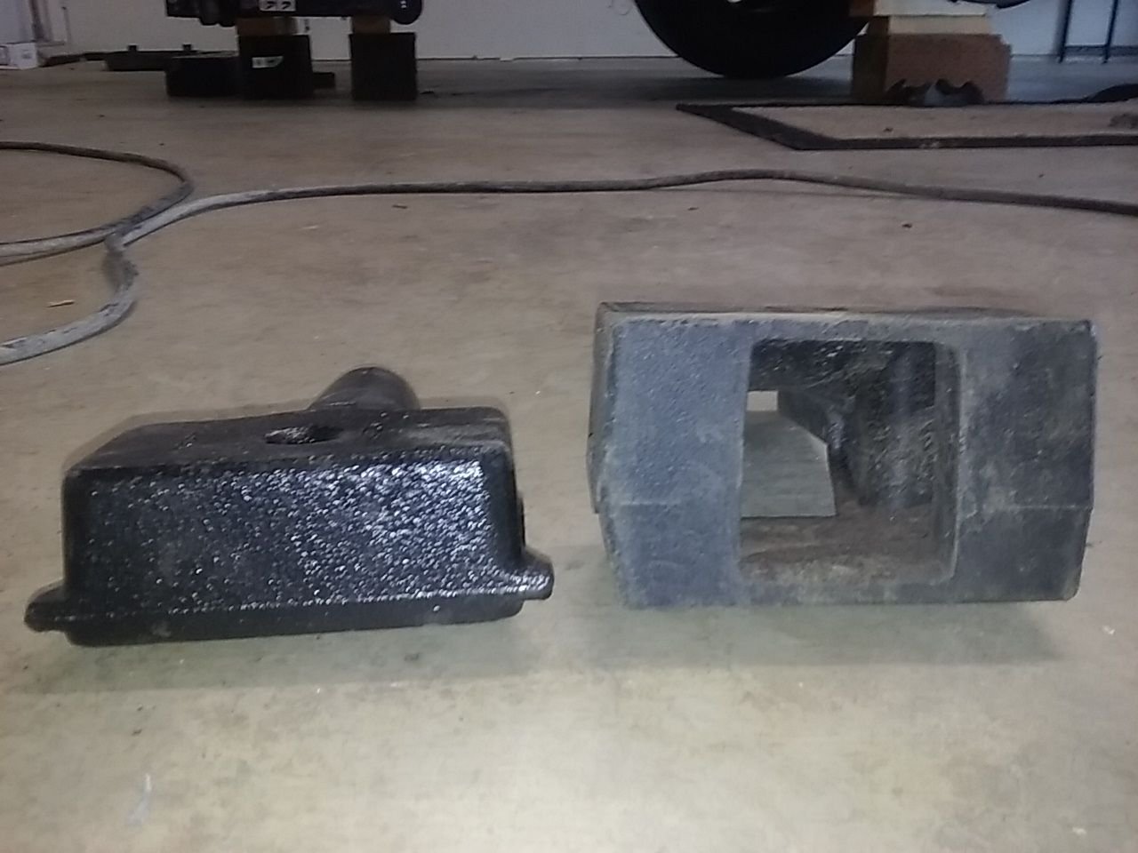

1-1/4" drop completed this afternoon, I measured before and after . Went well, pretty easy. The new blocks were 1-7/8" flat, the factory blocks were 3-1/8" on one side, 3-1/4" on the other. I am happy with the look, I still have over a 2" rake. I think this new block might be enough drop to satisfy me. The new block was the part number out of a 2016 F250 CCSB, and the CCLB was the same number too.

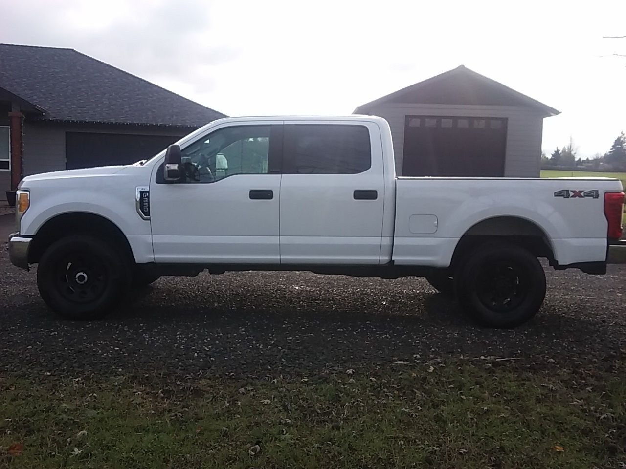

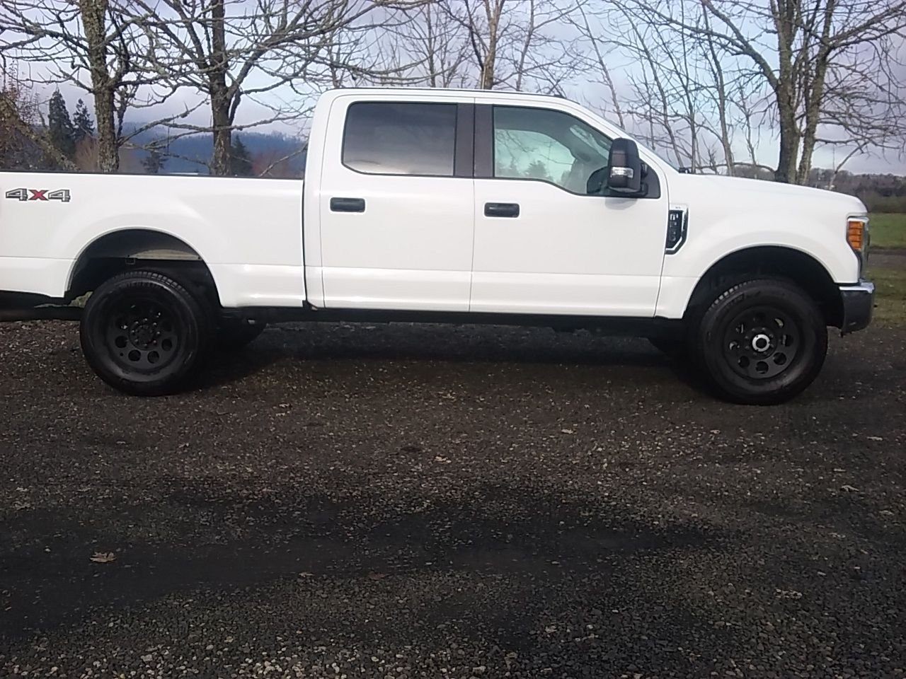

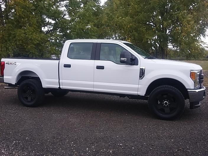

Originally Posted by nb443
Have any pics of before and after the install?
Thanks
Before:
The rear did drop 1-1/4".
After:
