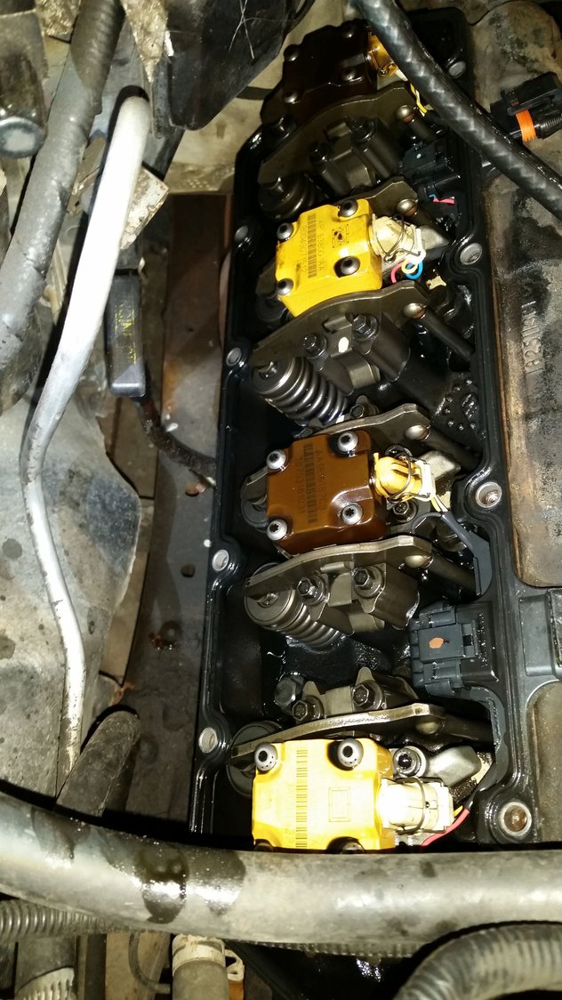

Passenger side has 2 yellow boxes. Drivers side had 1. Is this normal? What does it mean?

If you are talking about the different colors of the injectors, the 2 bright yellow injectors are probably new/been replaced.

Thats what we were thinking but weren't for sure. so the brown ones are probably stock then? is there a way to be certain?

only way to be certain if they are good is to have them bench flow tested
A contribution test can also help rule out a weak one
some injectors can go 300k+ miles with out issue or get weak soon as 100k depending on maintenance
Brown means the coil has been in oil longer and they coil only might have been replaced

The numbers on the brown ones are....AA1816187C3/18703181031. My Google search showed that the brown ones are OEM injectors. The yellow ones...Alliant Power AP63800AA/80040071512 are new injectors. As soon as we get our newest problem fixed (oil leak at turbo pedestal and/or EBPV) then I am taking it to a different mechanic that swears to me he can do the tests that you (knottyrope) stated. I have done my research and I am switching to a new mechanic. My husband and I changed the glow plugs, valve cover gaskets and the under valve cover harnesses (all 4) this weekend hoping that was going to fix the stalling out, no power, hard start and engine miss....put everything back together and the only thing that seemed to change was it started better. Then we found the river of oil flowing out so now on to the next problem then we will move on to the injectors. Its been one thing after another with this truck

You can also watch the injectors while it idles with the valve covers off and see if they are all spouting oil. That will tell you if they are firing.

^^Yeah. And watch the base of the injector to see if there is oil coming from between the injector and the head, in which case you have a loose injector and/or blown o-rings.

And just to be clear, I am talking about the spout and Jared is talking about the base. Coming out of the spout is good, coming from the base is not good.

fwiw, You can do a contribution test and injector buzz test using bluetooth dongle and CarGaugePro app and/or Forscan app.

Also if your considering running the motor with the valve covers removed I would suggest if you can get your hands on a set of used valve covers do it. You can cut out the centers then bolt them on so oil doesnt go all over creation. I usually put rags over the ones I'm not checking.. Food for thought..

I didn't have an issue when running at idle but after 1500 RPM it would spit oil out and about
Good to know; I'm only going on what I know from other motors. Havent had to run mine in that fashion yet..
