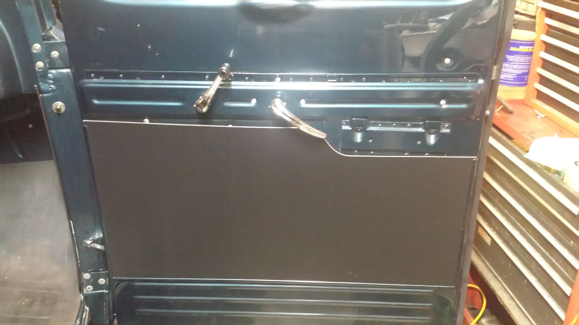

I purchased the black door panels for my 52 from Dennis C. They dont have any lacing stitched around the out side edge. Is this the way they where and do I just screw them to the door? Anyone got any pics?

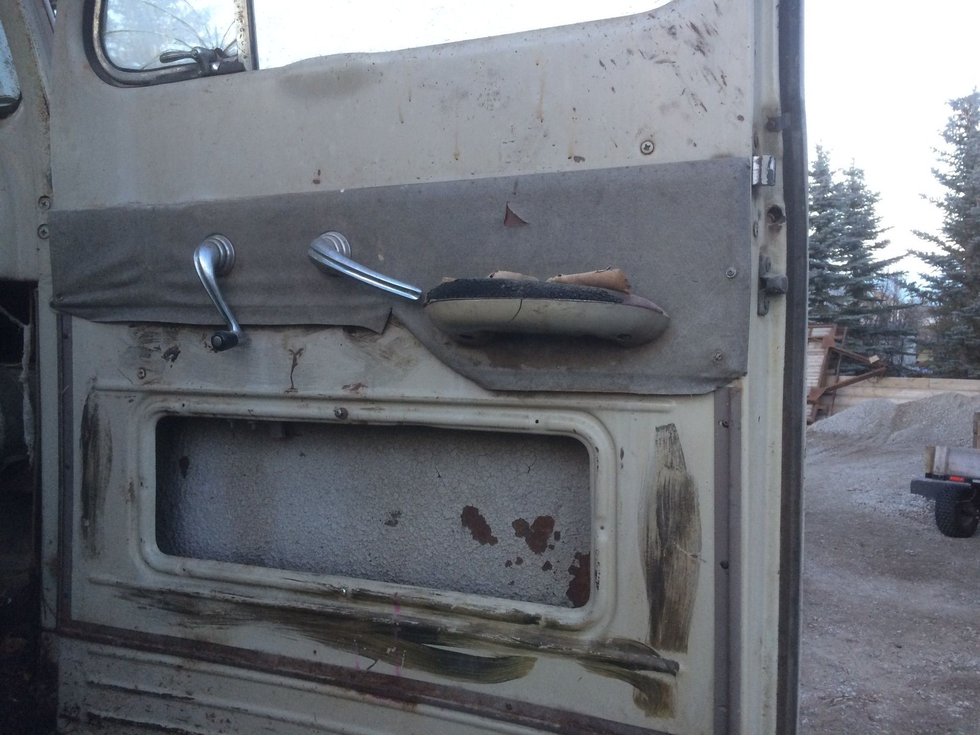

stroll down 9 threads to "barn find" and scroll thru the pictures and you will see what i was talking about.
Old Nov 23, 2016 | 06:42 PM
Muppy1840's Avatar
Muppy1840
Joined: Aug 2013
Posts: 649
Likes: 101
From: Calgary Alberta
This is what they look like. , Doug.

Thanks guys. I have had my truck 11 years now and been to tons of shows and on here all the time and have never seen them on a truck. I guess I would need to make the top piece. The track for the the bottom panel could maybe be wall tile edging. Have to pop into a store and have a look.

However, the barn find truck is a Mercury! I believe Mercs had more upgrades than our Fords.... So there may be a difference. Beware.

There is more to the upper panel as well. There is a lip to hang the panel on and a bracket to bolt the arm rest to. I suppose that if you didn't want the arm rest, you could fasten an upper panel with trim screws.
I bought and installed all of the parts off ebay to convert my truck to 5 star plus.
