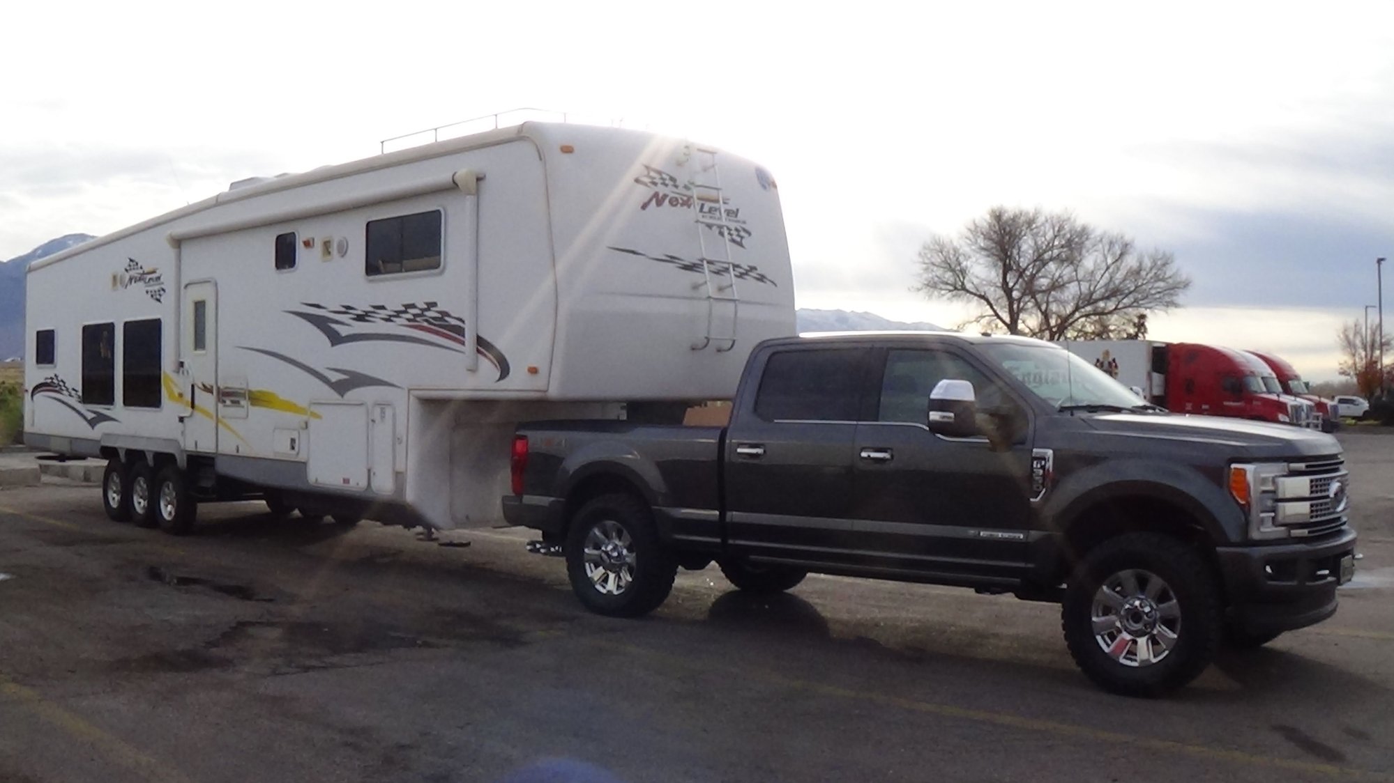

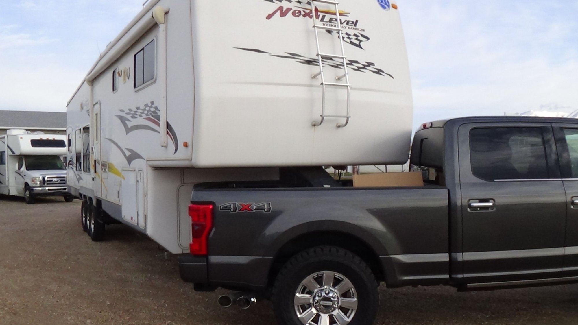

One of my biggest concerns was if my 5th wheel would ride level with the higher everything on the 2017. You can see from the picture that it fits fine. I have slightly more clearance between the bed rails and the overhang than before which means the new base is slightly higher than the old one. It's currently set in the middle position. I will have to watch the little lip on the back of the tailgate that pokes up an inch. That is where I had the biggest chance of contact on the previous truck. Going over a bump or into a wash is where the back of the tailgate would just about kiss the underside of the trailer cap before.

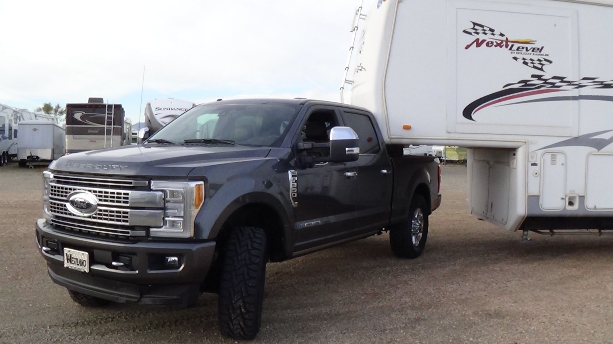

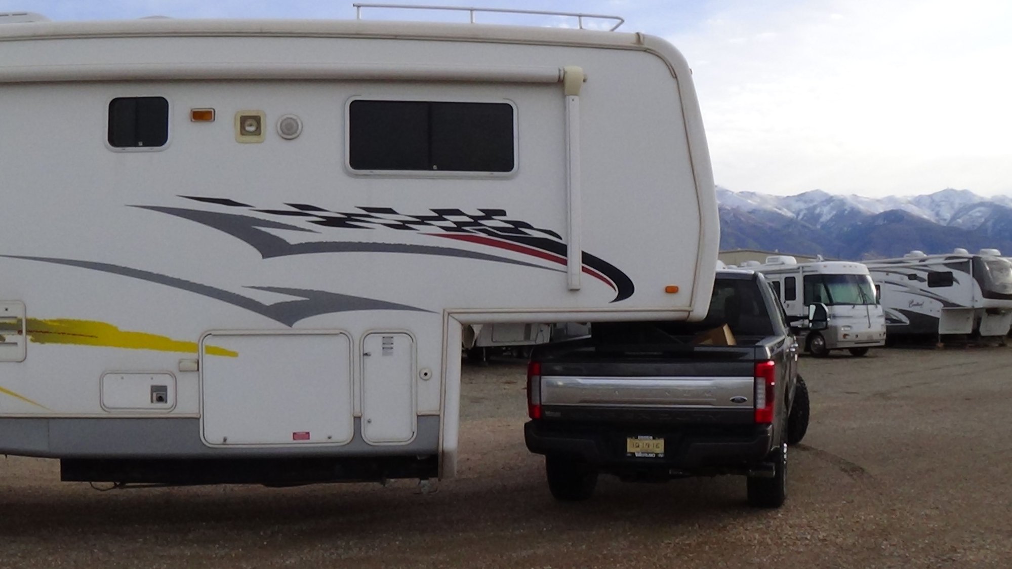

The new B&W hitch has brought the trailer forward a little bit. I cranked the truck over as far as I dared and even though that was an extreme angle that I don't think I ever get to in the wild it is closer to the cab. Fortunately I have some adjustment holes available on the trailer so I'll just extend the king pin forward. Should put me back to where I was.
The back end of the truck sags less than the 2011. With the 1.5 inch level on the front I could probably get away without airbags. I will probably install them on the truck just out of habit though. This truck handles the weight of the trailer much better than the 2011 without airbags. No bouncing, chucking or harshness. This same trip with the 2011 showed very clearly airbags were necessary, on the 2017, not so much. Very comfortable and stable.
The tailgate when down comes closer to the trailer. There was plenty of room for me before but now I have to squeeze between it and the trailer. One thing that is going to be a pain is that I can no longer lift up a front door panel on the trailer with the truck attached. We'll see if this is still the case when I adjust the trailer king pin box.

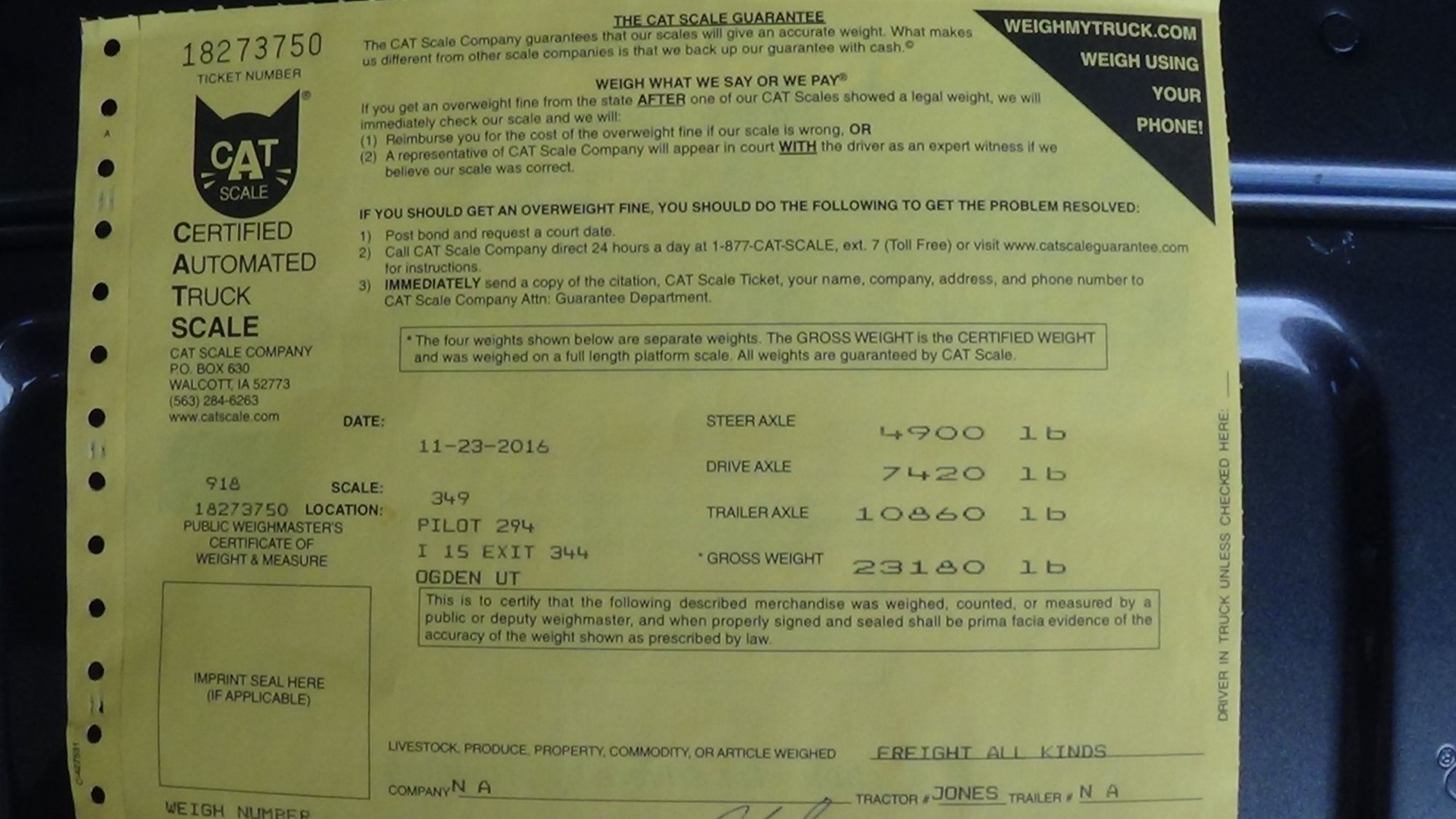

Weights are about what I expected. My trailer is heaviest on the pin when unloaded and overloads the rear axle by 190 lbs. As soon as I load it up it should take about 200 lbs off the pin which will finally let me just squeak inside the ratings. And it's true that the front of the truck starts out weighing significantly less than the 2011. I shouldn't have too much trouble with axle ratings when fully loaded up.

Looks good my friend! How much clearance do you have between the top of the bed rails and the camper?

8 inches on the side rails and 7 inches above the tailgate lip.

Perfect. Trailer looks close to level. Nice!!!

Trailer looks pretty level! Awesome looking truck. Next up could be one of those gray Fuzion toyhaulers to match. There's a place not too far from you that sells em!

Personally, I'd be concerned about being more than 800# over your payload rating. I'd be very concerned about being above the axle rating. It looks like you upgraded your tires, otherwise, you'd be over the 7280# OEM 18" tire ratings as well. Hopefully you don't need to add more passengers and cargo to your truck and the pin lightens a lot when your garage is full.

There's nothing new with the trailer. It's a known quantity. I pulled it 20,000 miles over all terrains, temperatures and elevations with the 2011. This truck is more capable in every category.

By the way, is that a non extended pinbox on your rig? Holy, and everyone thought I was a rebel not running a slider!

Interesting that it was the hitch height that I was all concerned about. Turns out that is absolutely no biggie. But the hitch position is more forward than the previous. First time I pulled out of storage and turned sharp onto the street I glanced back there and saw that big old trailer cap sooner than expected. It was like, "Well hello there... this is different." So yes, I want to get back that two inches of cab-to-cap clearance that I used to have. I was thinking I had an adjustment hole available on the box but now I'm not sure. Need to start looking into it. Are there extenders of some sort or do I just look for a longer king pin assembly that will mount into the existing box?

The truck is sitting with its nose in the air. I had no idea it would squat that bad under load.
Air bag time?
