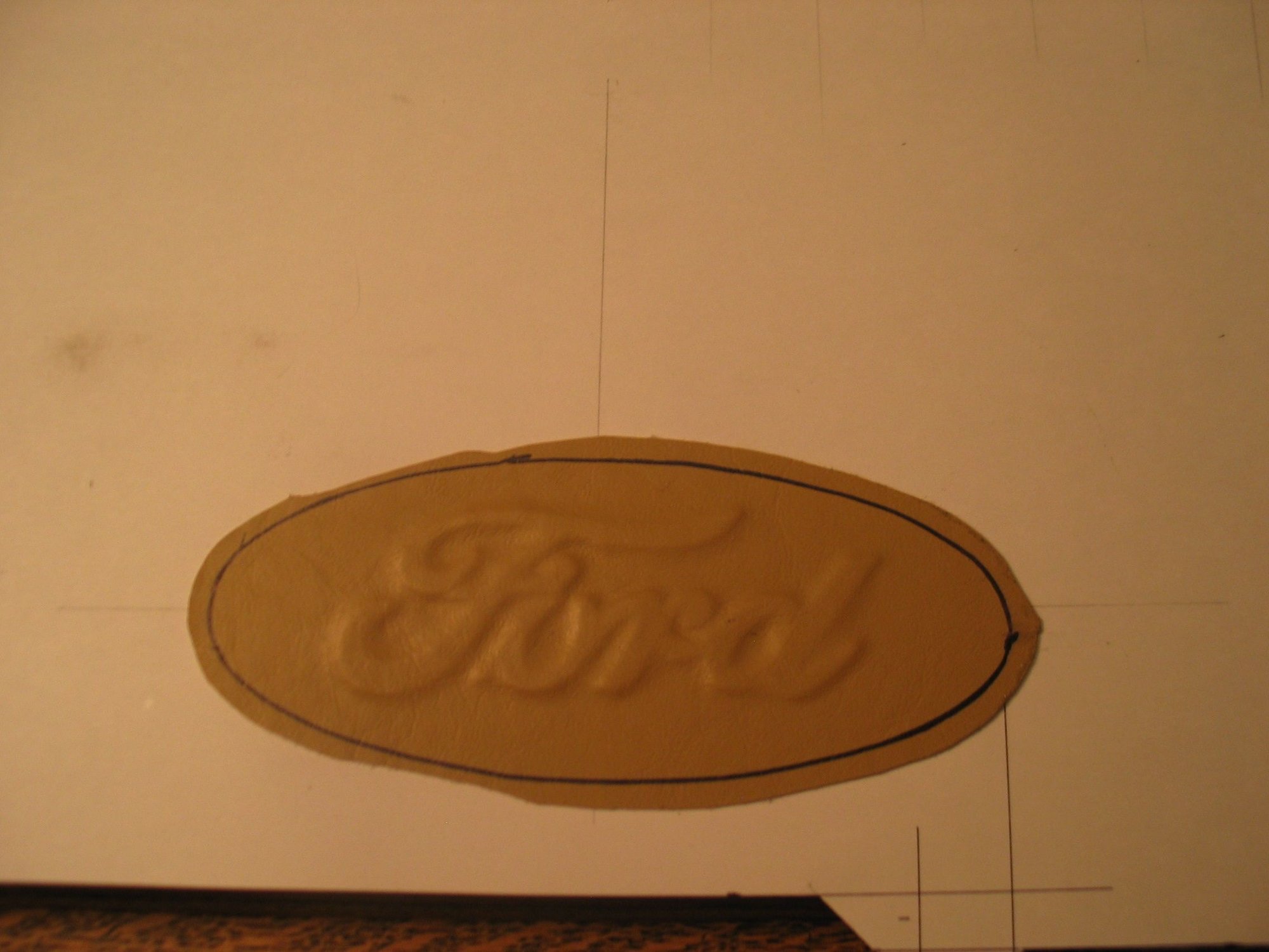

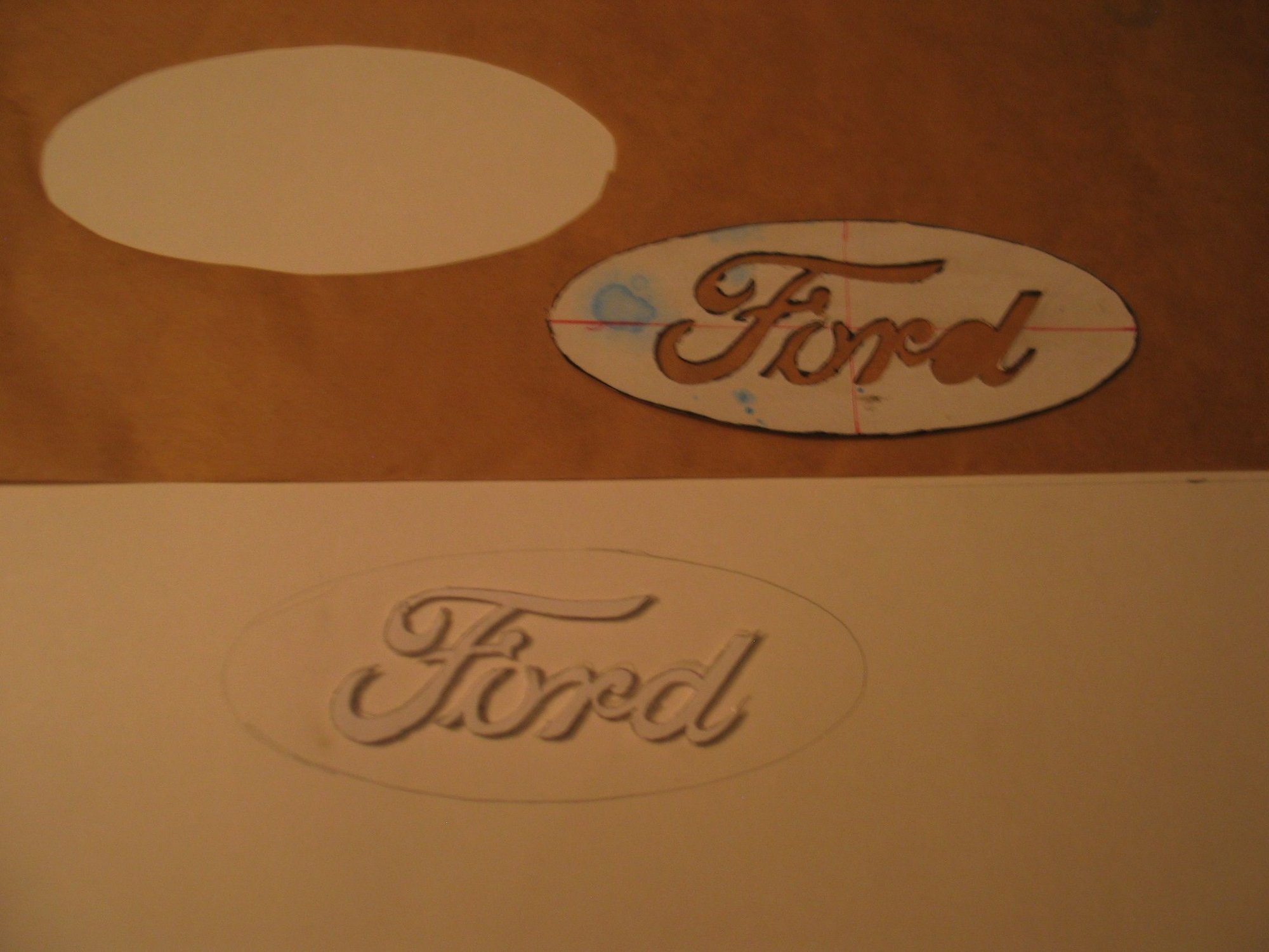

More test panels
I experimented with embossing the vinyl today, trying to get the Ford logo to have a bit of relief. To this end I cut out some stencils then glued vinyl over them; two panels with two different heights of foam board.
The thinner embossing seems the way to go.
It is difficult to keep "crisp" edges on the embossing, so I am going to try hand stitching around the logo. If this works, I will then cover around the logo with charcoal material and machine stitch the rest of the visor cover.

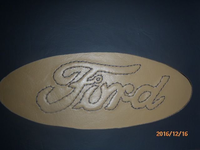

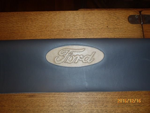

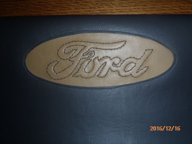

Hand stitching logo
I worked at hand stitching the logo while waiting for my sewing machine to be serviced. It is time consuming, and I died the "death" of a thousand needle ******. Never done any stitching before so took me a while to find my way.
Its not perfect but I do like the way it sets off the embossed logo.
I picked up the sewing machine today; and machine stitched the logo to the visor material. I think this is the way I'm going to go.
One done, one to go. After that, all machine sewing so should be easier.

Seized visor arms
Originally Posted by truckeemtnfords
It looks real good with the stitching but my first thought is I like it without it, but they are not mine.
Pictures of the logo are a little better than reality; the letters didn't "pop" like I wanted them.
I take it you got the stuck one freed up by now.
Still haven't freed up the visor arms as it has been minus 25 Celsius; but supposed to warm to a couple degrees below freezing this weekend. I've been soaking them with penetrating oil.
Thanks for all the comments and feedback.
Is this where I admit to placing the logo on upside down ? I will have to cut and put a seam on the rod side, not in the plans.

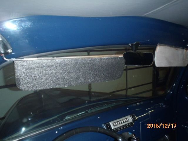

Planning !
Originally Posted by ALBUQ F-1
LOL! I can see where that would be easy to do!
Yeah Ross, and this is after I thought about it for a while !
On a positive note, I managed to get the visor arms free'd up. Thanks to this forum I layed some heat on the brackets and melted candle wax on them. The drivers side actually made a crack sound but both now have lateral movement. Now the key will be to find the sweet spot on how much lubricant to put on them so they are easy to move, but don't sag down on their own.
I also will have the second logo stitiched up today probably, and ready for cutting the material to size and shape. I've got a groove going.
Also did a fit up by screwing both visors into place.
The driver's side droops, probably because it was used the most often. It will require putting some more degrees of bend into it. I'll make my sleeves then try to improve on the visor angle this spring.
