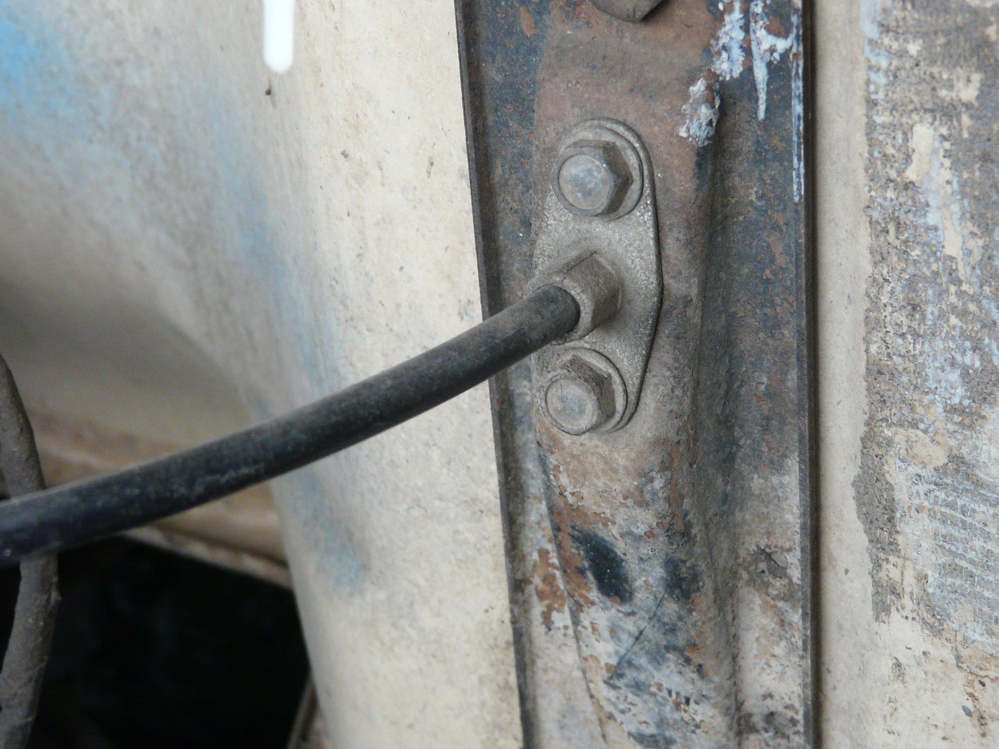

Hi All,
I notice the accelerator pedal has been rigged. I'd like to repair/replace with the correct cable/linkage. Can anyone give me an idea if I would be able to purchase a new cable or hook up.
I guess the real question is what is my next step. I tried LCM Truck, but had trouble locating the part because I don't know the correct name of it.
Anyone's help is greatly appreciated.
I inserted a picture of the connection to help. Thank you all.
Robert
the connection of the accelerator is rigged, want to repair properly if possible.
What year is the truck, what is the engine size?
1966 F100 240 I-6
I doubt that LMC or any other repro part seller will have the part(s) you need.

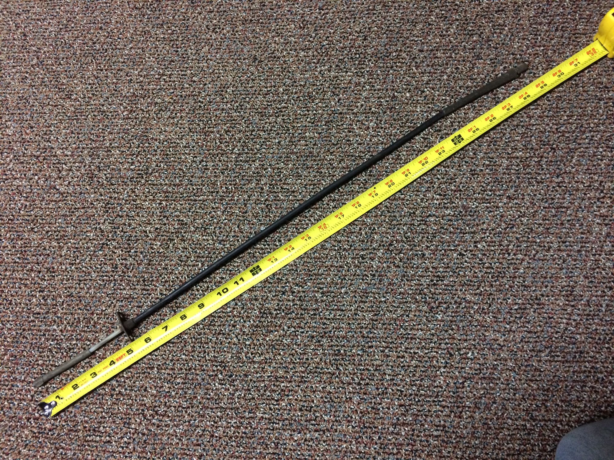

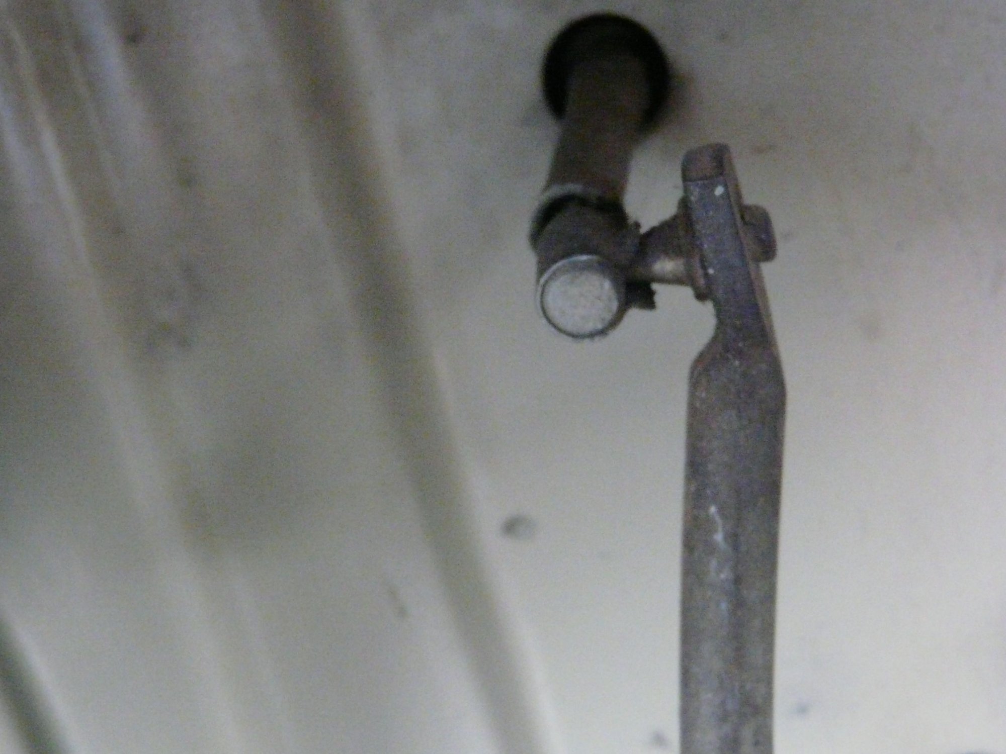

It almost looks like the end of the cable broke off. What does it look like on the engine side? Here are a couple pics of my '66 with a 240.

It looks like the end broke off of the cable. I would try a junk yard for any truck with a six cyl engine. I wonder if the ball/clip-on end from a strut found on camper shell door could be made to work. Here are a couple of pics from my '66 with a 240.

Thank you John, the pics helps. And yes the cable broke off.
