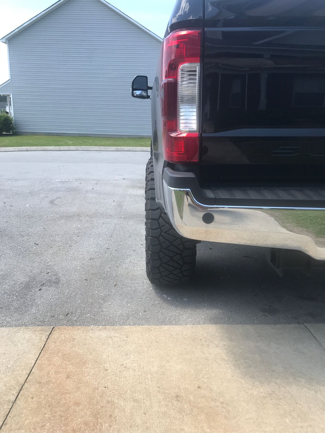

Mine is 3.5 ready lift with no rub on 20x9 0 offset.
Did you install a 4" or 5" rear block or leave the stock 3 1/2" rear block?
What size tires are those? Those look perfect!
I have 37x12.5 x20 Nitto Ridge Grappler with the 4” block
Love the truck. Do the tires stick out past the fenders with the 0 offset? Do you have any pics looking down the side?
Thanks
they do about an inch.
