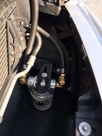

Well, you can just put a filter in line, maybe 10 microns? Or larger media if you wish. True, it is a bypass as it only gets a lot of fluid when the transmission is hot, but there is flow at all times when running.
