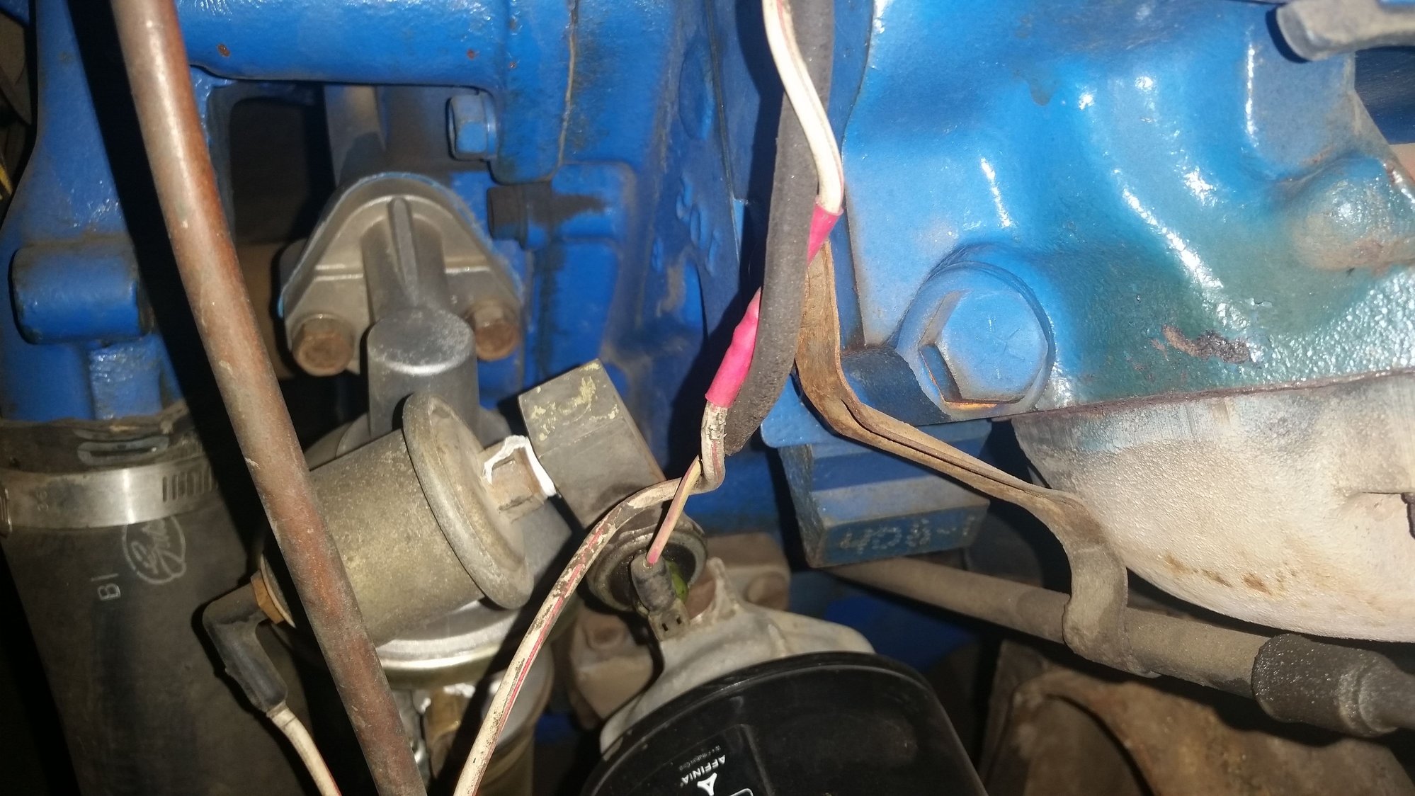

My 428 has the vertically mounted oil filter. Not the horizontal one shown.
Pickups used horizontal mounted filters to clear the cross member, my 73 F-100 had a 428CJ in it with the vertical car filter base, I barely could get the short Chrysler style filer screwed on.

3rd and 4th picture shows reverse "105" on the block. FWIW.
