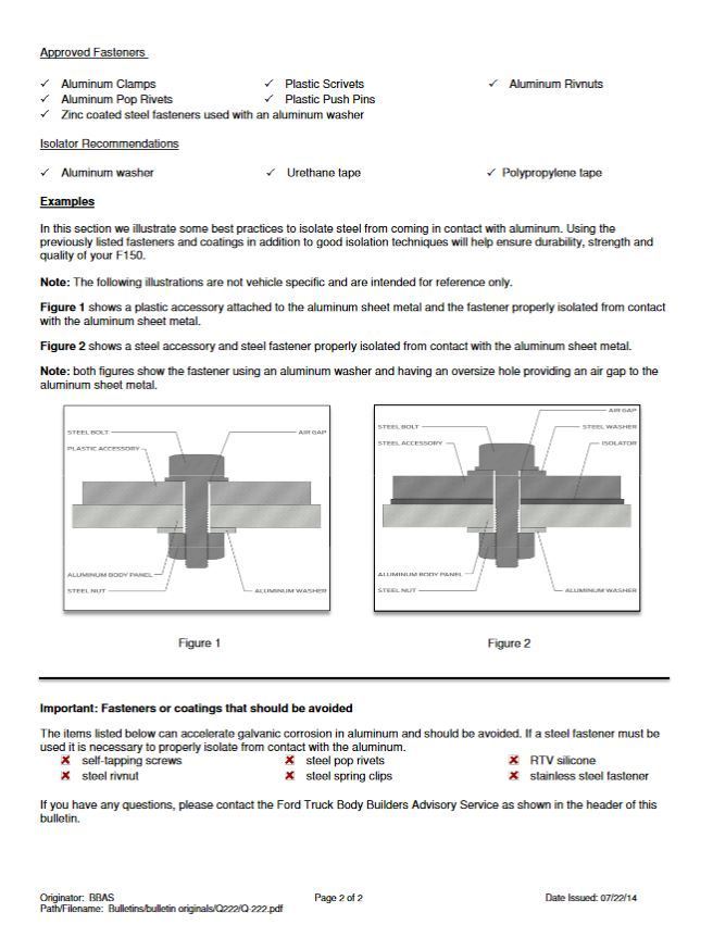

Originally Posted by Sleepyguy
It appears other metals touching the aluminum will be the largest possible problem as it will work like an old battery. Conduction, corroding, mess.
Adding stuff like tonneau covers bull bars etc will they be risks of metal corrosion?
This has been discussed and there is a whole procedure for the attachment of steel to aluminum which includes plastic washers and NOX-Rust or equal treatment of the contact points. A tonneau cover would be least likely to have corrosion problems due to its protection from the elements. Others at the underside would require the most attention.

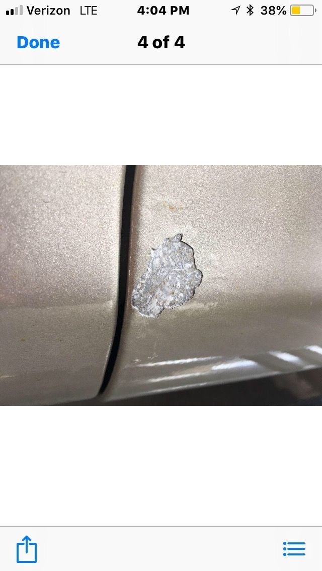

My 2017 F350 Lariat is at the ford dealers body shop having the box doors and rocker bottoms replaced because of aluminum corrosion. A ford rep came in today and said he’s never seen anything like this and asked the body shop if this qualifies for a ford buyback and they said absolutely. The dealer also said it was the first time they have ever had to say that. This was all caused by ford and not something I or the dealer did. I’m waiting for a call from the ford rep to discuss my options. I didn’t pay $75k for a truck that has now had some very extensive repair/rebuild done to it. Just posting to let people know about the issue

Here is a pic of my door

My son just posted the pic of my door. The. Body shop chipped the paint away from that spot and that was what was underneath. I have probably 6-8 more areas on both sides of my box and rocker panels and doors like that

Looks like a flawed paint job.. likely the prep steps got screwed up.
