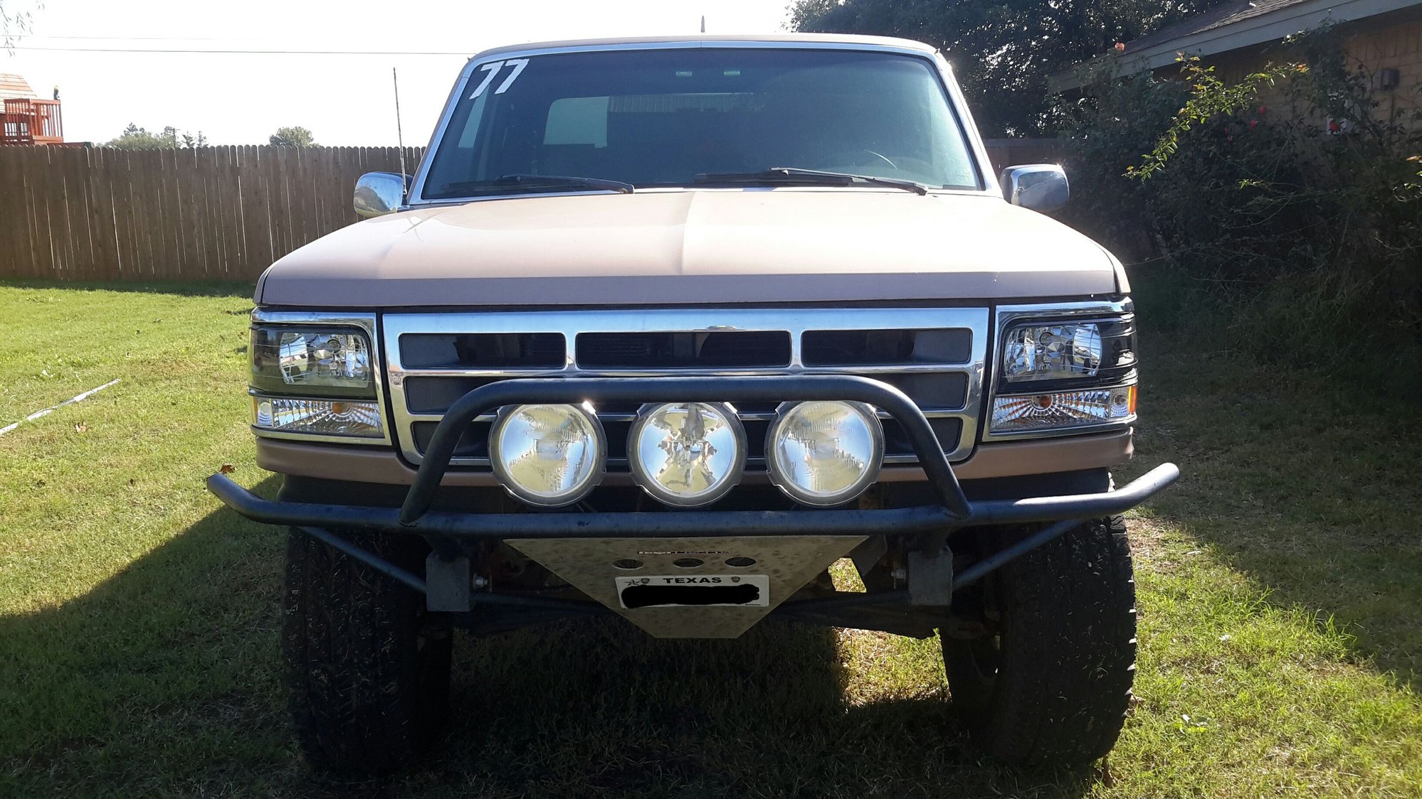

So I decided to replace the headlights after getting some cheap China knock-offs that yellowed after a couple months. I found I liked the spyder one piece headlight and side light the best. First off I'd like to say when I received these light they are boxed and shipped great, quality of boxing was awesome. I pulled the lights out and the feel and quality of the light is great, they don't feel cheap at all. So after a couple weeks of procrastination of installing them I had enough ambition to do so. I pulled the grill, bezels, header panel, and headlights completely off the truck. First thing I noticed is the difficulty the new lights pose.
So once the old was off and the new going on I notice the lack of instructions on the kit. The bezels are designed to have the side light bolted to it, but because it's now one piece it's been eliminated and I've realized to install the bezel you have to cut off the mounting area for the side light. Easy enough for the mini HB pneumatic sawzall, so off the mount goes. So I get the headlights mounted to the header panel and install the bezels. I go to bolt the header back up and realize with the bezel installed I cant bolt down the sides of the header.... off the bezels go only to find out I can't remove them with the header bolted at all. Off the header goes, now to cut the bezels again. You literally have to cut the bezels almost to the edge of the chrome, and once I bolted the header up you have to twist and turn and fudge with the bezel/turn signal to get them to sit in the panel. Once on I was relieved, but was short lived cause I had to bolt up the parking light to the header only by feeling and reaching from the engine bay. Finally get them bolted up and the results are great, unfortunately I will have to pull them back off because there is no way to install the lights on the sides while bolted up.... but here is the finished product.

Good job. I have had mine for over a year and they are just as clear as the day I installed them. Had the same issues as you. One thing I did that you may want to consider, go to the local jy and pick up the pigtails for the lights with as much wire as you can. Cut off yours and wire up the new ones with the excess wire. This will allow you to have the extra wire to remove or reinstall your lights much easier. I no longer dread having to change bulbs when necessary.

Thanks for the input and I'm happy to hear they haven't yellowed on you, I was worried after my last one if I just wanted to find stock lights again. Great suggestions on redoing the wiring longer, I may just wait to pull them back off until I get everything to redo them.

These are stock, plans are to replace with LED bulbs all the way around. Sorry the led markers aren't hooked up yet and I've got some lights burned out.
