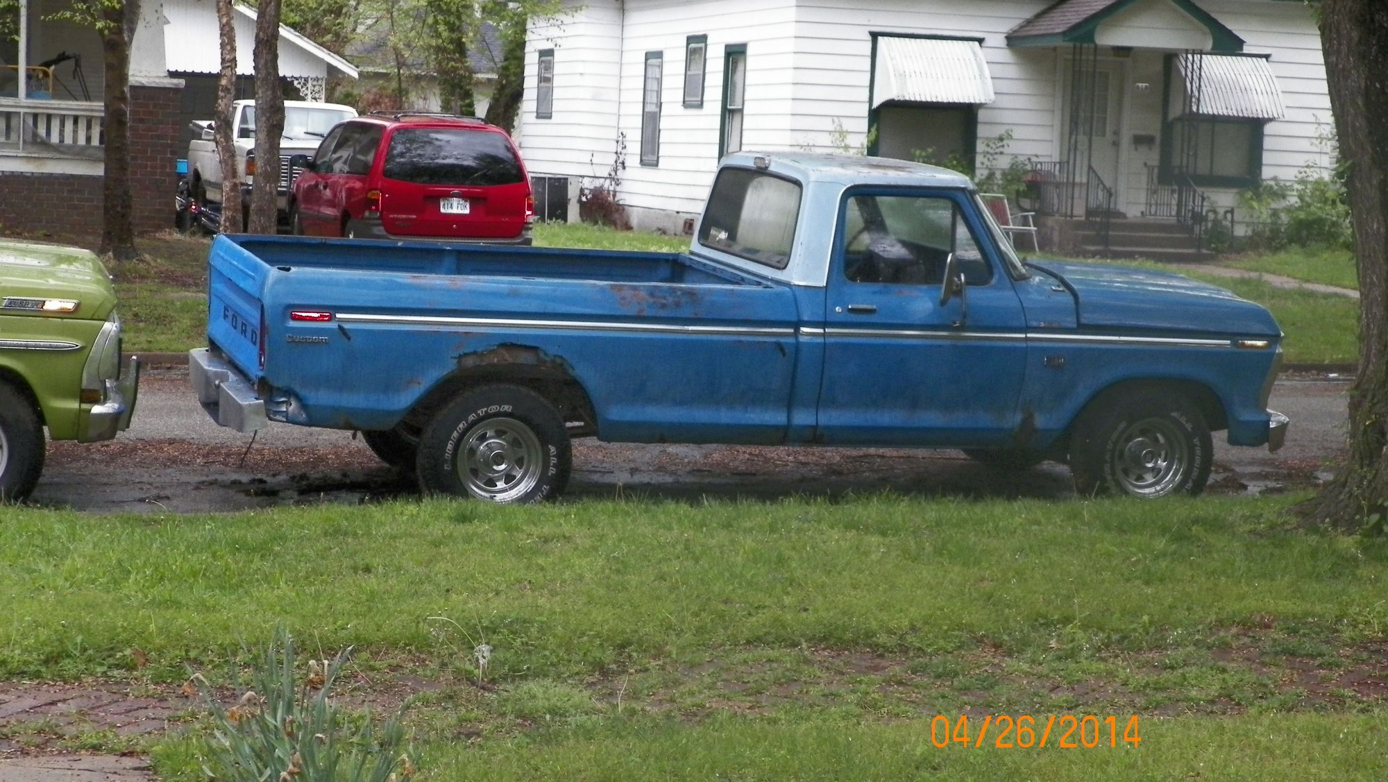

i'd like to do the rear hanger flip on the back of my truck, i plan on putting a posi in, and was wondering how is traction with the axle flip? can i still use something like a slapper bar if i need it. granted my motor isn't probly pushing past 300hp i was just curious how they hook.

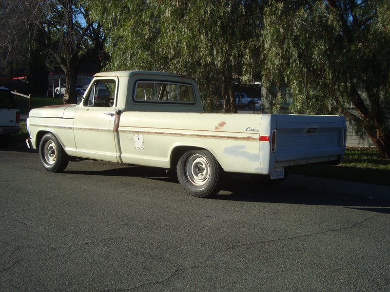

I flipped the axle on my 70 and traction is the same.
All an axle flip does is relocate the static position of the the rear axle.
If youre that concerned, I recall that Lakewood offers traction bars that fit.

Axle flip...
DJMs in front for a 3/5.5 drop. 15x7 with 225/70-15s in front and 15x8 with 275/60-15s in back.

/|\ about there would be the intent, i thought it was just a simple as flipping the front hanger up side down. How much would just a smaller profile tire do for lowering, i'm sitting with 30x9.50r15 right now

The 275/60-15s above are 28.7 inches tall... But it won't have that "tucked up" look. The truck will sit about 1.5 inches lower but all ya got is more of a gap between the tire and fender
Here's my truck, post axle flip, with your tire size all the way around... the nose is like 0.75 inches higher than the rear. I 'fixed it' with slightly lower profile in the front.
