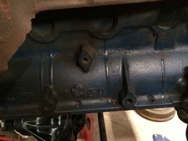

Here's an original engine block

I bought NPD's version of 13358 in a rattle can and it looks way too dark to me, and also a little too purple. The blue in your pics is very close to what is in the rattle can, but that is much darker than the color of old breathers and snorkles I have with original paint.
I decided to go with Dupli-color "Old Ford Blue". It is very close to the original paint I have samples of and unless you hold them side by side in the sunlight you can't tell a difference.
