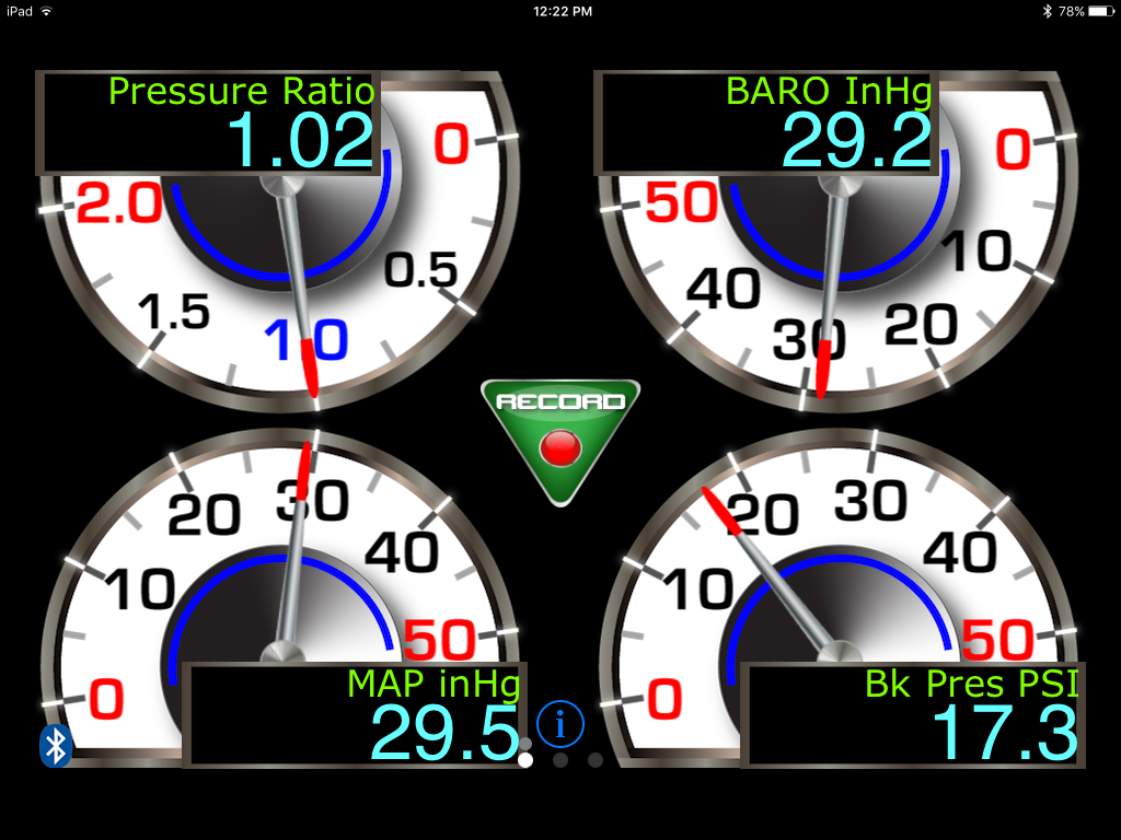

Here's a page from my Dashboss to verify all is operating at the proper baro pressures.
Know that EBP is rated by psi, not hg's of mercury but if you convert the data, that too will be close to the other measurements.
