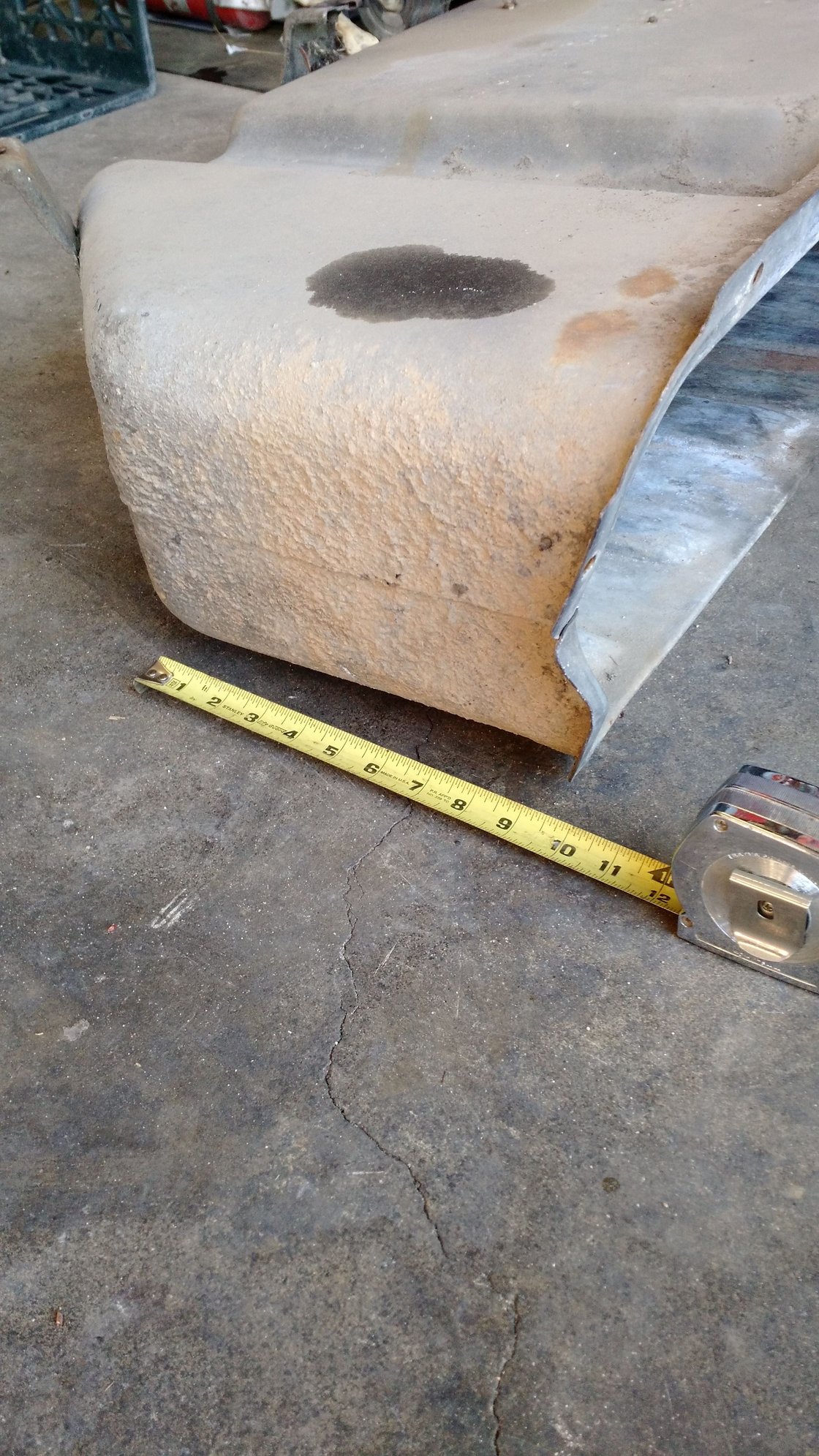

Thank you Bill and thanks Rich. I wonder why we have to modify our boxes. It seems like there's only one choice. I'll attach some pics to show what I've got. Maybe someone has more info.
This is where it hit the spring hanger.

Yep same as mine. notice the little square patch in the left of my first pic.
I'd say these 4wd never came with a tool box orich

Orich. I'm glad you clarified what happened in your case with the above quote. I was thinking of just deforming the box a little instead of making a patch. I think if I need to remove the spring eye bolt i'll remove the box to get to it. I just put new springs in it and hopefully I won't need to get to that bolt again.

Can you cut out a rectangular or oval section there, reverse it, then re-attach? Making it an "innie" rather than an "outie".

Hmm Jeff by reattaching it by what means like welding the Galvanize?
That's some nasty stuff to weld old school way.
Orich

I hadn't thought of that. That's some good creative thinking Jeff. I'm still thinking of just deforming it (AKA dent). It only needs about an inch.
I've welded galvanized lots of times. Just have to make sure not to breathe the fumes. I think they sell a spray can of galvanizing to try to stop the rust.
