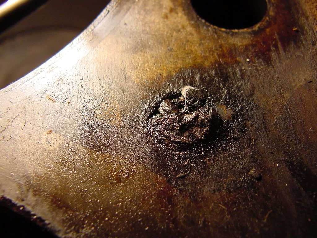

Engine Cylinder Head Bolt Dorman 675-131 | eBay
$1.55 + shipping
or
Dorman AutoGrade 675-131 - Cylinder Head Bolt | O'Reilly Auto Parts
at $2.29 each
To avoid the broken head bolt issue I had...
Jim
