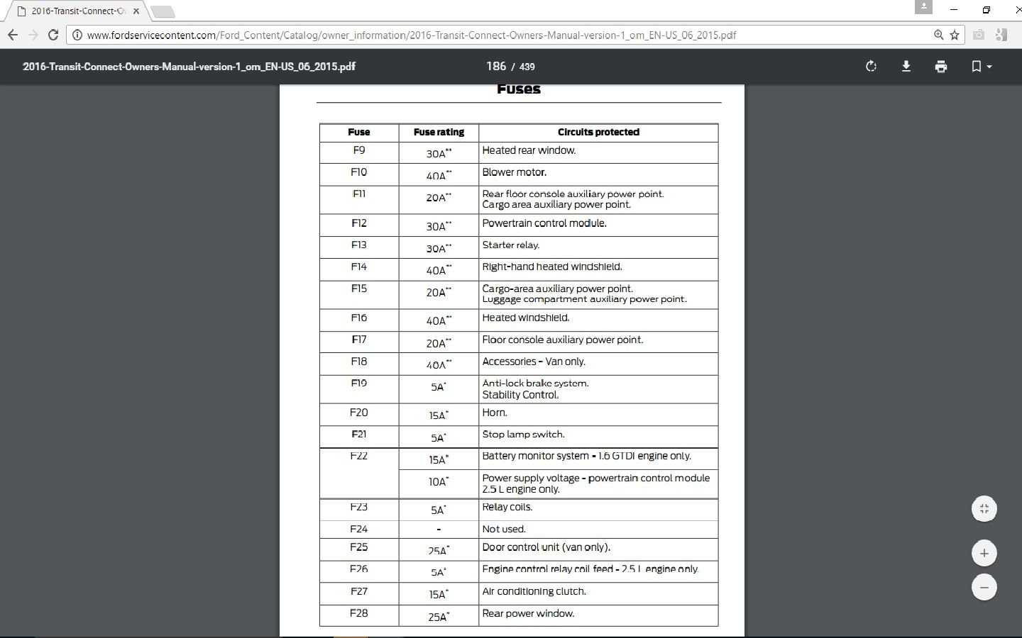

There are others on this forum who will probably give you a more precise answer. But, when my horn went out I found that the manual had a fuse diagram and I was able to get to it from that. The only problem I had was getting the lid off the fuse box--I eventually figured it out.

Starting on page 182 of your owners manual is the fuse chart. It looks like:
F11 is 20A for "Rear floor console auxiliary power point. Cargo area auxiliary power point.
F15 is 20A for "Cargo-area auxiliary power point Luggage compartment auxiliary power point
F17 is 20A for "Floor Console Auxiliary Power point"
I think that covers it, but check manual if needed.

It sounds like F11

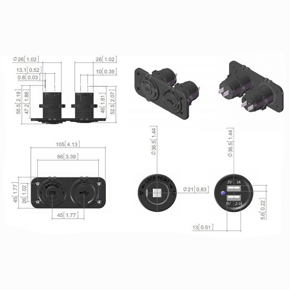

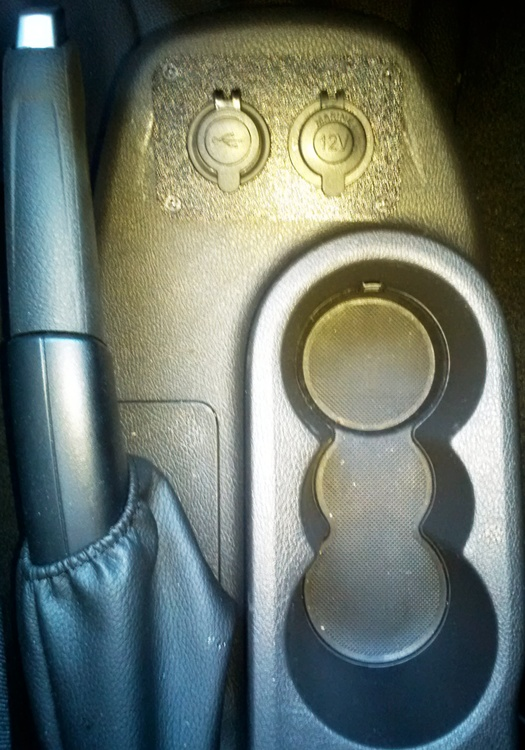

While you're at it, add some USB ports for power.
