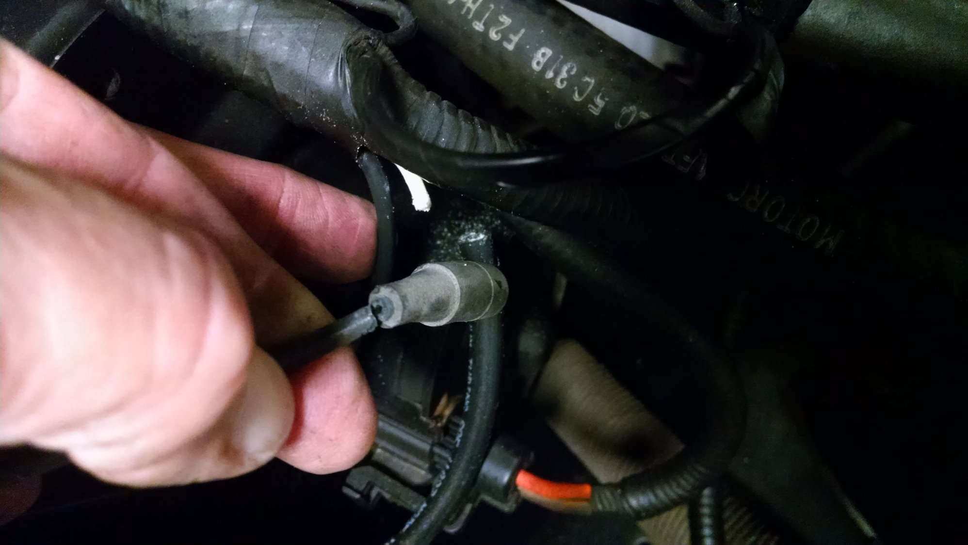

[IMG]https://cimg6.ibsrv.net/gimg/www.ford-trucks.com-vbulletin/2000x1124/80-vac_leak_dd5dbf38bc42d1b60f36f387d184ad1cf081face. jpg[/IMG
I was going to use my air compressor to force the smoke but I saw smoke before I used it. Here is where it is leaking. The other side of the line is if front of my finger and goes into the large wireing harness.

This is where it was attached

I am going to have to replace the line or the vac end to fix this leak. It goes into the large harness and the line broke at the large vac end where it attaches to the part. Can I replace the vac part where it broke or am I going to have to go into the harness? Thanks
