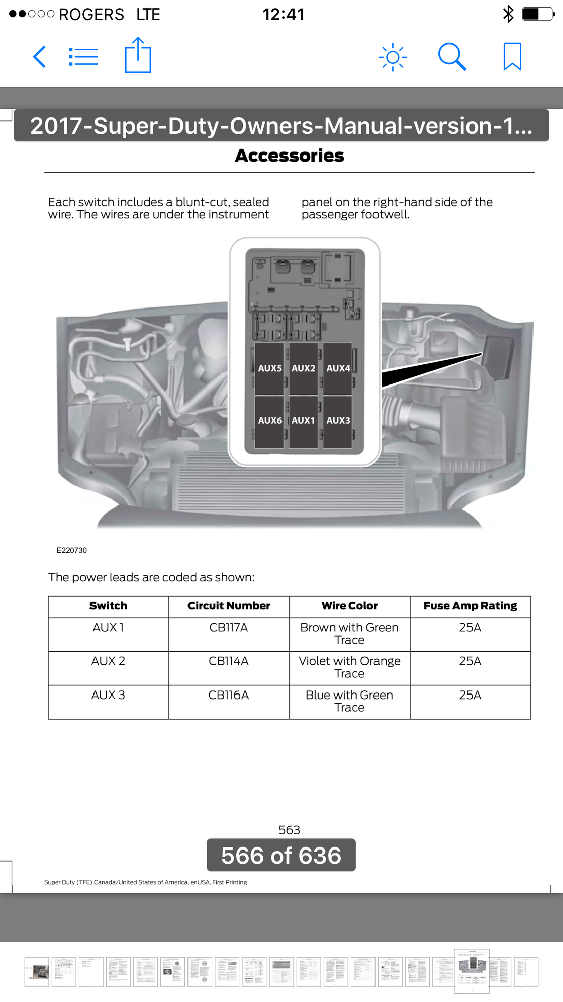

I tried the search on here, came up empty handed. So 2 questions:
1: Does anyone know the part number for the "foldable bed extender"?
2: Upfitter switches. On my 13 f250 there was a little bundle of wires under the dash, I found all 4 wires there. I read in the manual that the 17s, they are on the passenger side under the hood. Are there none inside the cab? Or what is my next easiest 12v source to hardwire a radar detector?

page 563-564 in owners manual?
