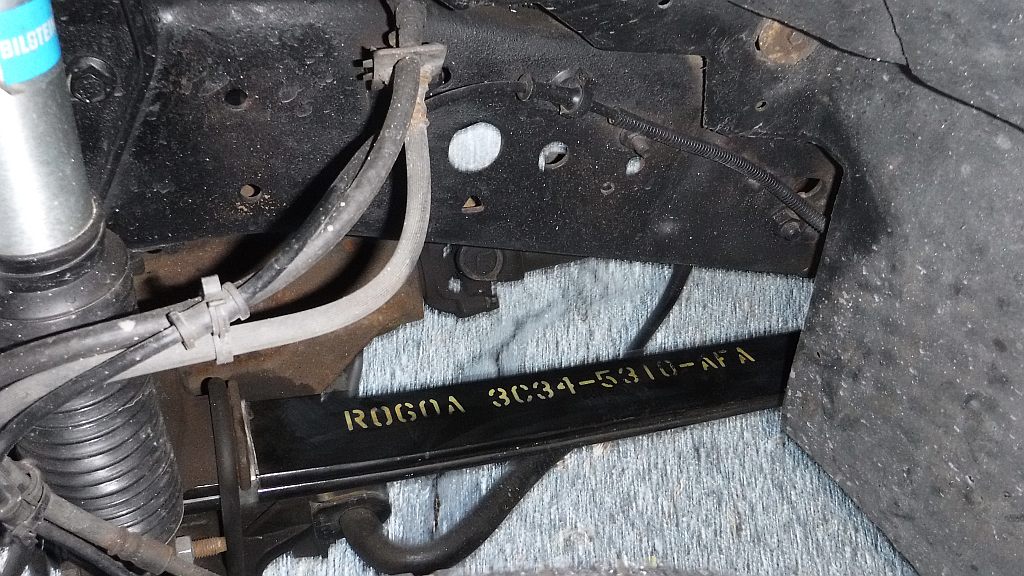

Hello. My truck in my signature had a lift on it when I purchased it and I'm not sure how much of a lift it is. I purchased a 5th wheel camper and my truck is too high to tow it properly so I am looking to lower it to help with better 5th wheel and gooseneck towing. I will also be going down a tire size from a 315 to a 285. I am concidering going with X Code springs from Ford. I was wondering if anyone has a truck with a fairly new set of Ford XCode springs that could get a measurement form the axle to the frame to show what the ride height is. A pic of the points that you are measuring from would be great also if possable. I don't want to lower my truck more than needed so knowing what the ride height will be before hand would be great. If needed what it the best method of providing a little more height than the X Codes will provide? Thanks in advance for any help or opinions.

4 1/2" to the bump stops. I had the crappy stock springs with split leaves, and they sagged something fierce. I was at 2 1/2" from the bump stops. Cody surveyed a bunch of 7.3Ls in his shop, and the noses on all those 4X4s averaged about 4" to 4 1/2" from the bump stops.

Thanks for the info and pictures. I went out to my truck and I have a little over 7" between the bump stops and where they hit. It sounds like if I went with the X Code springs I would be lowering my truck approximately 2.5". 1" lower with the smaller tires and 2.5" with the springs will give me 3.5" total drop in height. That height height should work out good with my 5th wheel camper and my gooseneck trailer. Now I am going to need to find a factory original track bar bracket and a factory pitman arm as my truck has a drop track bar bracket and a drop pitman arm.
