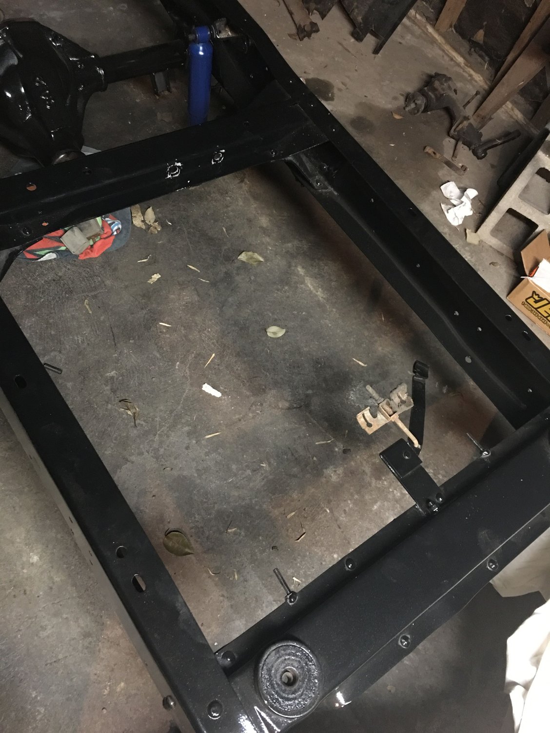

Hey guys, I have a question about the E brake for my 1965 f100 longbed. I purchased E brake cables that are for my specific year and bed length, but the cables won't reach the other piece? They're about 12 inches or so too short. Is there a piece that is suppose to go in between these that I'm missing?
i posted a picture below of another truck because I already removed my cables, but as you can see on his, the cables are too short aswell? It really looks like there's suppose to be another piece.

heres a picture of my truck. I don't have the cables in, but when they were in they were the same length as the original picture I posted. So as you can tell, there a bit of distance from the cables to that attachment.

Alright, check this out. Just found this picture online, as you can see they have an attachment that fills in the gap that I currently have. Does anyone know what that would be called so I can buy one?

Originally Posted by Jesses1999f250
Hey guys, I have a question about the E brake for my 1965 F100 longbed.
Are there extensions that are supposed to go in between these that I'm missing?
2) C5TZ-2A793-A .. Extension-Parking Brake Cable - 14" long / Obsolete
1965/66 F100 with 129" wheelbase (8' bed).
OBSOLETE RELIABLE PARTS in Nashville GA has 2 = 220-686-5101.
CARPENTER NOS OBSOLETE PARTS in Concord NC has 2 = 800-476-9653.
GREEN SALES CO. in Cincinnati OH has 7 = 800-543-4959.
See 2A793 in pic:
See 2A793 in pic:
Just ordered it. Thank you very much!
