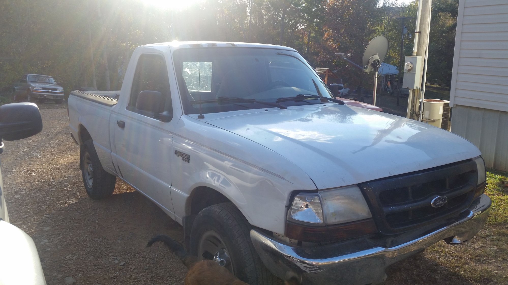

Here it is, not the best but for the price it's well worth it. He only gave 600$ for it.
This is the flexplate that was causing the initial problem.
