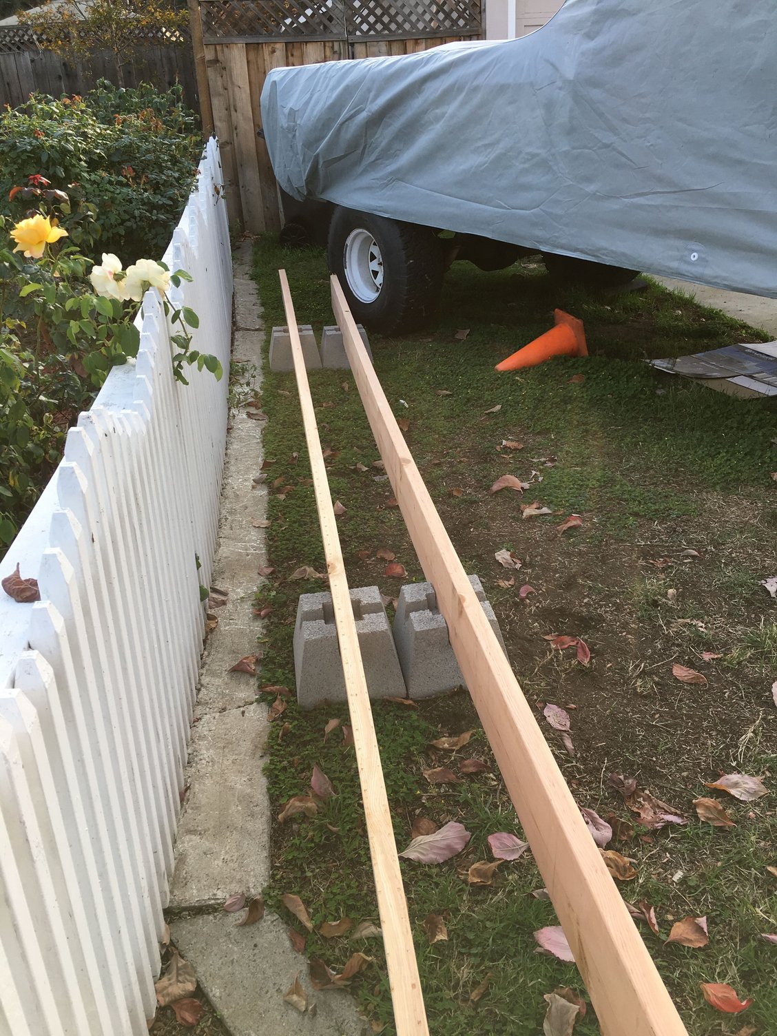

I decided on some pier blocks with 2 16' 2x10s and I bought a 2x8 to make a couple of cross members. I have three guys coming over tomorrow, so the plan is to lift the bed and the cab off the frame and set them on the new wood frame. Once I've got that done I have a roller and it will fit in the garage.

Getting ready to remove the bed and cab
Out picking up the wood and blocks for the temporary frame
Hoping the 2x10s hold up well
