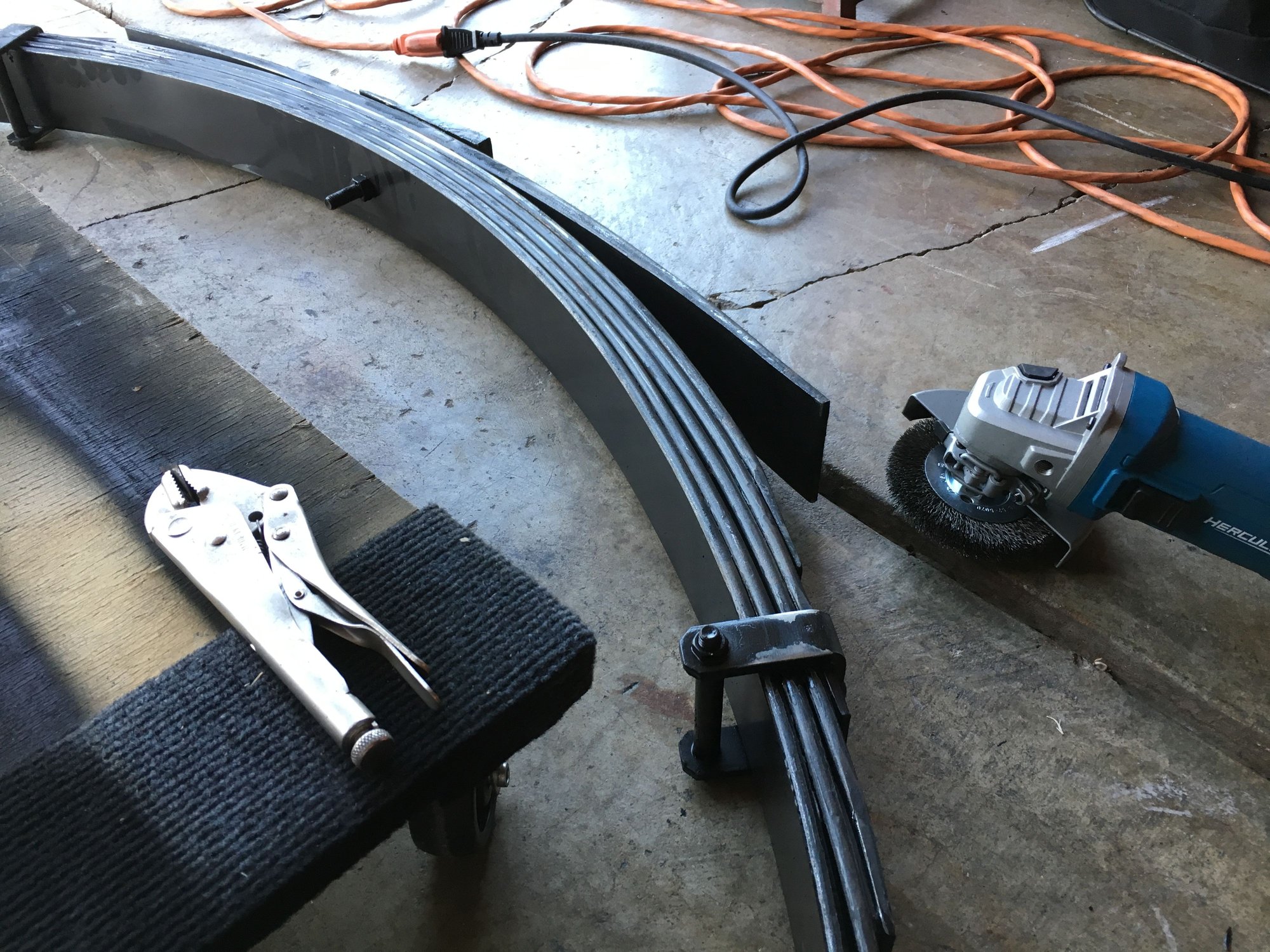

I was also unhappy with the way the leaf springs came out the first time I painted them so I stripped them back down to metal again and redid them. Very glad I did.
Enjoy the pics.
There were a few imperfections that showed up once they were painted. After staring at them in the garage for a few days I knew I had to start over.
Using the new grinder to strip of the paint between the leafs.
Much better

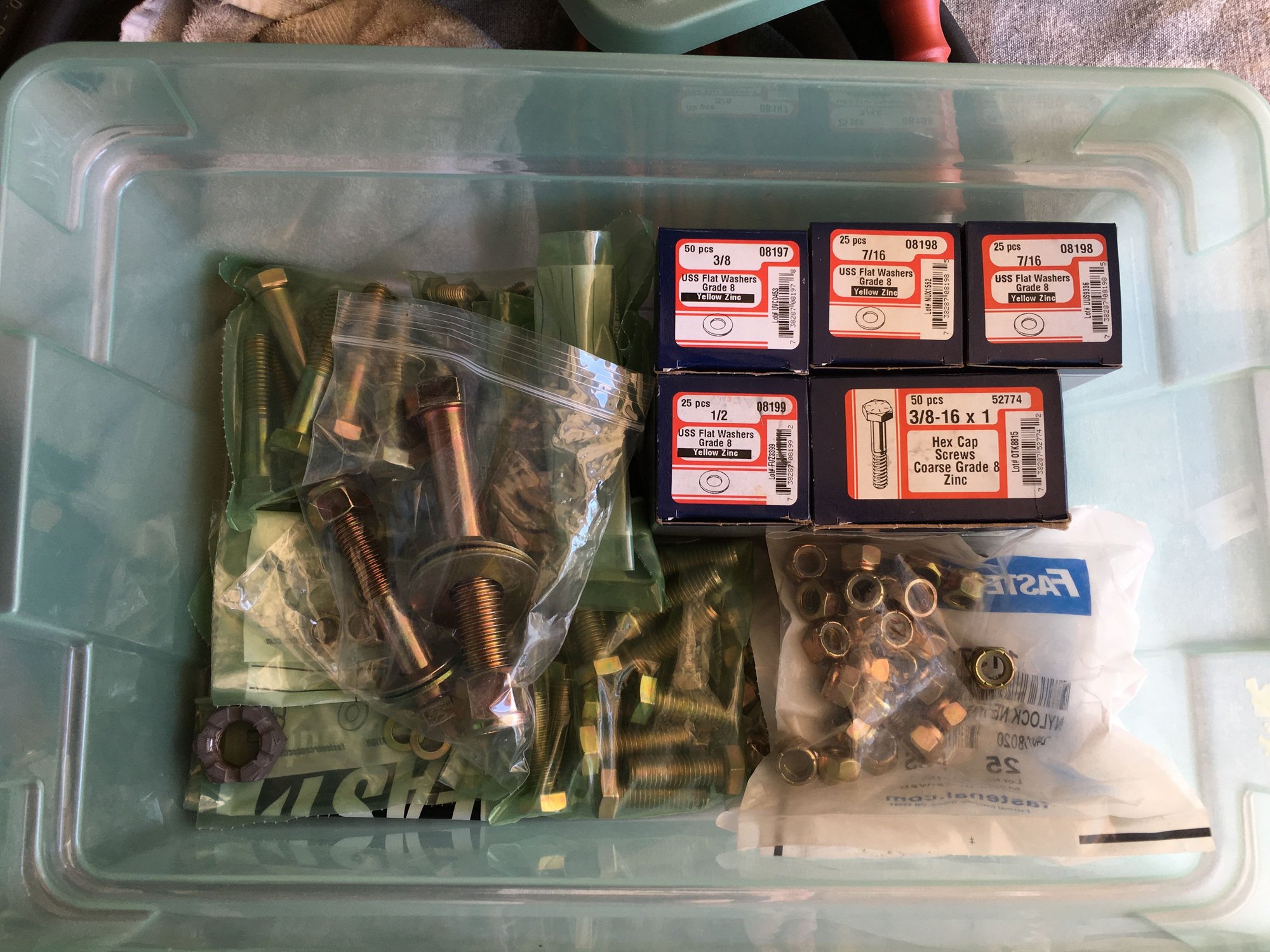

I'm wishing I would have taken a picture with all of the new hardware in one shot. That way I could have compared it to the tiny pile of bolts I took of the truck.

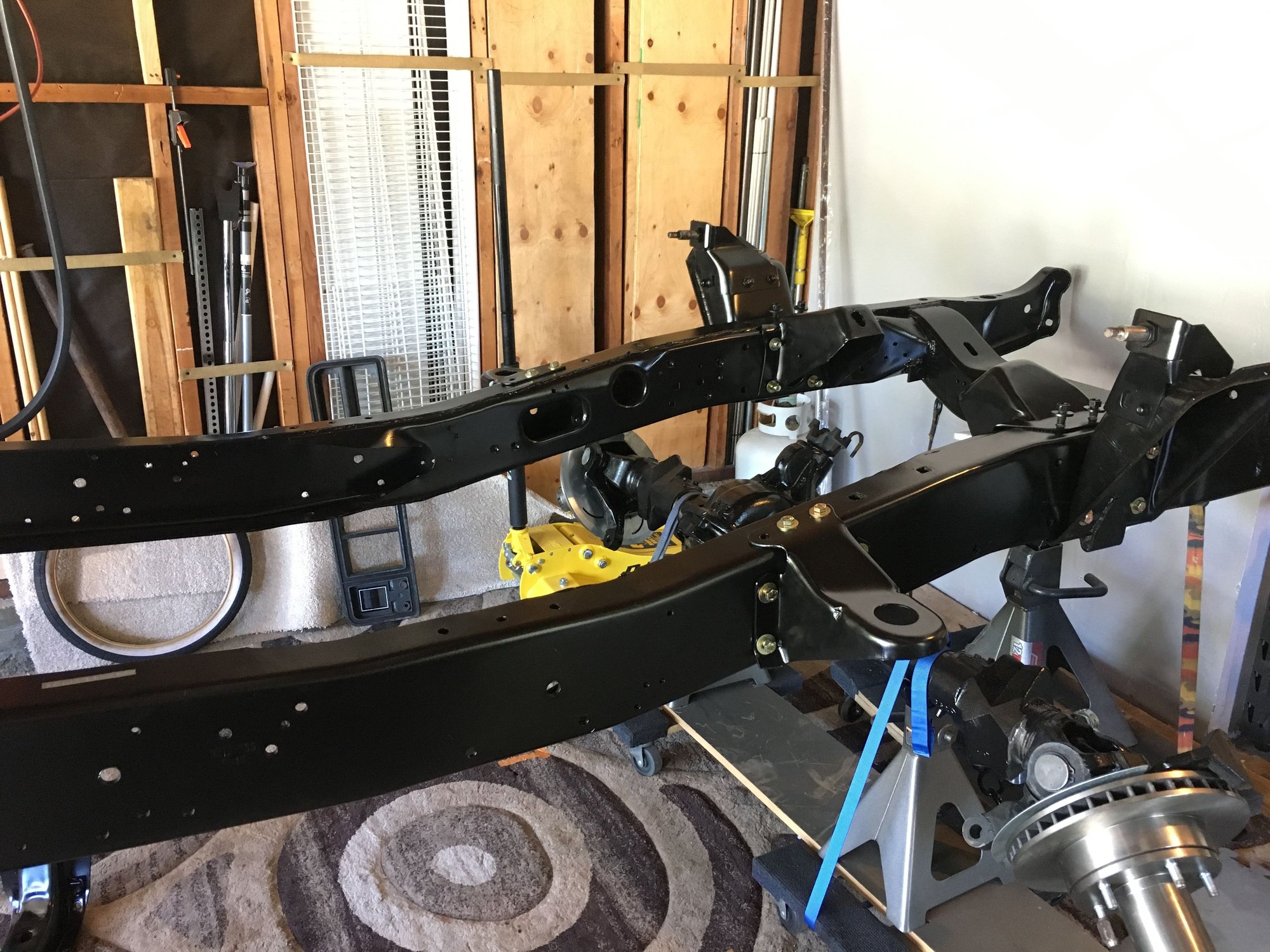

Moving the frame out so we could get the crane under the front end
Don't need any spring compressors here
Radius arm caps went on without any issues, had to use a ratchet strap to bring the left side of the axle in enough to get the bolt on the end of the radius arm. Without pulling it in, only a few threads were exposed at the end of the arm
First spring went in easily, second one we found it was easier to install the spring cap on the bottom loosely and then spin the spring under the tab. Was a lot easier than holding the spring while trying to line up two pieces of steel over the bolt hold
I think I have spent as many hours staring at this as I have building it. Something about the new hardware makes this so satisfying

I wish I would have got a picture of all the new hardware together to compare it with the tiny pile of bolts I pulled out of the truck when I disassembled it.
