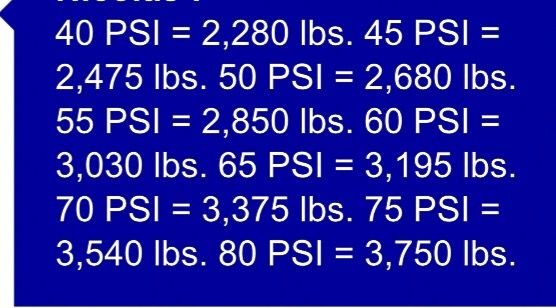

I found a Michelin inflation chart, and running the LTX AT2, I would be within specs at 35psi on rears (figuring 3500lbs on rear axle) and 50psi on front(5000lbs front axle). Not that I'd go that low, but it is within spec. I live on a pretty rough piece of road and really notice a reduction in bounce after dropping my pressures and taking a spin. It felt real good at 60F/50R.

So long as the math check outs (which is does, since you checked the tables), go old school and chalk test the tires. Rub a line of sidewalk chalk across the tread, roll forward a dozen feet or so and look how it comes off. Lower the pressure until it wears evenly.
I don't go under half tire pressure regardless of what the inflation table says, and if the tires feel squirmy I'll up the pressure some (shouldn't be an issue in a stock size). I'd weight the truck too, a scale ticket is $11 where I am and it's good solid info to start with.
55/40 is probably a good starting place to check.

My Cat Scale ticket from today, 3/4 fuel, normal cab stuff, and two logging chains in the bed reads 4740F/3420R. Using the chart below and not going below half full max load ratings are 45(2475)/40(2280). Gonna try 50(2680)/40 and see how she runs.
Thanks for the input guys.
For anyone who is interested and is running 20" Michelin LTX AT2, this is the max load/inflation info directly from Michelin:
