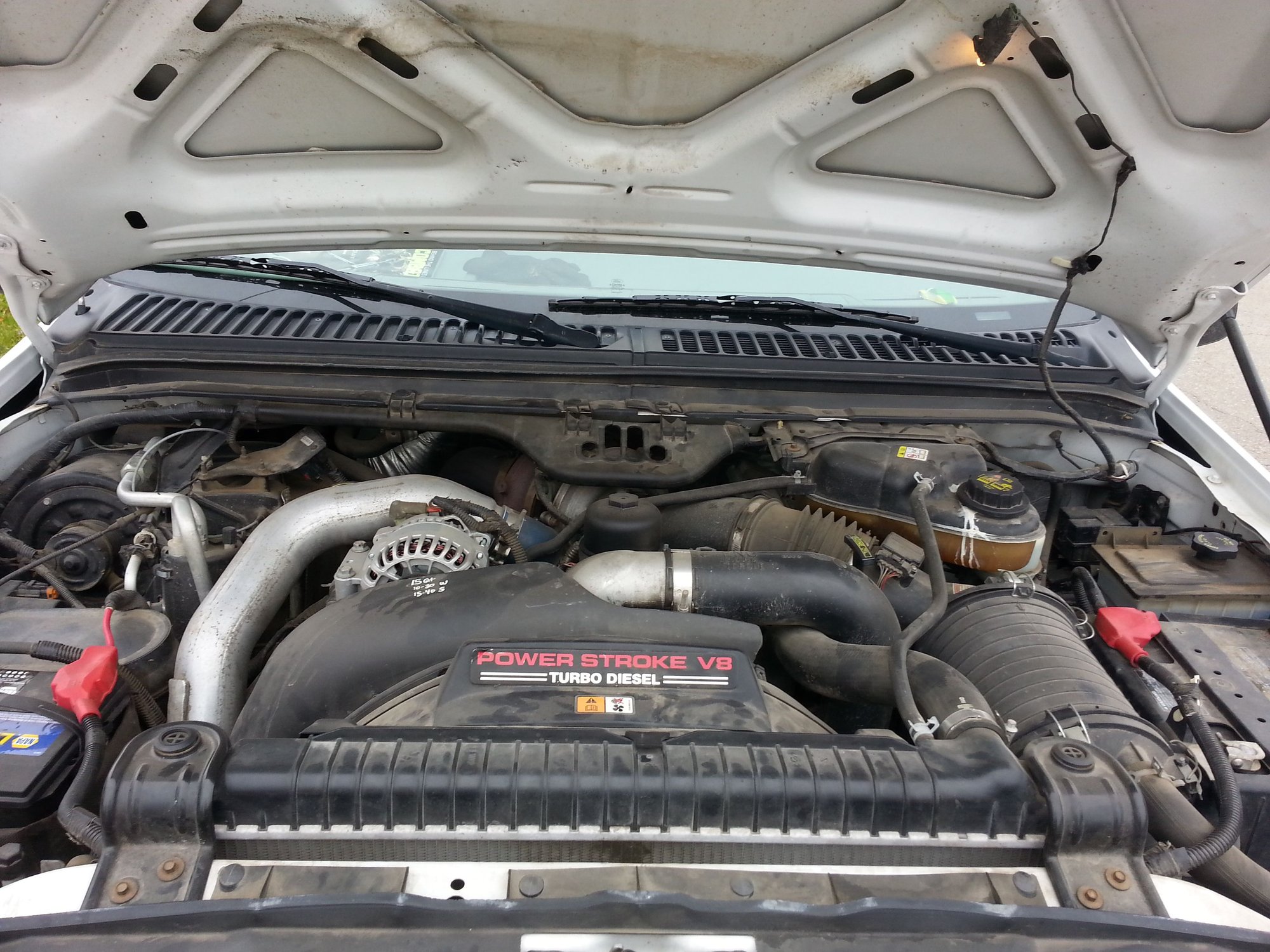

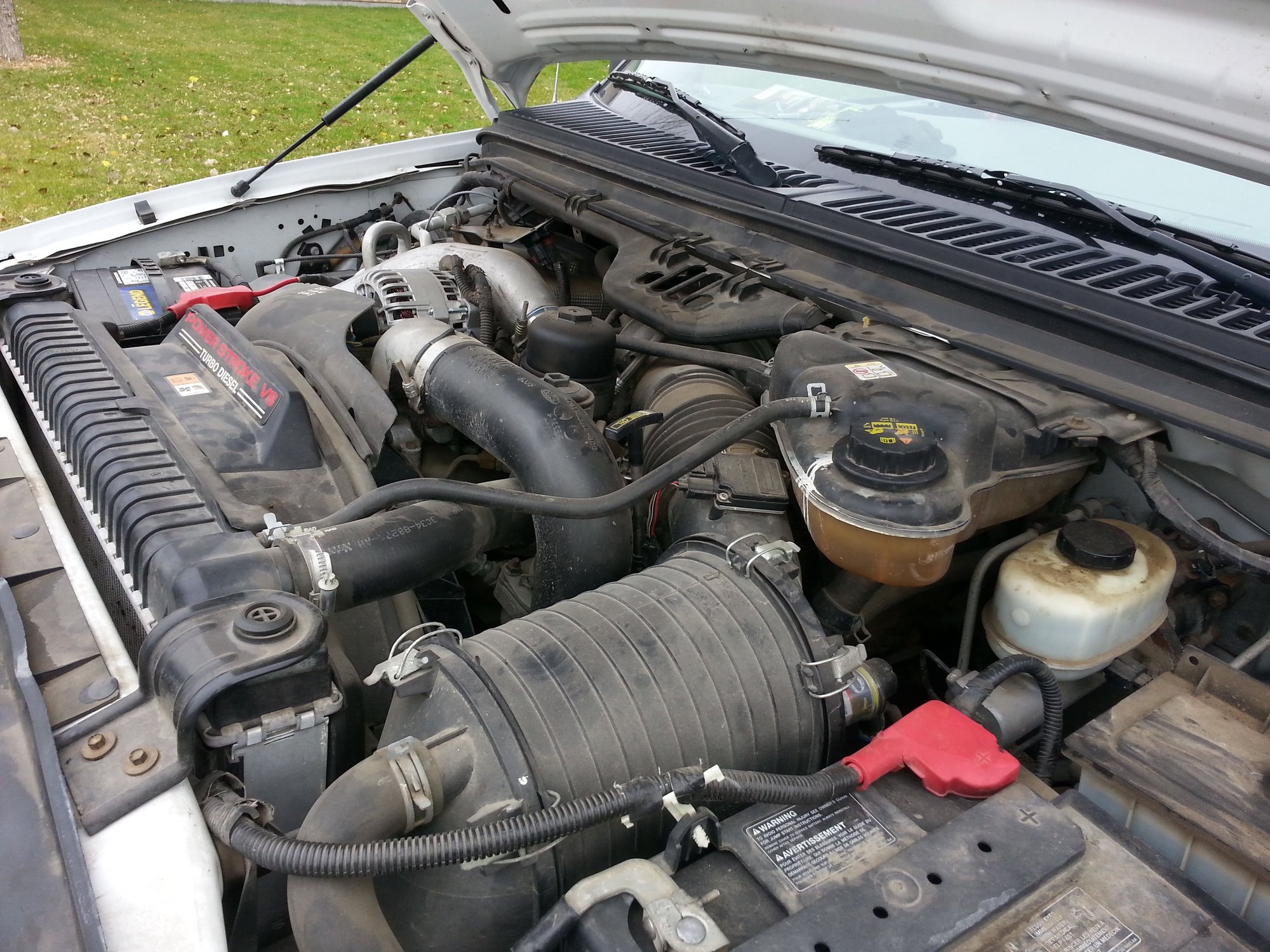

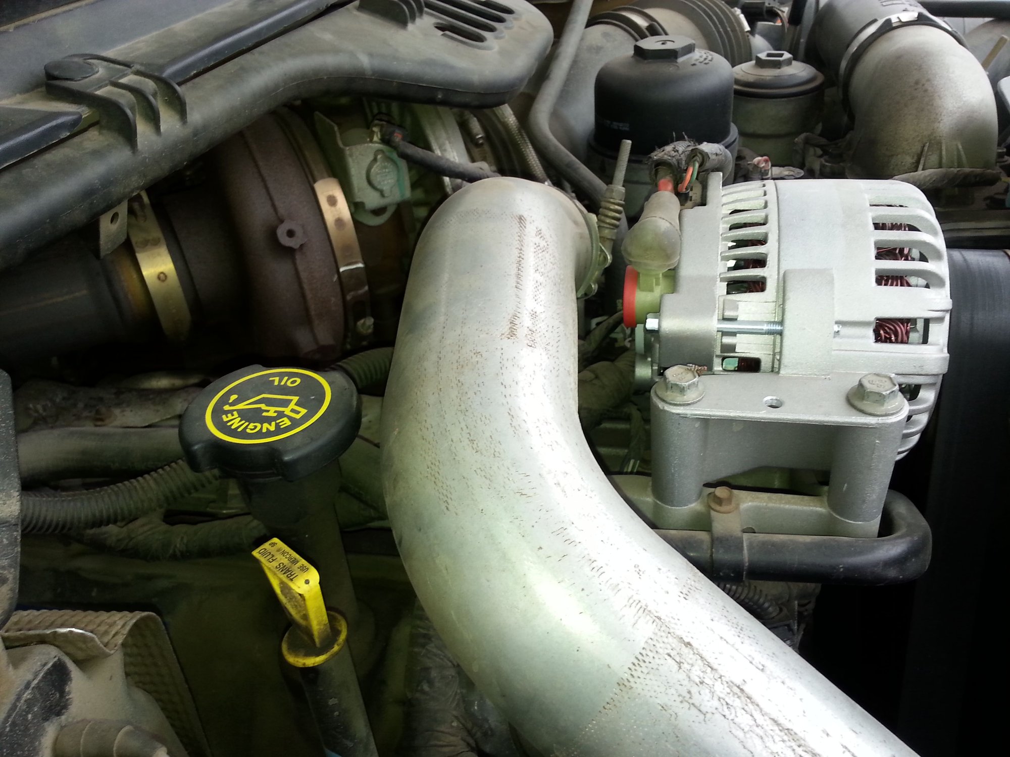

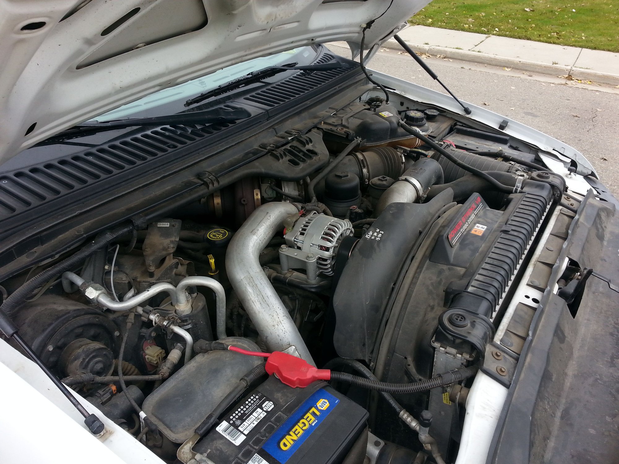

As someone suggested, underhoods and some undercarriage pics.

Looks like an aftermarket Oil Filter cap -- that and a stock oil filter = NO oil filtering, get an OEM cap and filter on there ASAP. Also see your degas has puked a little - check level 1st (at min line as Maximum on level ground when cool), could be the cap they do go and are inexpensive to replace, but it could be sign of other issues...
Alt looks pretty new btw, somebody else may be able to tell what it is just from the pict...

I am actually slightly confused on the oil filter situation, that one is a single unit, the cap gets thrown away with the filter. Should I use the OEM style over that? I've been watching the coolant level very carefully but also haven't replaced the cap because I don't know who makes a good cap. Alternator died last winter, R2 it and haven't had any codes pop since then. Btw, been using the reader and the app. Only code I have is the cruise control lamp inop, which i already knew about, CC still works, just no light.
Also the cap puking could be due to something EGR related? or worse...heads?
Trying to source an air filter that works with OEM, any suggestions?

Could be HGs, but that looks pretty minor. Just get a Ford degas cap and while you are at the dealer get the OEM Oil Filter cap. You can get the motorcraft oil filter there or at WallyWorld for less, but it is Ford filter + Ford cap and pretty much nothing else. There are YouTube vids about the oil filters, so that is pretty much the mantra around here.
Let's get a differential reading on your oil to coolant to see how the oil cooler is: warm it up good and then out on a flat stretch of highway 60 - 65 but try to stay as constant speed/throttle as you can. Give it 15 minutes, more if oil temp is still rising. Tell us what the highest difference is between oil and coolant and also what steady state temps of both were (this is also a check for your thermostat health: should be high 180s to low 190s Minimum).
You'll also want to check your oil and coolant temps after a good cold soak - some say 12 hours is good, I think 24 unless it is pretty cold where you are. This is important as it affects the above test if the sensors themselves are off.
You should be monitoring your voltages: FICM Main, Logic, and Power, and every batt voltage you find: Vbatt, Adapter Volts and there is one more. You want to look at these on cold start and steady state.
What Alternator did you put on?
Did you end up with Torque Pro, or?? If Torque there are some gauges I can give you...
You can check your EGR cooler by parking nose down over night and pulling the EGR valve (you should clean it anyway), look at valve and in the port it goes: valve if it looks "steam cleaned" and in the intake for moisture/coolant. Your '04 likely has the round style EGR cooler and they aren't nearly as problematic as the later square ones.
Scott

It was a Napa Alt. I made sure it was one made for a single alt system.
