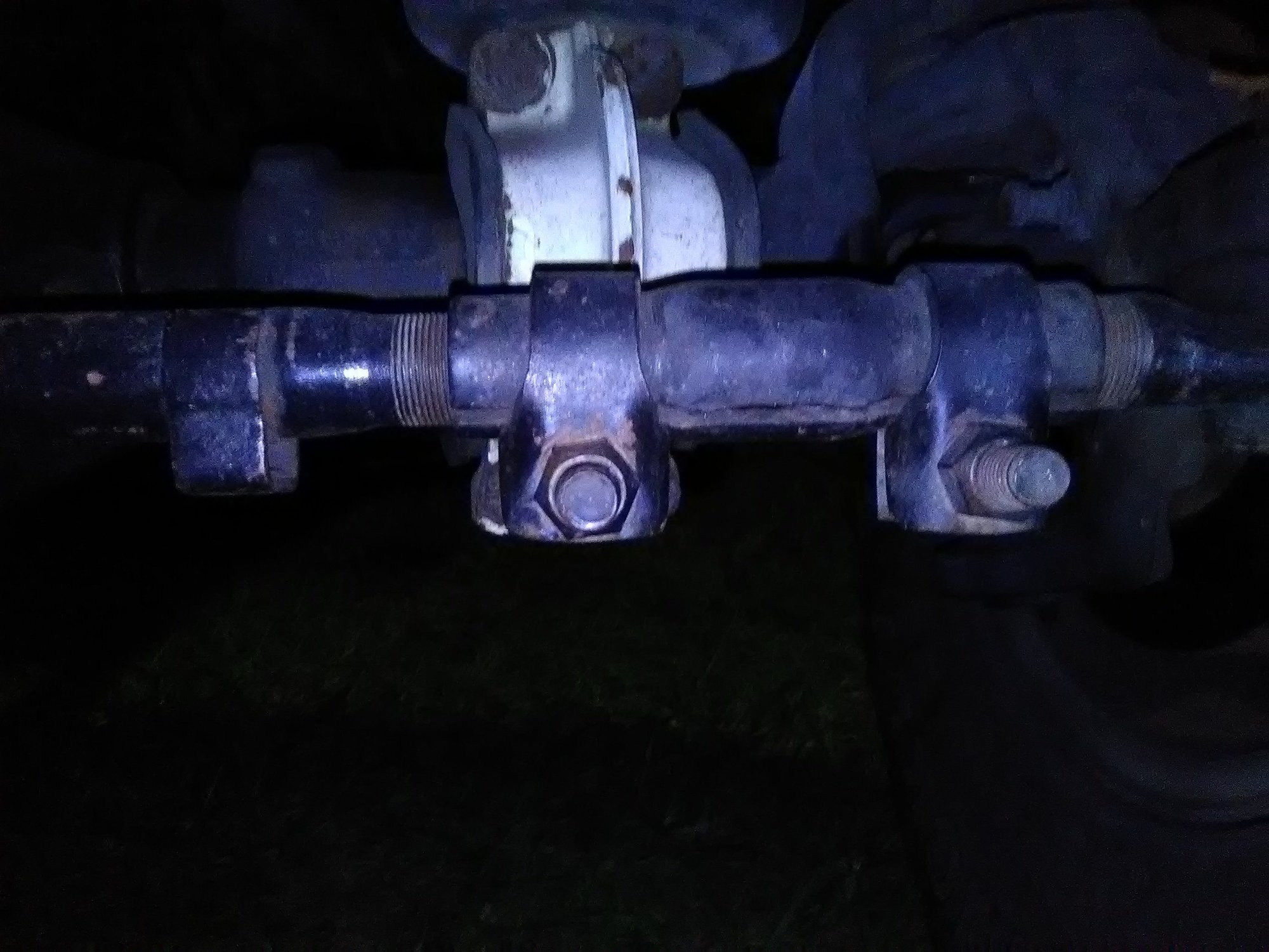

STEERING KNUCKLE?
where to find 70 models danna 44 stearing knucke ford not sure what I even have 78-79 or 73-77

The bolt holes in the top of the spring cups that attach to the knuckle / beams are wider for 78/79. So there is a difference to look out for. You need to stick with pre 77. That is if I'm on the right track of what you need??? I was referring to the white pieces in your pics. Some people say a knuckle is on the end that the hub brakes attach to???

('white' in ur pic is the C on the radius arm & the cover of the frnt 'chunk'):

You have pictures of the front of the radius arm, differential cover, steering linkage and outer assembly: basically pictures of the whole front axle assembly. Im not even sure what you are asking. The knuckle is the outer part that the ball joints, spindle and brakes attach to. What is wrong with it?
