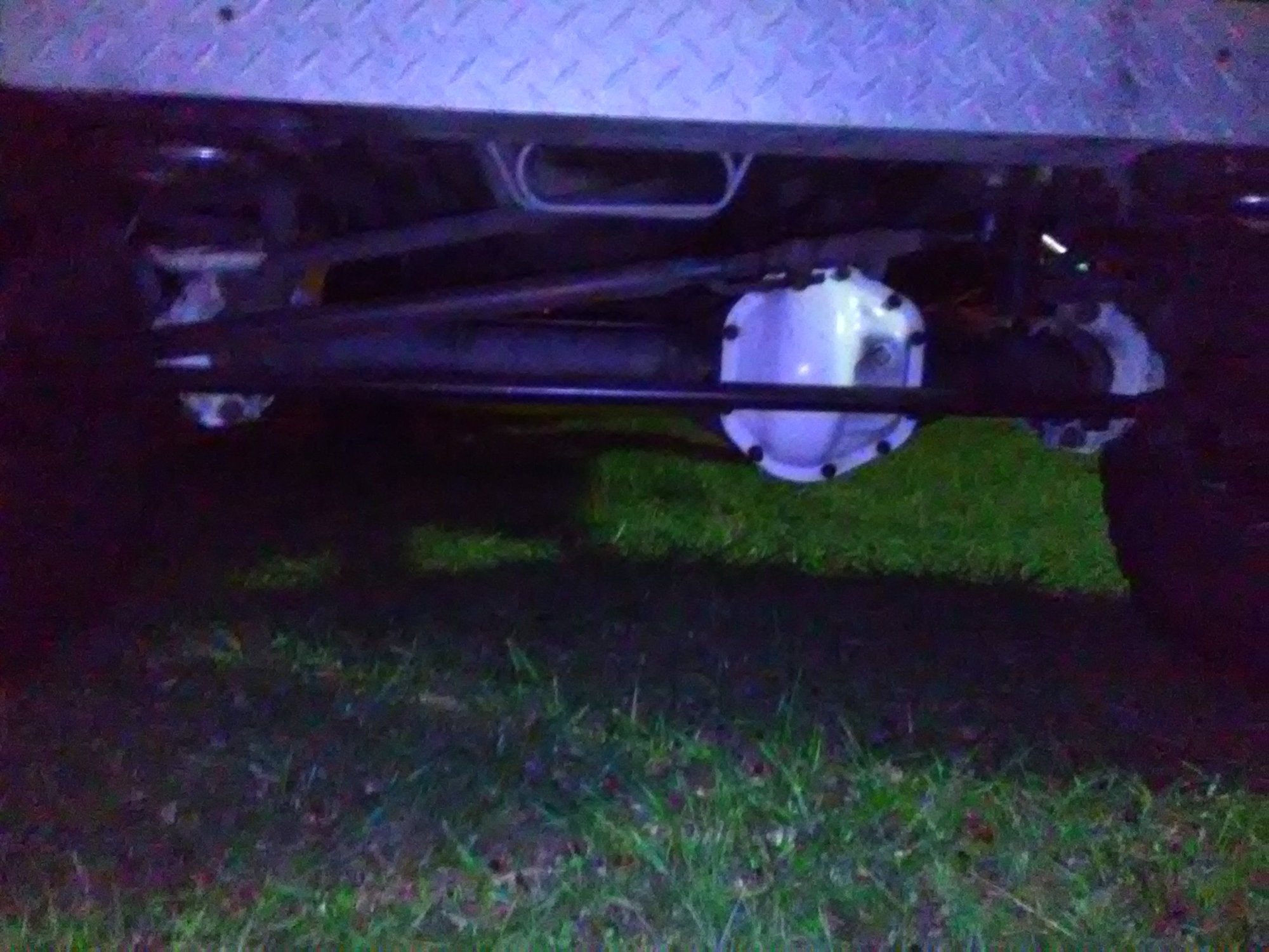

I'm notsurewhat danna 44 this is I bought it already under the 1996 f150 , I was told a78-79, I need a steering knuckle mines walered out where the tie rod connects driver side and not sure where to get one or witch to get and I need , Already had death wobble till I replaced the bushing I beleave draglink(from frame to axle)any help or info would help,only one shock in the front it has bad steering, 6 inch blocks under front ,lifted coil spring 3-6inch fronts levle with the back don't even know if I need steering stablelizer I want it durable on the street and offroad HELP.

looks like a 70s dana 44

1977 and down had drum brakes. So it is probably a 78-79. I would remove those 6 inch blocks in the front

i dont see any blocks in the front. perhaps some day time photos??
78/79 D44 had disc brakes

Actually, 76-79 had disk brakes. The axle in the pics appears to have the cast c-wedges which would make it a 78-79.

there isnt any blocks up front from those pictures. not sure where this comment is coming from.

It appears to have extended radius arm brackets. Maybe this is what the OP meant?

dana 44 is Dana 44. All the knuckles interchange. By the looks of that setup, I'd say it's a 77-79 front end.

Disc brakes introduced in 1976 F100/250 4WD & Bronco. 1959/75 F100/250 4WD & 1966/75 Bronco only available with front drum brakes.
There should be a 7 or 8 digit BOM number stamped on the right and/or left axle tube, post what it is.
The FoMoCo AXLE ID tag located under two of the bolts that retains the inspection cover to the housing, but by now, it could be missing.
