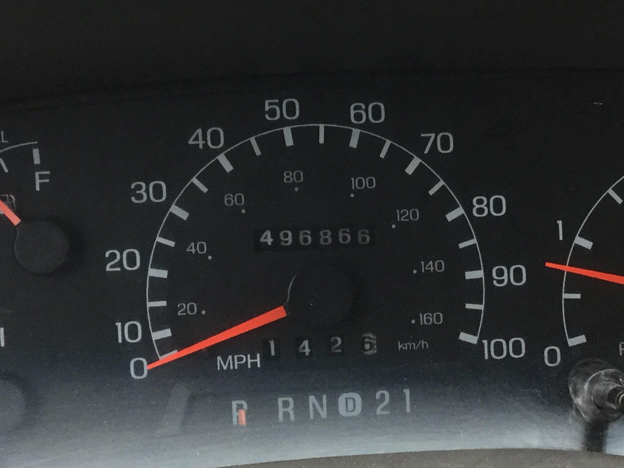

If it was take care of I wouldn't worry about anything.
I have owned this truck since sub 100k and have never had a valve cover off.
1 set of ball joints 270k, one transmission at 220K, transfer case at 330k, 2 water pumps, 3 HP power steering hoses, a carrier bearing at 340K and 2 alternators.
And of course routine tires, brakes and oil changes when necessary.
