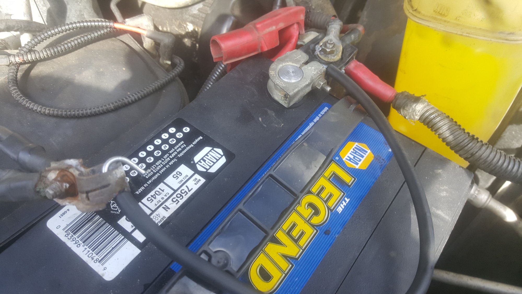

Reset the PCM. Disconnect the battery negative cable, and jump the negative cable to the positive.

Thanks. Would this video be accurate on resetting the PCM?
Bc it doesn't mention jumping the negative/positive?

Using the headlights is one common way people say to do it. One of the Ford techs said use a jumper on the wires. To me it makes sense to complete the main circuit by mimicking the battery being in place, instead of completing a sub-circuit through the headlights. Practical impact? Probably absolutely none after 15 minutes.
This will cost you the stored code, but you can't read it anyways. And if it's a real hard part problem the code will pop again.

I am trying the jumper method as we speak. I don't have the clips so am using a wire from my electric fence, hopefully it works the same?

I was able to reset it and took it for a drive to start to reprogram it. Everything seemed to be fine and the power had returned, however, at about 4 miles the truck overheated. I looked under the hood and noticed I forgot to put a clamp on one of the radiator hoses and the coolant had all leaked out as I was driving. I got a tow back to my home and will replace the coolant. My question is will I need to reset the PCM again because the overheat would have somehow mixed things up or just fill up the coolant and continue to drive it.
