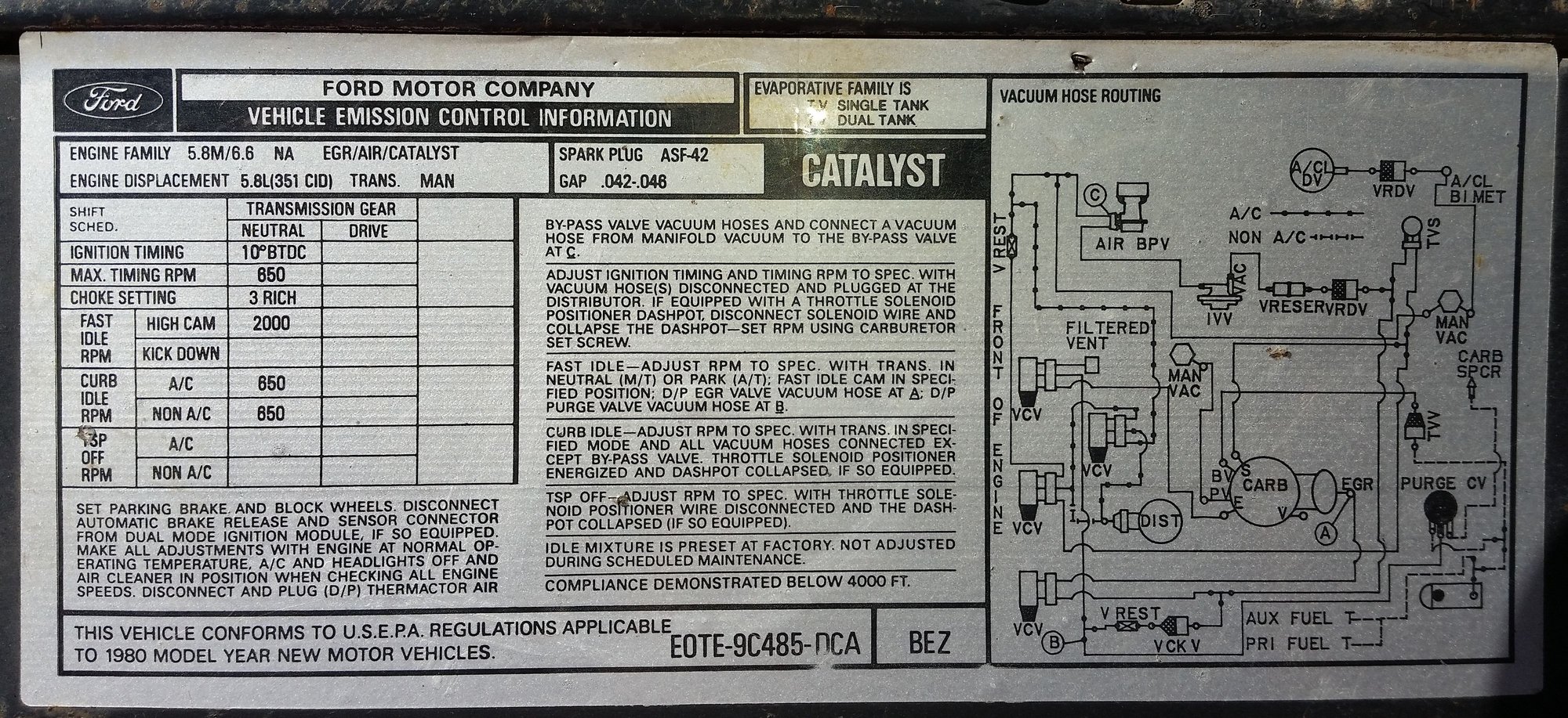

Turns out I have a 351, not 302, so slight delay while I returned the unopened 302/2150 carb rebuild kits and got the 351/2150. Got it rebuilt and mounted back on truck. It runs worse. It will start, but runs very rough maybe can keep it running at high rpm, but dies easily.
I think it may be vacuum after all, at least that needs to be right.
2 issues I am aware of after being under hood long enough to get carb off and back on:
1) I found an old hose I had not replaced that came off front of engine tree that was just loose. I capped that until I figure out where it goes.
2) I found another hose coming off block with screw in end of it. I doubt that is how it came from factory.
The diagram under hood:
and the hose plugged with bolt coming off block is running under fuel filter:
Can anyone tell me based on routing where this should be going?
Re #1 above. there are 3 trees at front of engine with vacuum lines. One tree has 3 connections, first appears to be plugged originally, the second runs eventually to the air cleaner, but stops at a green valve connected to 3 other hoses. and the third is the older hose that was hanging loose.
Old Nov 11, 2016 | 05:14 PM
FuzzFace2's Avatar
FuzzFace2
Posts: 30,940
Likes: 4,125
From: Angier, NC
How dirty was the inside of the carb?
How did you go about cleaning the carb?
After you rebuilt the carb how many turns out from lightly seated are the 2 idle mixing screws?
Was the choke on and was the fast idle cam working and the fast idle speed screw hitting the cam?
To check for vacuum leaks if you can keep it running start to cover the carb opening, "choke it off" and see if it idles better of RPM picks up.
If the motor will idle some what but ruff try carb cleaner around the base of the carb and where any vacuum hoses hook up to see if it changes how the motor runs.
FYI I had 1 carb (Holley 600)that would not idle and covering the carb would fix it. I rebuilt the carb and it still had an internal vacuum leak so I replaced it with a used Ebay one and the motor run great now.
Dave ----
edit: have you checked into the EGR valve not closing all the way? That will make it run ruff or not idle.
Old Nov 11, 2016 | 07:19 PM
jmcgee's Avatar
jmcgee
Joined: Jun 2007
Posts: 117
From: Fort Worth TX
Not that bad. The carb spacer had quite a bit of carbon build up. Took some work with a screwdriver to get it knocked down. The carb was soaked in Berryman for about 10 hours. Hosed off, used spray can carb cleaner to blow through all orifices, blew out with compressor.
right screw was at 2.5 turns, left was 2.25 turns. I looked at the cam but not really sure it was right. I know I didn't take any of that apart. I did remove the choke housing before soaking.
It won't idle long enough to do that test.
How do I test that?

Rebuild carb, replaced EGR valve, plugs, distributor cap, spark plug wires, fuel filter, replaced leaking fuel pump (about 6 months ago), . Checked and rechecked vacuum lines, stared at the chart under hood until I was dizzy.
This started after I rebuilt carb. So I removed carb (and made dry float adjustment that allowed it to start). Saw no other issues.
