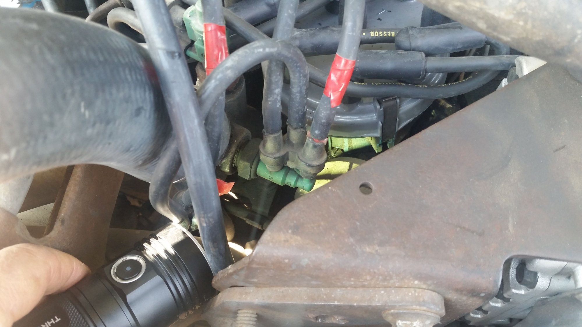

This is what I think is the screw to loosen so I can twist distributor. Is this the correct screw, it is right above the vacuum connection.

No, not that screw; you want the bolt that requires a half-inch wrench down where the distributor base meets up with the block, below the vacuum advance can but above the water pump/timing case cover.
Ok, thanks, found this one (circled). Even found a 1/2" wrench that would fit it behind the AC compressor bracket. Loosened it, but the distributor cap will not move. Is that the wrong bolt, or just needs encouragement or what?

Wrong bolt. You want the bolt right under the dist. It pushes down on a fork looking plate that holds the dist in place.
You also need to find the pointer on the timing cover. That is where you need to shine the light. You can't shine the timing light anywhere you please, you have to be looking at the pointer. I know, it's hard to see down in there but it is possible to do it.
