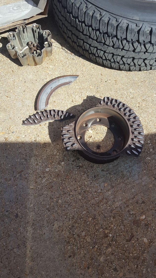

PROBLEM SOLVED! I had a bad hub on the front left, so while we were doing it I replaced the right hub as well....the brakes looked good as new so when I noticed that it was still making noise I replaced the front brakes as well ( thinking maybe there was a caliper sticking or something). WE WERE SO HYPER FOCUSED ON THE FRONT AREA THAT WE NEVER THOUGHT THE NOISE COULD BENCOMING FROM ANYWHERE ELSE... It sounded like it was from the same area on the front as the hub. Had a buddy drive it in the parking lot turning circles around me and braking.....it was the rear...ugh!
Here is the RIGHT rear rotor....yikes...we are idiots....guess that is what happens when you think you know it all and don't check everything else out as well...

Wore the back half of the rotor completely off...jeesh

That's a really strange thing to have happen, I've changed a lot of brakes and rotors over my 63 years but never have I ever seen anything like this happen. Just for my fellow Canadians and maybe for our American neighbours, I feel I get a more than fantastic deal on brake rotors and pads. Max Advanced Brakes - ELITE xDS Series Combo Brake Kit at Maxbrakes.com
