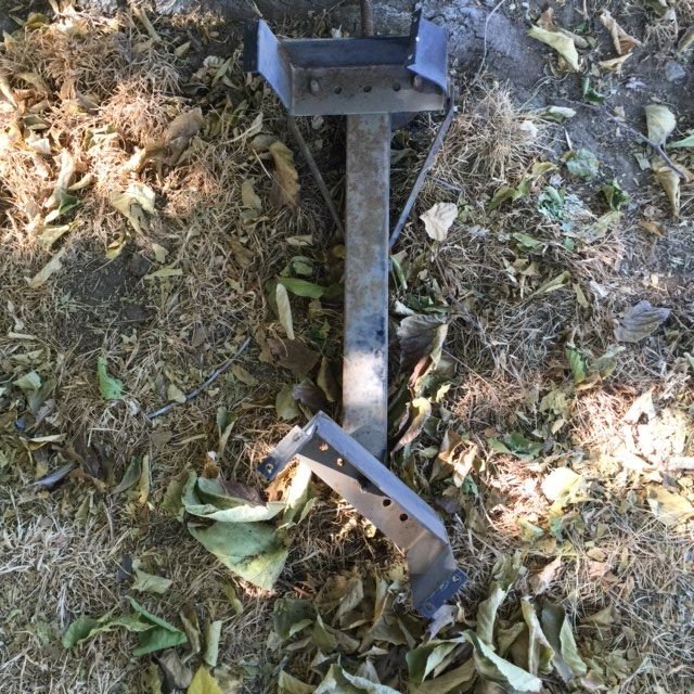

Here is the bent stabilizer. It has/had 8 bolts holding it to the floor

Interesting. Fleetwood was often unique in that they frequently installed components from companies that were only briefly in business. I hadn't seen that jack before.

The Caravan was mfd by Coleman, but they had a design flaw where the floor rotted from a leak, that sometimes waited til after the warranty period...which caused much consternation on the part of folks who bought this model used. They fixed it for 2004(our MY) but by then Fleetwood had bought out the Coleman "trailers" and such and discontinued this "lite" trailer line. Nothing changed but the name Fleetwood instead of Coleman.
