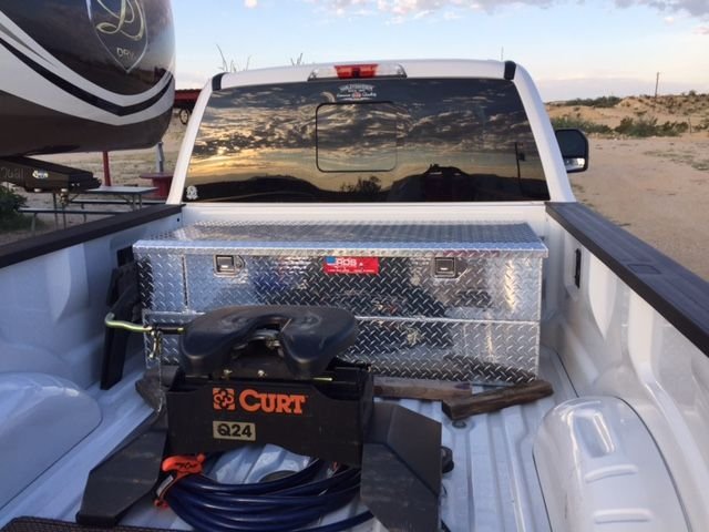

A couple of pictures of this tank installed. Because of the bed shape the fitting going to fuel system has to go down rather than out as in the past. I moved the tank 6" from the front to allow it to open once the BakFlip is installed.
The wider tanks will not fit the new bed.

Not sure how you live without a bed liner. My wife and I are fulltimers and I throw so much stuff back there my bed would be dead in a year. I like the RDS!! I had the 100 gallon with tool box version in my old dually. Are you doing gravity feed??

Yes gravity feed,,, when we are somewhere that I can schedule getting spray in bedliner it will be done...a couple of more weeks on the move yet.

I was thinking of doing a similar install. I am curious if you have had any issues? I heard post 2012 models don't work with gravity fed tanks. Also what made you decide on RDS?

This is my 3rd RDS and they have all been great tanks and well built. The gravity feed works great, had on my 15 with no problems, and is much easier to use than transfer tank, but only work on diesels.

I do most of my towing through the mountains and finding a station with diesel can be challenging at times. I agree 34 gallon is great to have, however I would love to not have to stop for fuel on my camping trips. The RDS looks like a great option, especially as I have a BAKflip MX4 coming. My major concern is the gravity feed, as I do regular trips over the boarder. Not sure if there is any legal issues with carrying that much fuel. The Titan 50 gallon tank replacement tank would be perfect, however I really doubt it will be possible on these trucks.

With the 48 that comes with mine and the 40 extra it give me about 700 mile range towing which is more than I will do in a day...really hate fueling with TH connected.
