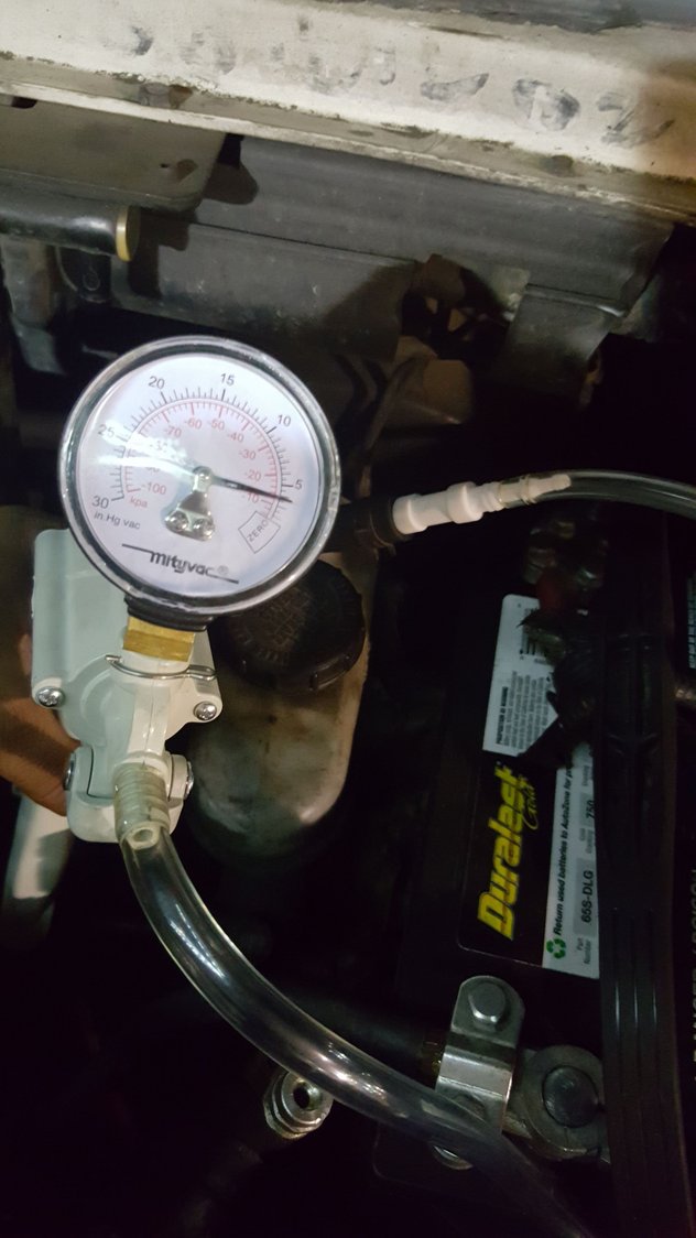

This is what my old pump was pulling:
Under 5psi. No good.
Make sure that the vacuum pump tester comes with this white piece. You will need it to adapt the clear tube to the vacuum line. Mine didn't have one so I went to autozone and purchased it for like $2.
