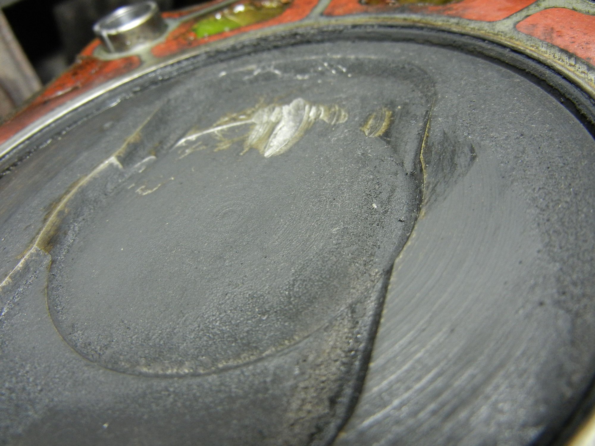

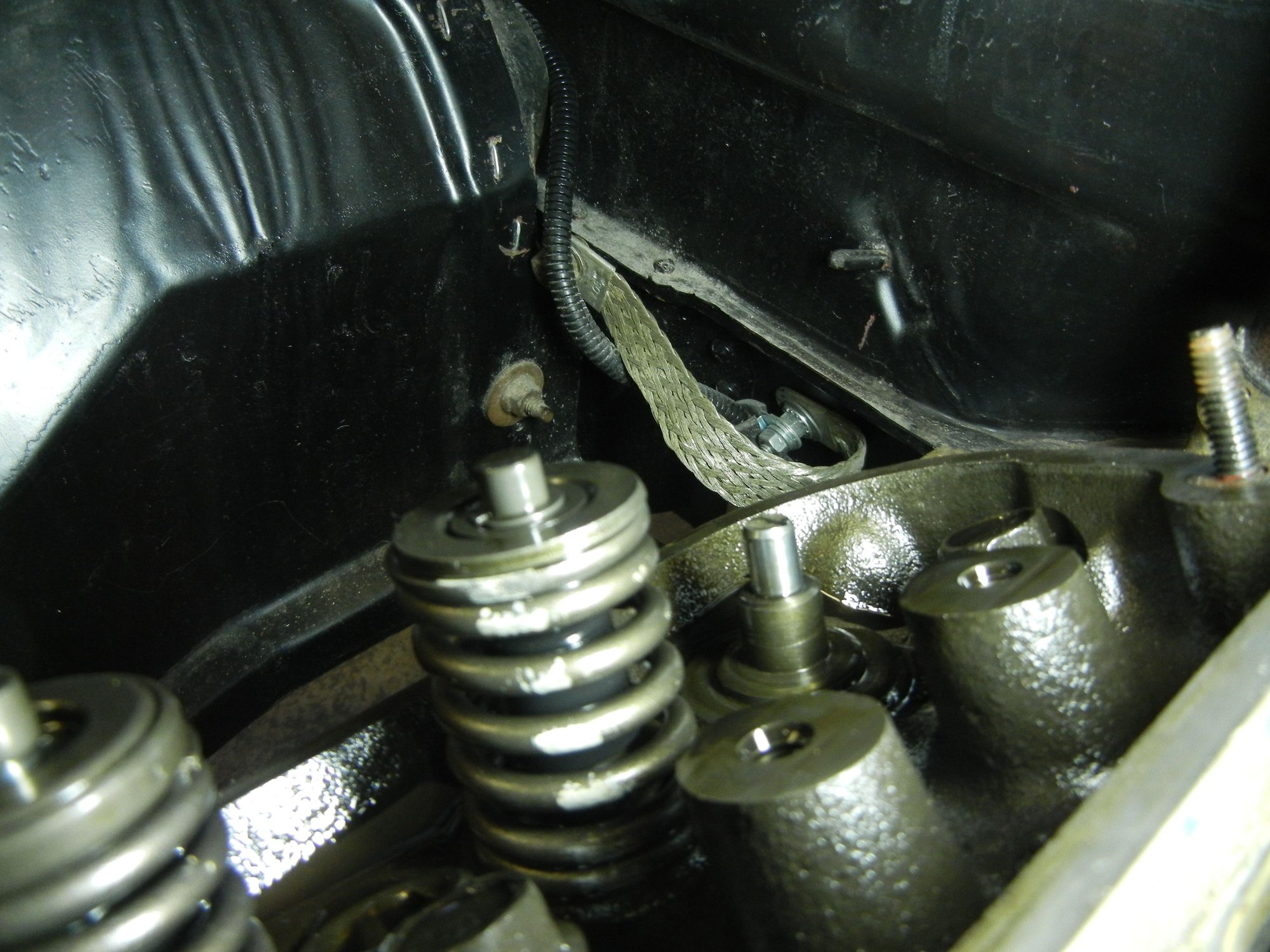

So I finally got my truck on the road once it came back from paint earlier this summer. It has a 79 351W that I was fortunate to get from a low mileage LTD. It's stock except for an Edelbrock Performer cam, intake, springs, lifters and timing chain and gears. I had a used Edelbrock 600cfm carb but all summer I tinkered with it and finally gave up and bought a new one a few weeks ago after I f^*ed the jets trying to get them out. Last week I was out for a spin pleased as a pooch with a bone. It was finally running GREAT. 3 blocks from home accelerating up a block long hill in 2nd... clink,clank, rattle, rattle and a total loss of power. I shut it down and got help to push it home. (Oh the shame!) Did a compression test and got 0 on #4. Pulled the valve cover and it looked fine. Blew some air down #4 and it came out the exhaust. ?valve? I pulled the head today. The valve snapped off 1/2" from the top. The valve head is bent over but not broken or chipped. Cylinder is fine. The piston has a couple of dents the deepest dent maybe 1/16" deep. I'm thinking I can get away with replacing the valve?

I would strongly consider doing a valve job, or at least have a shop check them all out. If you didn't replace the old valves when you upgraded the lifters & springs, then the valves are the weak link(s). Also for the cost of a stock piston(with standard sized rings), I'd replace that one. It will be the weak link and may go next. It's not too hard to fix it now.

Man I hate when that happens. I feel for you man. I have to agree with Gary. Be a real good idea to pull the piston and inspect the connecting rod and replace the piston. When that valve hit the piston something's got to give. I hope it all works out. You have a great truck.

Hmm, I've seen worse that did no damage to the lower end or the piston.
But replacing the piston do you need to replace the rings since any movement will cause them to loose their seated position.
So if you just hone the cylinder and call it good with old rings.?
Or replace with new rings an hone the cylinder?
Things to think about!
Cheap insurance is any engine with 75k is replace all exhaust valves with new ones since they get the hottest.
I will say you were very lucky not to suck a valve and destroy the head and piston.
Which is not a pretty sight, it gives ya a sick feeling deep in your gut & wallet.
If anything, I'd at least have all exh valves replace and do a 3 angle valve job

Is that piston destroyed? Maybe somebody sees something I don't see.
For a driver, a valve job alone might work. Seems to me.

like others said do a valve job while you have it apart .damage to piston is not bad .

I'm more cautious than most but once I fix something I never have to do it over. That divot in the piston may not look to bad but I'm also worried about the material under the divot. That metal has been stressed IMHO. You may get away with leaving the piston alone but I wouldn't. I'd buy a piston and some new rings for it. There wouldn't be any question marks in the bubble above my head. While you have that piston out check the rod. Make sure it isn't bent.
At a bare minimum I would take that head to a machine shop and have that valve guide replaced.
From here you have to figure out why this happened to that valve. If the reason is mechanical then handle that situation also before you start the engine back up. If you ran old gas that "can" tie up an intake valve in it's valve guide.

Had a similar problem with a carb screw falling down the carb when idling. Messed up the piston. Just a dent in the top under side and skirt broken. Should at least remove the piston to check it. Could have also damage the crank. I hope this is not the case here though.

How hard is it to pull or drop the pan to get to the #4 rod? If it's easy, I'd get a new piston and rings.
Not sure if a hone job is doable w/o dropping the pan totally. Maybe you can rig up a plastic bag under the cylinder when you hone? Just an idea, might be totally undoable.
I agree with the head job though. New guides, valves and a grind job minimum.

If you are going to drop the pan you will have to go all the way. If you pull #4 you will find the usual sloppy wrist pin. If one piston is out, pull them all. Hone, re-ring, oil pump, new shells on the rods. Maybe a total rebuilt.
Or, just a valve job.
That valve hung and snapped for a reason. The head shop will tell you why.
The OP said he has a 1/16 dimple in the piston. Do any of you old salts have a junk piston lying around to cut into to see how thick a piston top is?

John Since some piston are cut for valve relief and theres so the thickness may very on them. Or their may be a standard for all engine but would have to see a cut away of them all.

If you don't remove the piston and rod assembly at least spin the motor around check to make sure all 4 pistons on that side come up to the deck at the same height. Make sure #4 doesn't stay a bit lower from the deck. If it does you have a bent rod.
