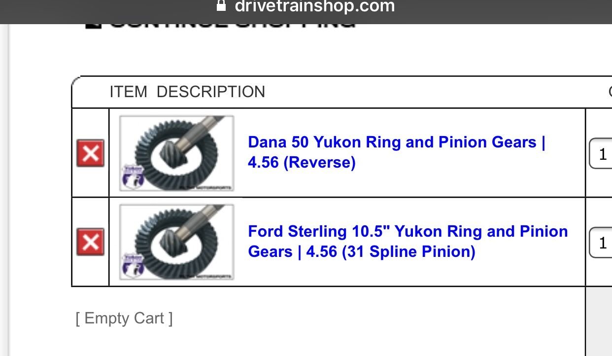

Thanks you WE3ZS! Any suggestions on where to purchase?

No, I don't have any experience with the different vendors or installation kits for the gears, I got very lucky and found a set of complete axles with my 4.88 gears already installed.
Be sure to run those gear choices past some of our more educated 7.3 guys before you commit to anything though, I'm a gas guy and the V-10 loves the deep gears, but it has almost twice the RPM range of the PSD. I just ran your tire size and ratios through an online calculator to come up with those effective ratio choices, I think I'm on the right track with them but make sure with a deezle dude first.
@Krazee Matt @Toreador_Diesel what say you gentlemen?

Yukon makes good stuff. It's more about quality and the price reflects it for gears, those're something I have never, ever, skimped on.
A first rate install shop is the second piece. Inexperience leads to bad things happening. Those bad things can happen at idles speeds, or they can happen at, oh, say... 65mph while you're towing your first Chevelle and the rear wheels suddenly decide they don't want to turn anymore. I owned that car all of 13 hours and it got totaled.
4.56 seems about on par to reach a desirable towing ratio with 37's as well as keep things happy turbo wise without too much gentle grade lugging and spiking EGT's. I haven't followed this whole thread, so I don't know if a tuner is already installed or not. A good one (cough, Gearhead, cough) plus gears will making towing a whole hell of a lot nicer one everything across the board. 6.0 cooler as well, blah blah blah.
Yes Mdavidson, both axles need to be regearedto the same ratio. You can do the rear first and then the front, but you will NOT be able to use 4wd until the axles have matching ratios. So if budget is a concern that's one way to space it out over some time. Just be damn sure 4wd is never engaged because things will bind and you'll start grenading parts real quick in potentially really expensive areas.
