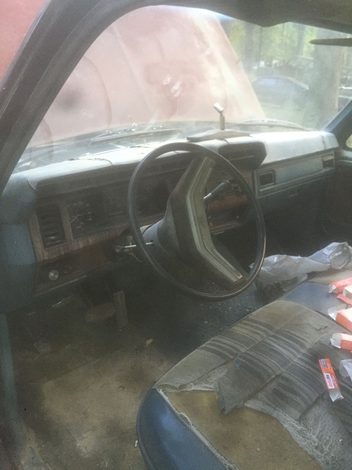

Cutting to the chase, I bought an 1984 Ford F-150 XLT GOLD with a red white and blue rainbow on the emblem. It has the 302 in it, which was seized but it didn't take much to free. My problem is that the accelerator pedal is stuck all the way down.
Here's what i know: the truck has been sitting for maybe two years, I haven't checked anything on the fuel system yet including pumps and lines, I have checked the cable and it doesn't seem to do anything. even with the gas pedal resting on the ground the carburetor flap is closed and the throttle is not engaged. When I try and pick the pedal up its very hard to lift and stops at a certain point due to some kind of stop behind the top of the pedal shaft above the pivot point. I'm not sure is the accelerator cable is hooked up properly on the throttle body due to lack of pictures on the internet lol or bad research!
Here is some imagery looking into the engine bay from the front of the truck there's the carburetor with the rectangle flap with rounded edges on the right side there's what looks like the accelerator cable with a spring on it and beside it there is maybe a brake cable with one of those chains that goes on the ceiling fans or dog tags lol beside the accelerator cable there's some kind so spring mechanism that i can move with my finger and a stop so when i pull it back and let it go the stop stops it. but it does nothing!! on the other side of the carb there's another spring mechanism that when i move it opens the flap on the carb also there's a plunger thing on the end of it going to some small cylinder thing looks like this {} it really kinda looks like that. but when i move the spring mechanism it seems like the plunger should retract but it does not and there's no cables or hoses coming from the cylinder {} thing so im not sure whats what! i have an 88 with a single barrel carb and the straight 6 and this 302 looks like a spaceship compared to it! but i hope all that helped. if you would like to answer that question you can stop reading here, im about to bore yall with more problems lol

See the piece he has in his hand? That just prys off with a screwdriver off the ball stud. Pry that off and it will separate the cable from the carb. Then see what happens.

Prying this off made my pedal come back up!! Woohoo, how do I get my pedal to stay up with it connected?
This fixed it but idk what to do next. How do I keep it hooked up while still having my gas pedal like it should

I figured it out! The flaps inside the carborator are rusted shut, I noticed that the throttle shaft wasn't moving so I decided to take the carborator off and see what's going on and it's soaking in carb cleaner right now and I have a rebuild kit ready to go on tomorrow. Thanks for the help everyone! I couldn't of done it without y'all! Any questions let me know!
