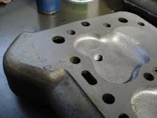

As far as heads, the 8BA heads are superior to the 8RT heads, marginally better compression ratio, better flow. Not that you'd really notice on a stock truck. Whatever you use, make sure they aren't cracked. You can also gauge how much they've been milled by looking at the underside, near the thermostat housing. As more and more gets milled to make them flat, the head gasket surface gets closer and closer to the thermostat housing, eventually cutting into it. Best not to mix a heavily shaved head with one that isn't.
