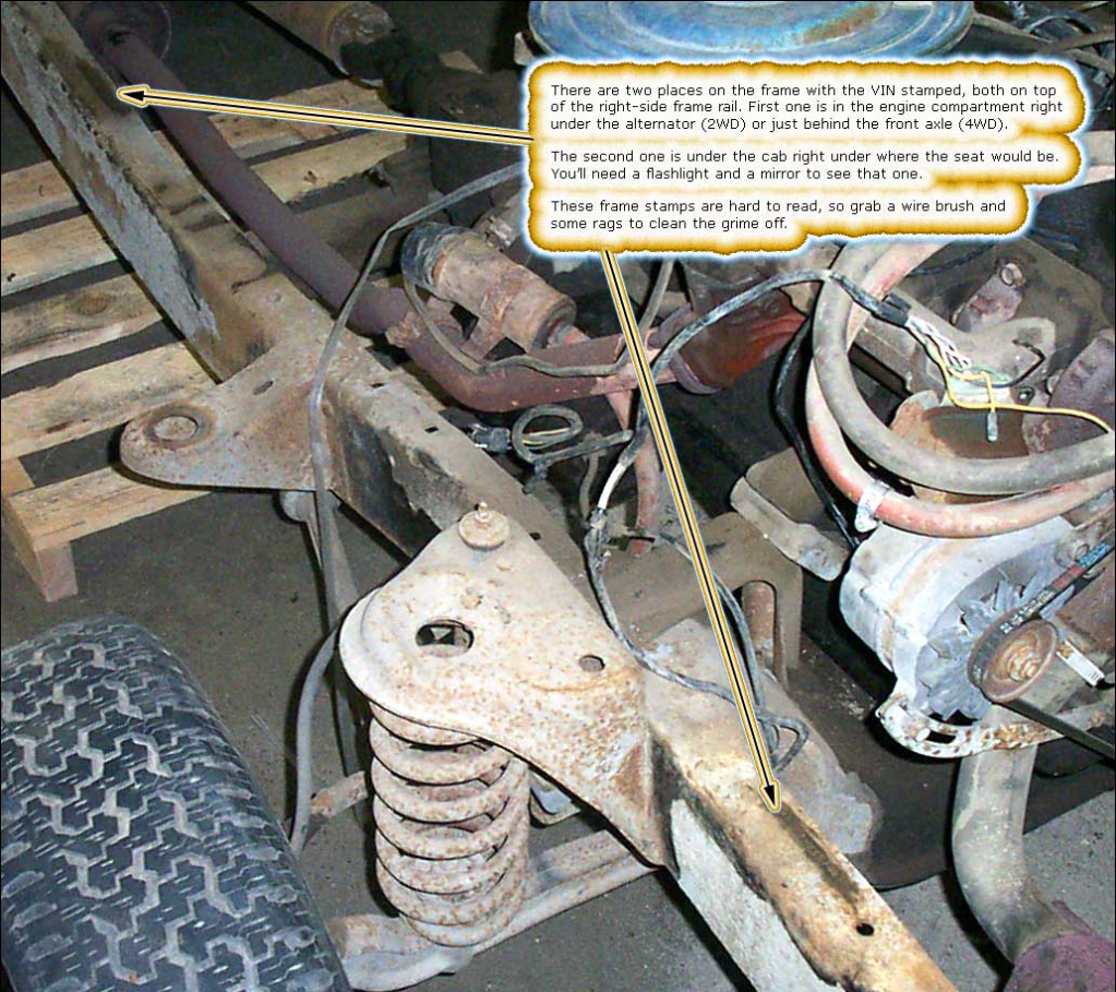

The frame VIN is stamped in two places on the frame. Both on the top of the rail, passenger side. The visible VIN is in the engine compartment, between the firewall and radiator support. The hidden VIN under the cab, usually about 10-12" behind the front cab mount.

On the four wheel drive, the VIN should be stamped on the right side (Passengers side), on top of the frame rail, between the alternator, and front axle area.
I went through this just about a year ago, trying to get Ka'Bluey registered here in North Carolina. You can probably clean that area up well enough to see the Vin, with sand paper. Unless you have a small grinder/drill with a wire wheel on it.

Not my picture but I keep it for reference:

No worries. Gotcha covered Unk Bob!
