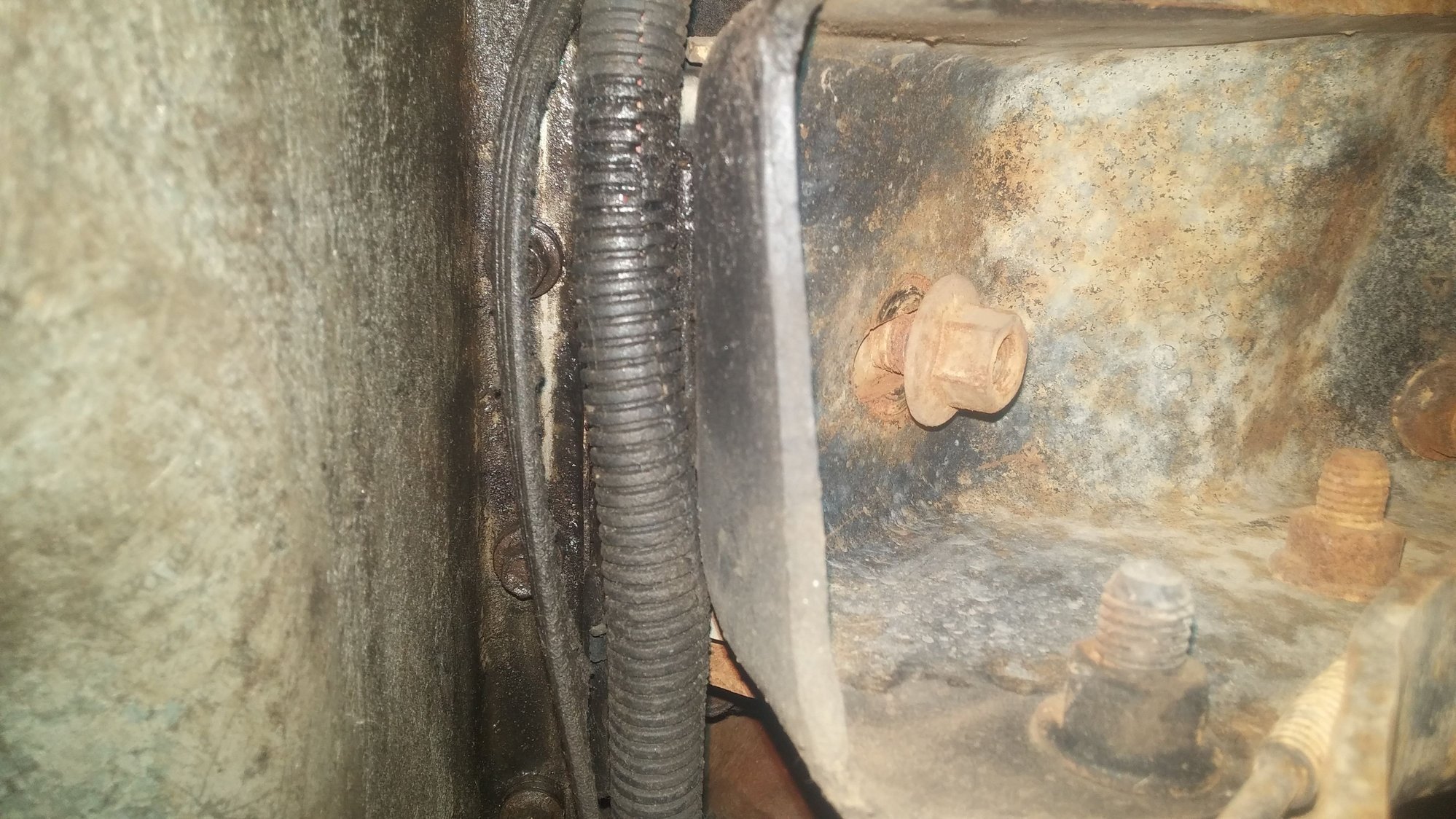

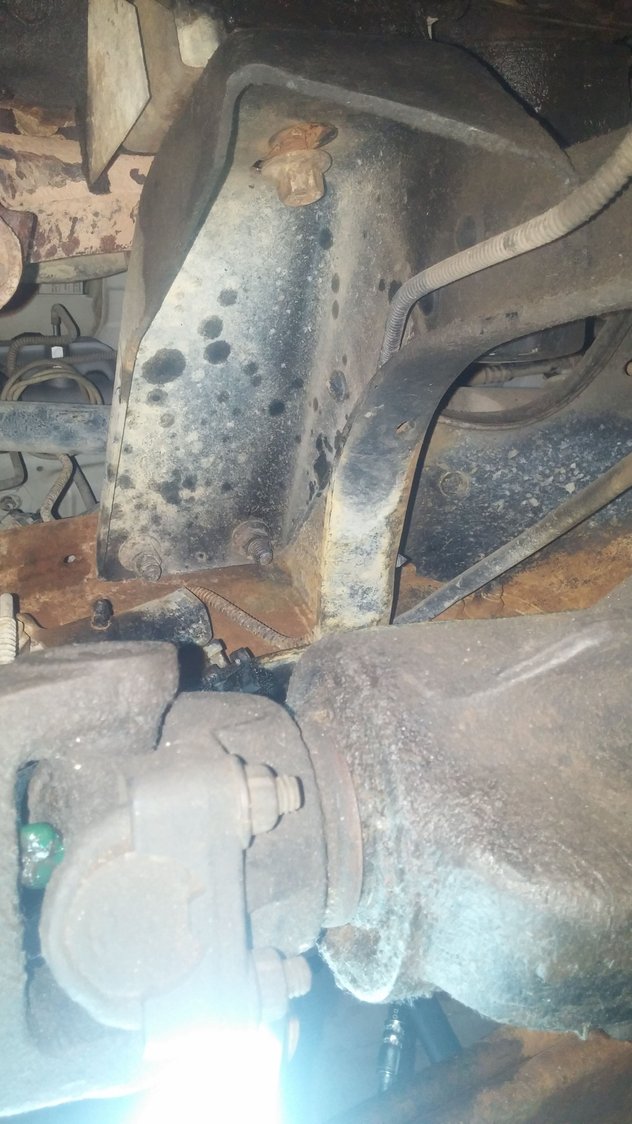

Hi everyone. When i was under the 1997 f250 HD. 5.8l i noticed this. On both sides there is a large gap between the threads and nuts. I didn't try to tighten them or anything. Is something missing or do i just need to tighten them down or leave them be?

Nope they should be tight spray down with your favorite lube Wd or PB blaster and toghten them up.

If you can get the nuts to turn, I'd back them all the way off and clean the threads with a wire-brush and then spray them down with something like PB Blaster as mentioned. I think just trying to send those nuts home with all that rust on the threads will just result in broken stuff.

Sounds like a plan. Thanks roboto65 and lead head
