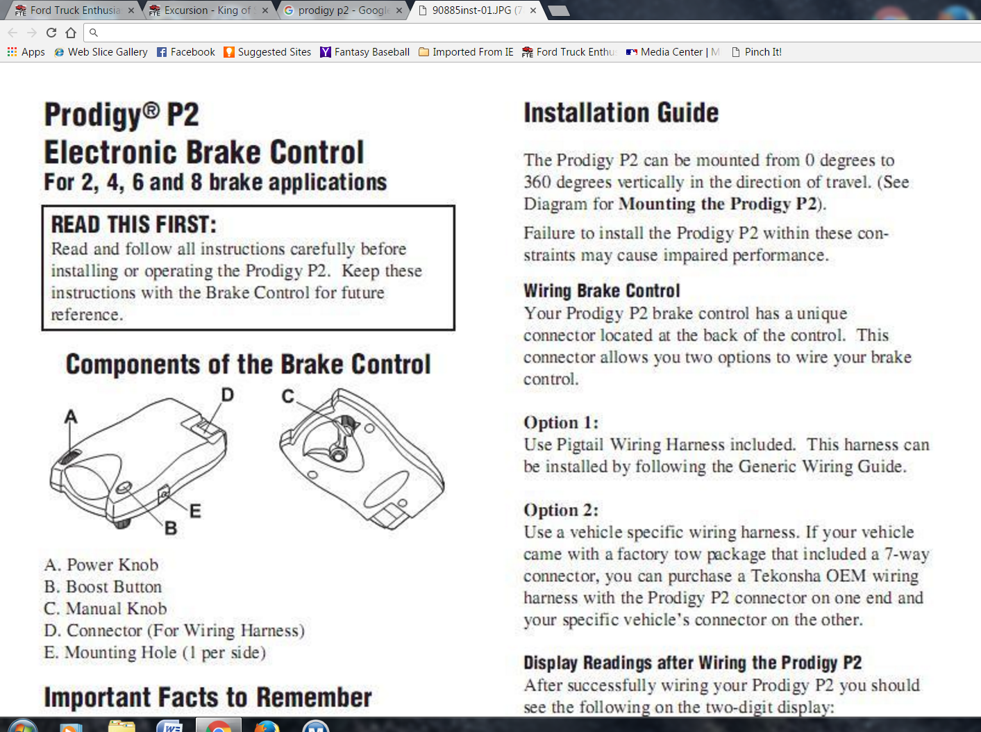

Originally Posted by CharlyG
Seems like they could mention that once or twice on their site.....
just sayin
They used to. It's even on their documentation:

I just checked out the Tekonsha web page and it looks like they still do call the Prodigy P2 the same name, but apparently for the newer P3 version Tekonsha dropped the "Prodigy" part. Us people (you know, Joe Public) probably got so used to calling it the Prodigy P2 that when the P3 came out, we just kep using the designation "Prodigy" even though Tekonsha dropped "Prodigy" from the P3 label.
