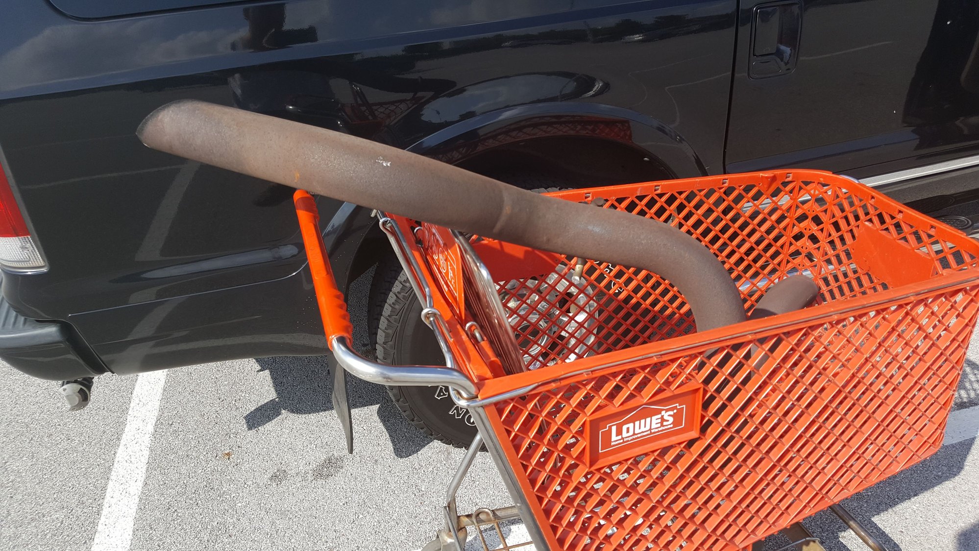

This is what I left in northern Indiana a few weeks ago. Had to cut the hanger, it just wouldn't budge at all.
So now I need a muffler and tail pipe. I found a walker SS muffler, but can't find a mandrel bend tail pipe. Not looking for noise, quiet is best for me.
Any thoughts?

I saw that, but definitely not mandrel bent on the pipe.

I seriously doubt you are going to notice the loss of 1/4hp.
I mean sure, get a mandrel bent one if that is what you want but it isn't going to make any noticeable difference in performance unless the rest of your exhaust system is already free flowing with headers and a well executed routing ( unlike the factory system )

If the mandrel bending is really your hangup. Just have a local shop crush bend you a 4 inch tailpipe and the lack of mandrels should be eliminated. Speaking of exhaust restrictions, have you replaced the Y pipe up front?
