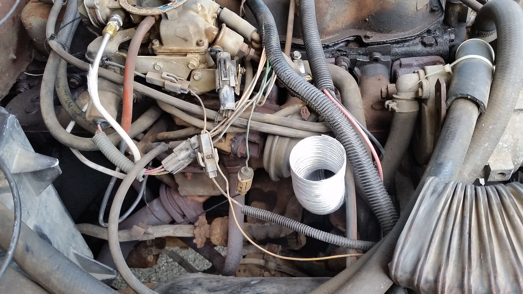

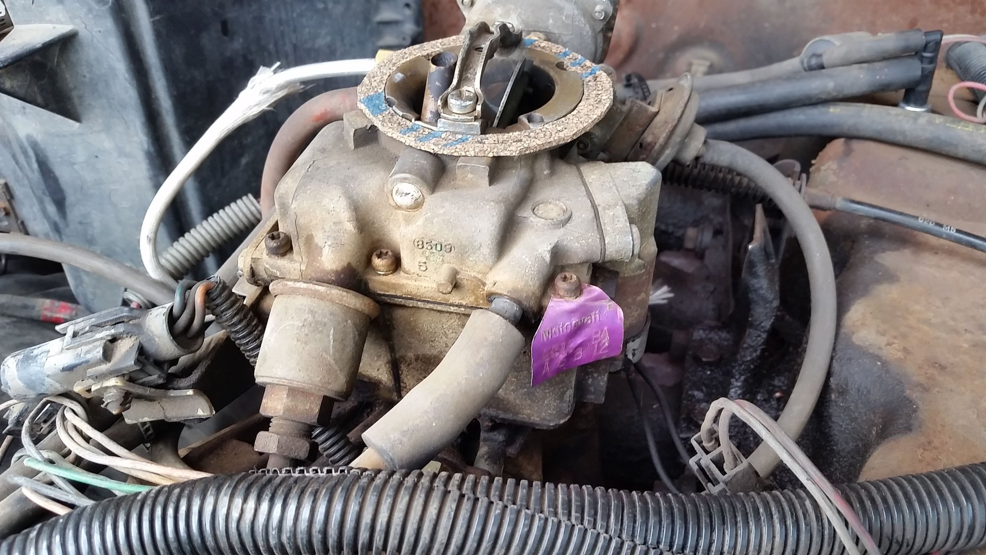

I think you should post pictures of what you have. It is VERY common for these trucks to have had the "emissions junk" removed by a previous owner. The EEC-IV controlled feedback carburetors are especially prone to this fate. If you do not have ALL of the original components in place, you will never get your truck to run correctly or pass emissions.

[QUOTE=LARIAT 85;16580927]I think you should post pictures of what you have. It is VERY common for these trucks to have had the "emissions junk" removed by a previous owner. The EEC-IV controlled feedback carburetors are especially prone to this fate. If you do not have ALL of the original components in place, you will never get your truck to run correctly or pass emissions.[/QUOTE
I hope these pictures will help determine if this original equipment. If you need different angles or other areas let me know. Thank you very much for your time and assistance.
